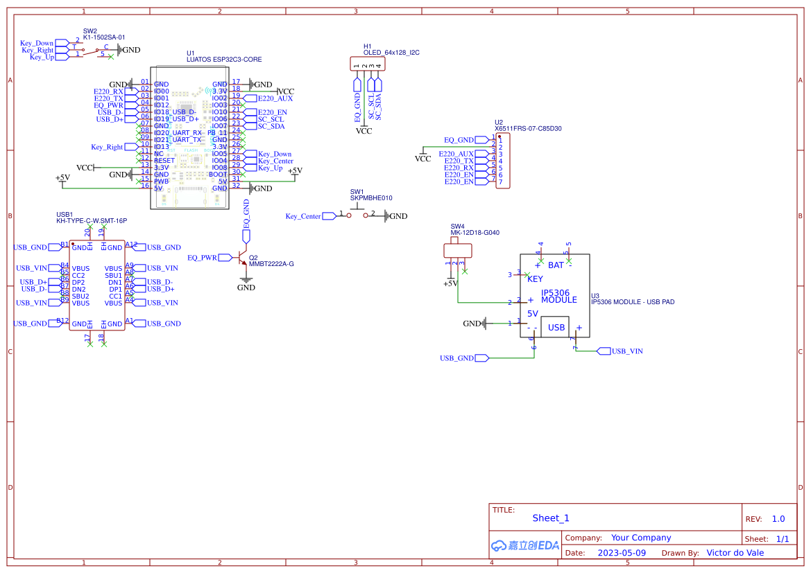

This is the "Final" (at least ... the latest / workable / usable version).
For cost savings, this is a "hybrid" version: not a full on-pcb component board.
The PCB from this project allows to easily put together the needed modules :
- LuatOS ESP32-C3
- E220-400T22D (or ... any other 7 pin lora EBYTE module ...)
- Whatever power / BMS Module you prefer : LX-LCBSD, J5019 ... must accept 5V input (USB), manage battery and deliver 5V output
- 4 pin I2C OLED screen
