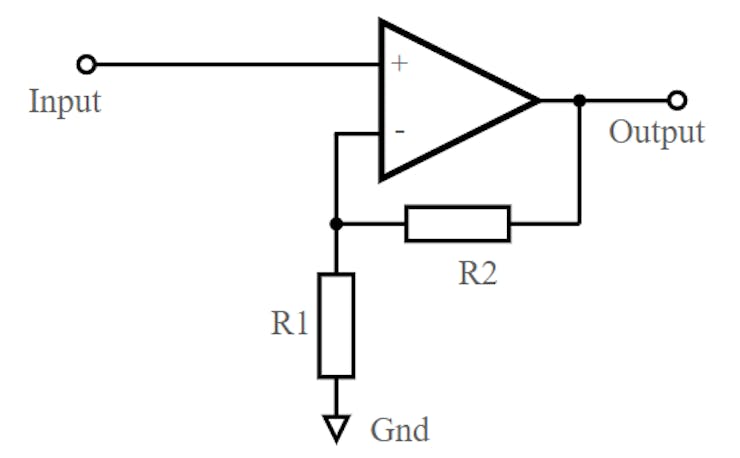

Amplification:
Because 10milli volt per ampere is very low, I want to measure a maximum of 5ampere. In this case only 50milli-volt fulfill the needs. It is easy for us to calculate but microcontrollers would not give any output change on this small voltage change.
So, we need a proper amplifier to amplify the signal, so that we can display values using Arduino microcontroller. We have to go with instrumentation amplifier for better precision and accuracy but operational amplifier may do the fine job. Here, I will use LM358 operational amplifier in non-inverting configuration mode. The gain of amplifier is multiplied by the signal and then give an output.
Keep in mind, Arduino ADC can work at a maximum of 5volt, we also have to measure 5 amperes at max. So, we can increase the amplification factor 1v per ampere. Which not only gives the better precision but also, we can measure the current directly using any voltmeter.
Amplification factor calculations:
Initially we are getting 10mV for 1ampere, to amplify the voltage to 1 volt we need a 100x gain. The non-inverting configuration gain is given by 1+Rf/Rin.
R2= 99k, R1=1k gives the gain of 100. But here we are using 100k resistor with 1k resistor which is the general value and gives a gain of 101 == 100. Which is almost equal, in the Arduino code we can do some changes to get the better accuracy. Keep the reference level in mind while working with operational amplifiers.

Pin 3 of the IC is the input which is also pulled down with 10k resistor to match the reference level. 100k, 1k resistor to proving a gain of 100 to the system, the output of op-amp is given to the analog input of Arduino to measure the voltage in terms of current and then to display the output.

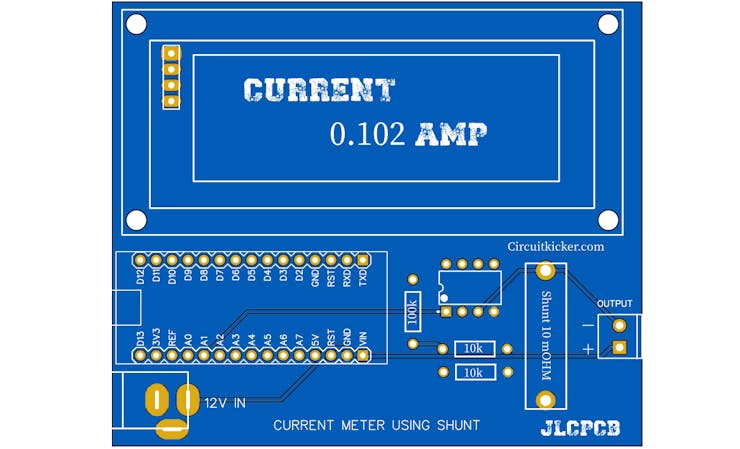

PCB files:
I had given 2 PCB files one for the dedicated ampere meter and other one is for current sensor. So, either you can measure using Arduino and I2C display with dedicated current meter or can measure using voltmeter from current sensor.
Ampere meter:
Current sensor:
The current meter configuration can be changed as per given resistance on the back silk layer of the PCB. If you want to make the same files as mine then get them from here. This project is sponsored by JLCPCB, 5 pcs 2layer PCB in just $2. Sign-up now using this link and get new user coupons of $54.

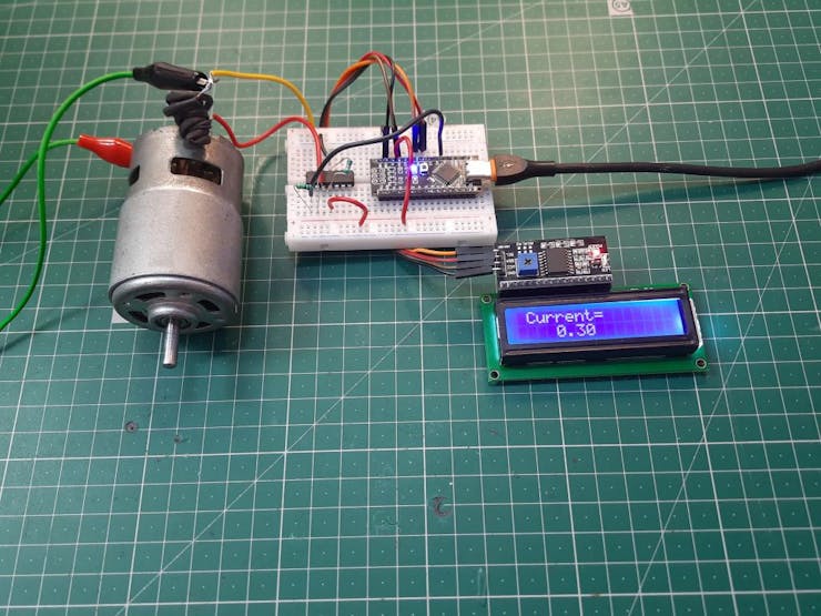

// current meter // We has 10mv per amp shunt amplified to 500mv per amp by OP-amp non-inverting confg. Rf=49, Rin= 1k // Now 0.5v= 1A,so we changed the output as current/2, which gives 0.5v as 0.5amp // Resolution #include <Wire.h> #include <LiquidCrystal_I2C.h> int analogPin=1; float current = 0; LiquidCrystal_I2C lcd(0x27,16,2); // set the LCD address to 0x27 for a 16 chars and 2 line display void setup() { lcd.init(); // initialize the lcd lcd.init(); // Print a message to the LCD. lcd.backlight(); } void loop() { float c= analogRead(analogPin); current= c/1023*5.0; if (current<0.5) { lcd.setCursor(1,0); lcd.print("Current="); lcd.setCursor(4,1); lcd.print(current*1.1); delay(500); } else{ lcd.setCursor(1,0); lcd.print("Current="); lcd.setCursor(4,1); lcd.print(current); delay(500); } }
Working:
In the code at low ampere the output is not stable that why I introduce the IF statement below 0.5ampere and then you can change the output factor to calibrate your sensor.
Mine one is working fine after calibration and now I can use this as a display or modify the code to make power meter. Stay tuned for the other version of the current meters. I take electro noobs video of current meter as reference but there are some mistakes. After realizing and wasting my time with that one I am representing this in front of you. So, that you may get a basic idea to current measurement.
