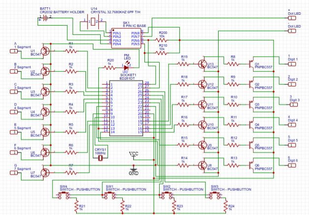

Arduino 6 digit 7 segment display clock
STDArduino 6 digit 7 segment display clock
186
Creation time:2024-12-21 14:39:29Update time:2024-12-22 13:38:00
1. LED ( I used 148pcs )
2. Atmega8a/Atmega328p microcontroller
2. DS1307 RTC IC
3. 13 Pcs NPN Transistor ( I used BC547 )
4. 6Pcs PNP Transistor ( I used BC557/558)
5. 23Pcs 1k resistor
6. 2PCs 10k resistor
7. 2Pcs 470 Ohm Resistor
8. 4 Pcs Button switch
9. CR2032 Battery
10. CR2032 Battery Holder
11. 28 Pin IC Base
12. 8 Pin IC Base
13. 32.768 Khz Crystal
14. 16 Mhz Crystal
15. Some Wire
RTClib.zip
3
2
_12_24_HR_clock with RTC module (1).ino
3
