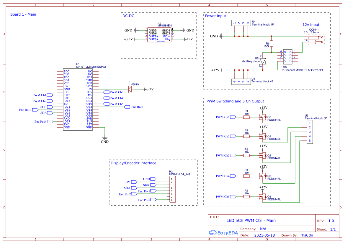

5 channel PWM Controller for LED strip lights
Design Goals:
  • Basic 5 channel LED controller using PWM
  • Online control using BLE/WiFi (ESP32 - MH-ET Live Mini)
  • Optional physical controls using OLED and a rotary encoder
  • Protection from reverse polarity of the input (I'm a little unsure on this)
  • Protection from backfeeding the DC-DC converter when flashing software on ESP32.
