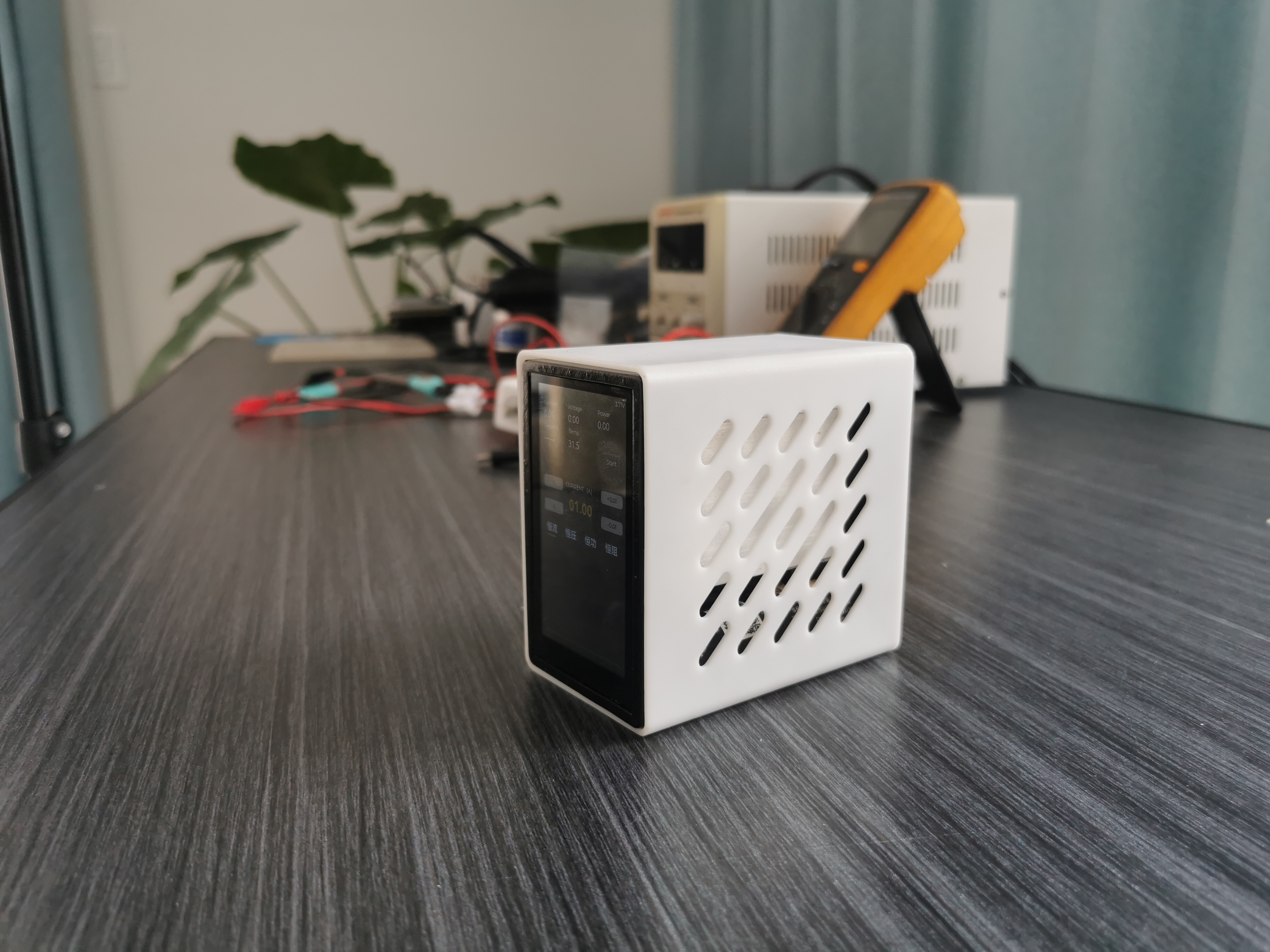

This is a black edge full screen CNC electronic loadmeter, the shell is resin 3D printed, the whole size is 54x88x84mm. Because the shape is similar to a computer mainframe, I named it Xiao Shou1, abbreviated XS1. XS1 provides a typec port for communication as well as power supply (5V2A power supply is recommended), and also has a built-in 18650 power battery, while power supply is prioritized to use external power. The screen is a 3" 480x854 high resolution capacitive touchscreen.
Note:this project does not focus on cost-effective, mainly for learning and research. Compared with the same type of electronic load, the cost is about 50 dollars more, mainly touch screen cost.

Dimensions: 54x88x84mm (WxLxH)
Interaction:3" 480x854 TFT screen, capacitive touch, 2 light touch switches
Power supply: typec interface 5V, built-in 18650 battery
Load interfaces:typec port, xt30 port
Sampling range: voltage 0-60V, current 0-4A
Load capacity:constant current 0-4A, error <0.04A | constant voltage 0-48V, error <0.2V | constant resistance 1-1000R, error <5%, constant power 0-100W, error <5%
Carrying power: long time running 30W, short time running 100W (10S)
Protection mode: over-current protection, over-voltage protection, over-temperature protection, reverse connection protection

Put the keycaps into the inner case first, then fix the heat sink to the MOS tubes on the power board (the heat sink is pre-punched), and add heat-conducting pads between the heat sink and the MOS tubes.I use ceramic chips, which cost a little more.Note that the NTC resistor on the power board is going to touch the heat sink and can be coated with thermally conductive silicone grease.The two boards are connected by rows of pins and fixed to the inner case. Then the fan is placed in the corresponding position and fixed by inserting screws from the back. Finally the LCD screen is glued into the slot on the front of the inner case, and the fpc wires are connected to the core board from the bottom gap. Finally put on the shell, there is loose to fix the bottom with screws, need 2.5 screws.
4.Functions
It is mainly used as an electronic load, or can be inserted into the sd card to play music and pictures, built-in battery and clock chip can also be used as a desktop clock ornament.

Connect the measured power supply through TypeC port or XT30, XT30 is 4-wire measurement mode. For power supply, it can be powered by usb or internal battery, press the power on button on the back to turn on the device, the screen will display the logo and enter into the main interface, select the corresponding mode and set value, press the start button. Press the shutdown button on the back to pop up the shutdown dialog box, you can choose to cancel or shutdown button.
Test video wiring is as follows, the test is a regulated power supply, in order to more accurately display the current, test constant current constant resistance constant power mode will be a multimeter selected to the DC current gear series into the circuit.Constant voltage mode is mainly used to test the load carrying capability of current source type power supplies or power supplies with current limiting protection (the power supply is in the maximum current output state, equivalent to a current source).I strung an armored resistor for current limiting to keep the power supply from burning out.Multimeter selected to the DC voltage block, note that previously measured the current to connect the pen back to the voltage connector.
Please see the attached video for specific use,
