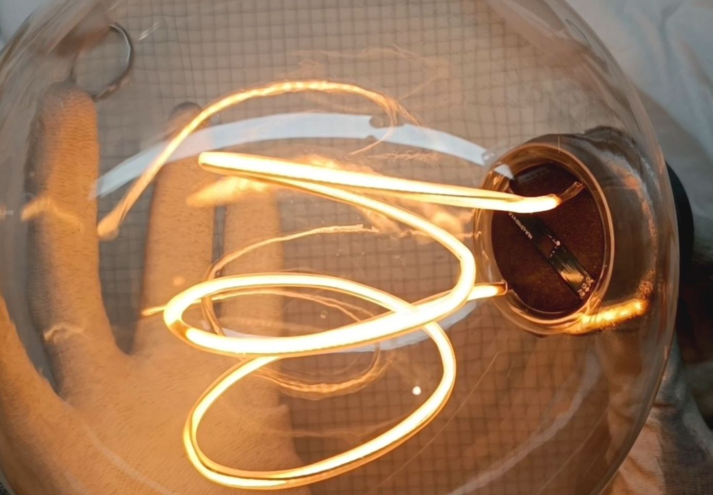

In February of this year, I played a game called OneShot, in which Niko, the main character, is holding a large light bulb, and I was fascinated by it. So I decided to utilize my spare time to create a light bulb similar to the one in the game. After months of searching and testing, I finally came up with a bulb that I want. I hope this big light bulb can bring joy and surprise to everyone.
Application Scenario: home lighting, crafts.
Functions: touch/proximity (light bulb) sensing, touch (light tail) infinitely dimmable, Type-C charging.

2. Make Filament: the required materials are flexible LED filament, heat shrink tubing, stainless steel wire, enameled wire, dimethyl silicone oil. The right figure for the LED filament and enameled wire welding, filament connected in parallel. The pins can be positive or negative, and are connected the same way in the end anyway.
Dimethicone is used for lubrication when sleeving heat shrink tubing. As for what to do with the sleeve, you have to figure it out yourself. Heat shrink tubing set of filament, heat shrink at both ends on the line, do not need to be heated as a whole, because this may lead to later filament damage chances.
3. Radar module and line welding: as shown in the figure, the ZH1.5mm-5pin line pin welding to the radar module, the radar module is too long, you need to cut short half of the part, without affecting the welding of the module on both sides of the PCB board minus.
   Radar module on the silkscreen definition: V for VCC, G for GND, O for OUT, RB1 for RX, RB0 for TX.
4. Assembly: Put the radar module on the filament fixing piece and use the hot melt glue to fix it, wait for the hot melt glue to solidify. Pass the semi-finished filament through the filament fixing piece. Then use pliers to bend the steel wire of the semi-finished filament to increase the contact area of the hot melt adhesive. Then apply the hot melt adhesive to the wire and the filament holder. Wait for the hot melt adhesive to solidify, and then use the soldering iron to solder the enameled wire in the filament and the ZH1.5mm-2pin wire, pay attention to the soldering should be 3V power supply to test the positive and negative poles of the filament.
5. Connect the accessories to the motherboard and test
6. After testing that there are no missing functions and hardware, stuff the filament into the bulb and fine-tune the filament shape with your fingers. Caution! This process will be difficult and easy to damage the filament!
7. Put hot melt glue on the back of the motherboard, and fix the motherboard and the shell together while the hot melt glue is not solidified.  Stick copper foil on the inner wall of the lamp housing, and then solder the TCH pin wires in the motherboard to the copper foil.
8. Connect the accessories, screw the shell to avoid wires on the internal threads, it is recommended to use tape to tie all the wires together, before screwing, you also need to rotate in the opposite direction for a week, so that you can avoid wires screwed more than one circle resulting in circuit breakage.
