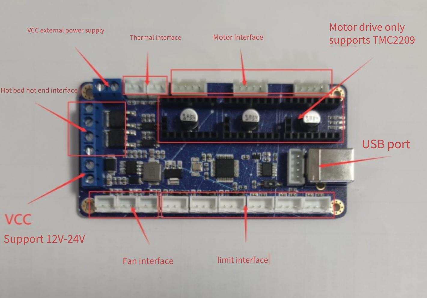

Specially designed for voron0.2, it needs to be used with a tool head.
Supports three-way driver module. Because it is specially designed for voron0.2, it only supports TMC2209 driver. The jumper selection of the driver is removed. It has two high-power MOS control interfaces, two thermal interfaces and three controllable fans on board. The six-way multi-function interface can support limit, consumable detection, steering gear, etc. The USB-A interface or XH2.54 terminal can be used to connect to the host computer.
The power supply part supports 24V input. There is a DCDC circuit on the board to convert 5V and 3.3V power supplies. There are also three power supply indicator lights on the board.
Only supports Klipper systems.
The actual picture is as follows:
The control board interface is shown in the figure below:
Note: Please see the schematic diagram for the interface pins.
