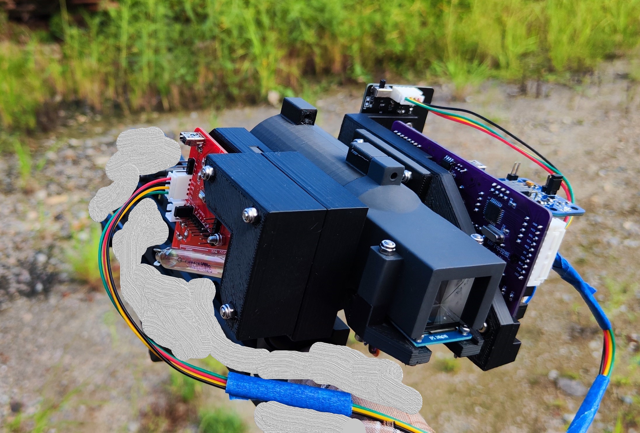

System physical diagram

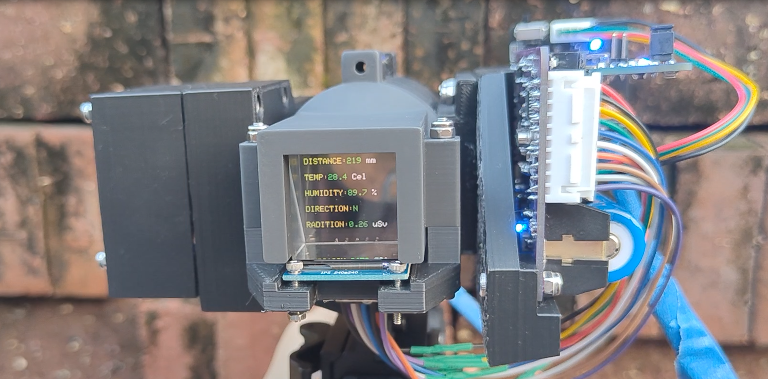

HUD display renderings of environmental parameters

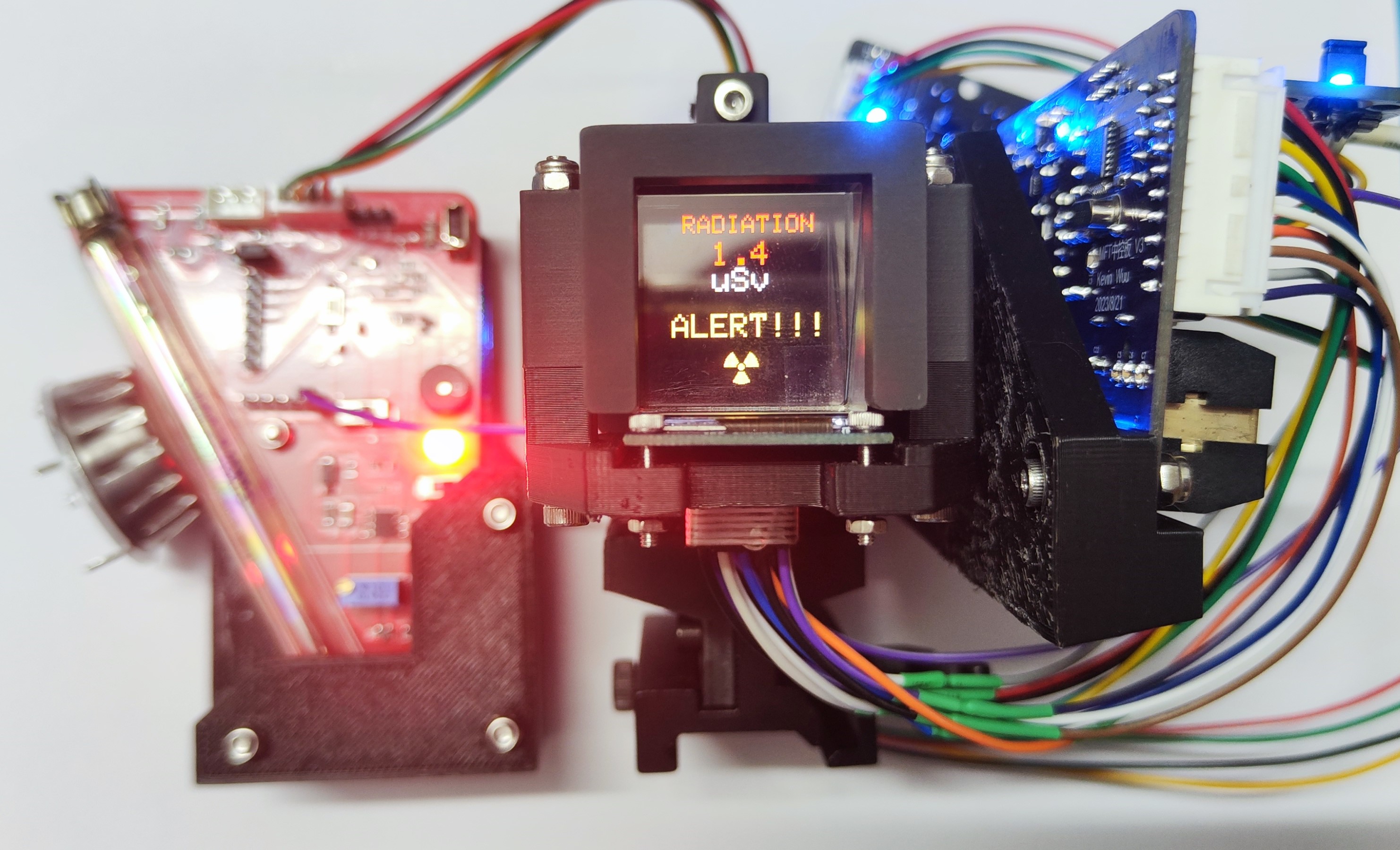

Geiger counter module alarm renderings

Project Description
Purpose Try making a multi-functional observer with a heads-up display (HUD).
Implemented functionality It has the functions of short-distance ranging, temperature and humidity measurement, and compass orientation prompts, and the above parameters can be projected onto the HUD; it has a remote video transmission function; it has a Geiger counter module to realize radiation exceeding the standard alarm.
Use It meets the needs of travel enthusiasts to perceive the environment when exploring outdoors, rescue teams to search and rescue in the wild, and fishermen to grasp the environmental situation; in addition, with the addition of a Picatinny bracket, it can be installed on the WARGAME device (the baseline is too high, so it can be used as a peripheral).
Significance Through visualization, environmental parameters are placed in front of users, allowing users to perceive the environment more intuitively.
Physical production status Most of the sensor modules have passed the verification. There are bugs in the ESP32 CAM split screen part (low display frame rate, stripes and freezes)

1) Measure the ambient temperature, humidity, and orientation information and project them onto the HUD;
2) It can measure the distance of objects at close range (within 2 meters) and project the distance information onto the HUD;
3) Using ESP32 CAM, it can be turned into a remote monitor;
4) Through the additional Geiger counter, the radiation monitoring function is realized, providing the radiation index of the surrounding environment, and there is a screen projection alarm function when the radiation exceeds the standard.

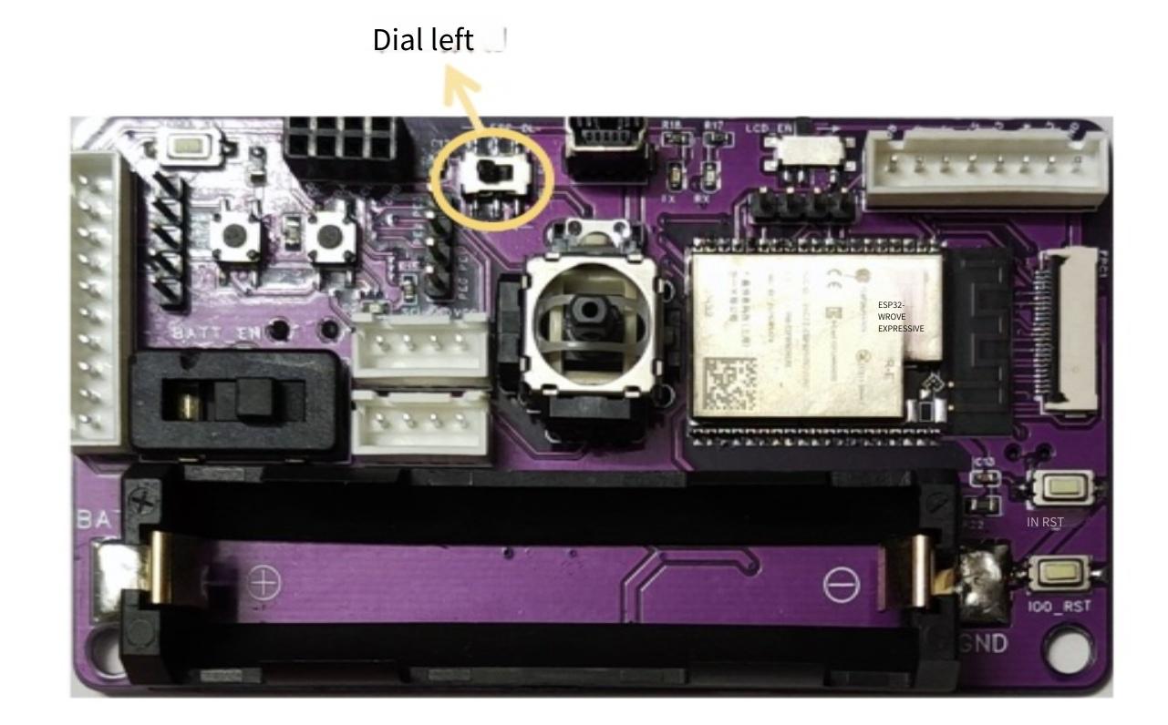

Center console Collect and process sensor data and drive TFT display; the board is also equipped with an ESP32 CAM module, which is responsible for image return

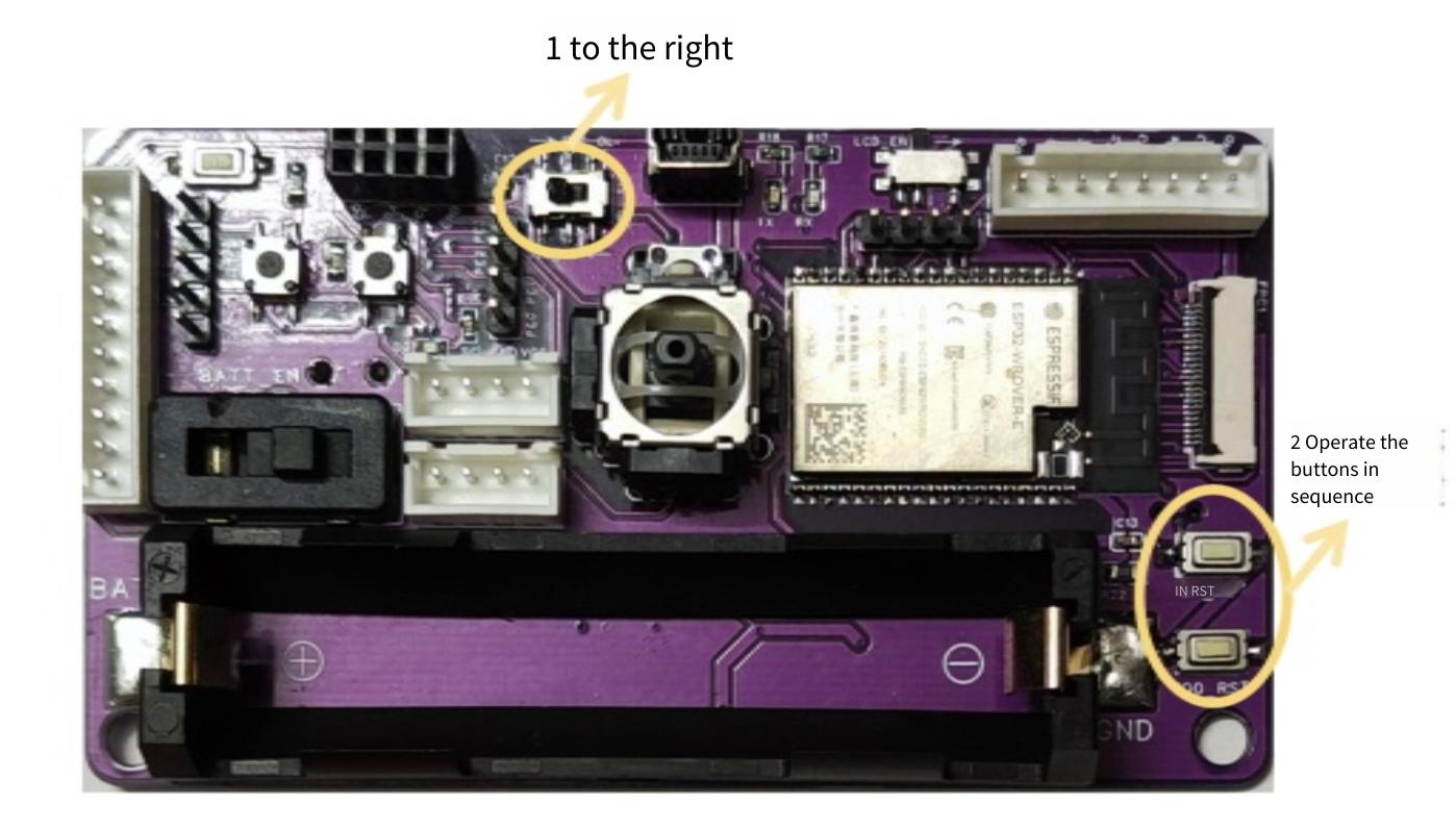

Program Part
Burn the DEMO program to AT MEGA328PB, and burn the CAM routine that comes with the IDE into ESP32.
As shown in the figure below, when burning 328PB, turn the burning switch to the left to enter the 328PB burning mode.
As shown in the picture below, when burning ESP32, turn the burning switch to the right, then press and hold the EN_RST and IN0_RST keys at the same time, first release the EN_RST key, and finally release the IN0_RST key to enter the ESP32 burning mode.

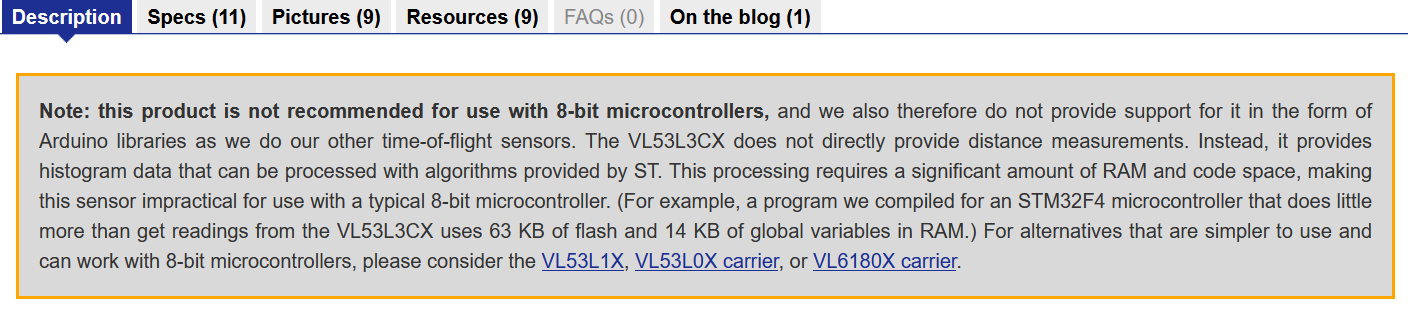

1) When debugging the ranging module, the data cannot be read and there is a problem with the program. There are basically no VL53L3X programs on the market that are adapted to 8-bit microcontrollers (basically they are adapted to STM32). I went outside to check and found that none of the open source experts have implemented an adaptation program.
(Picture source POLOLU official website)
You can only replace the VL53L0X . The pins of these two modules are pin to pin, so there is no need to re-print the board. After verification, the board can be replaced with VL53L0X, and the ranging effect is good.
