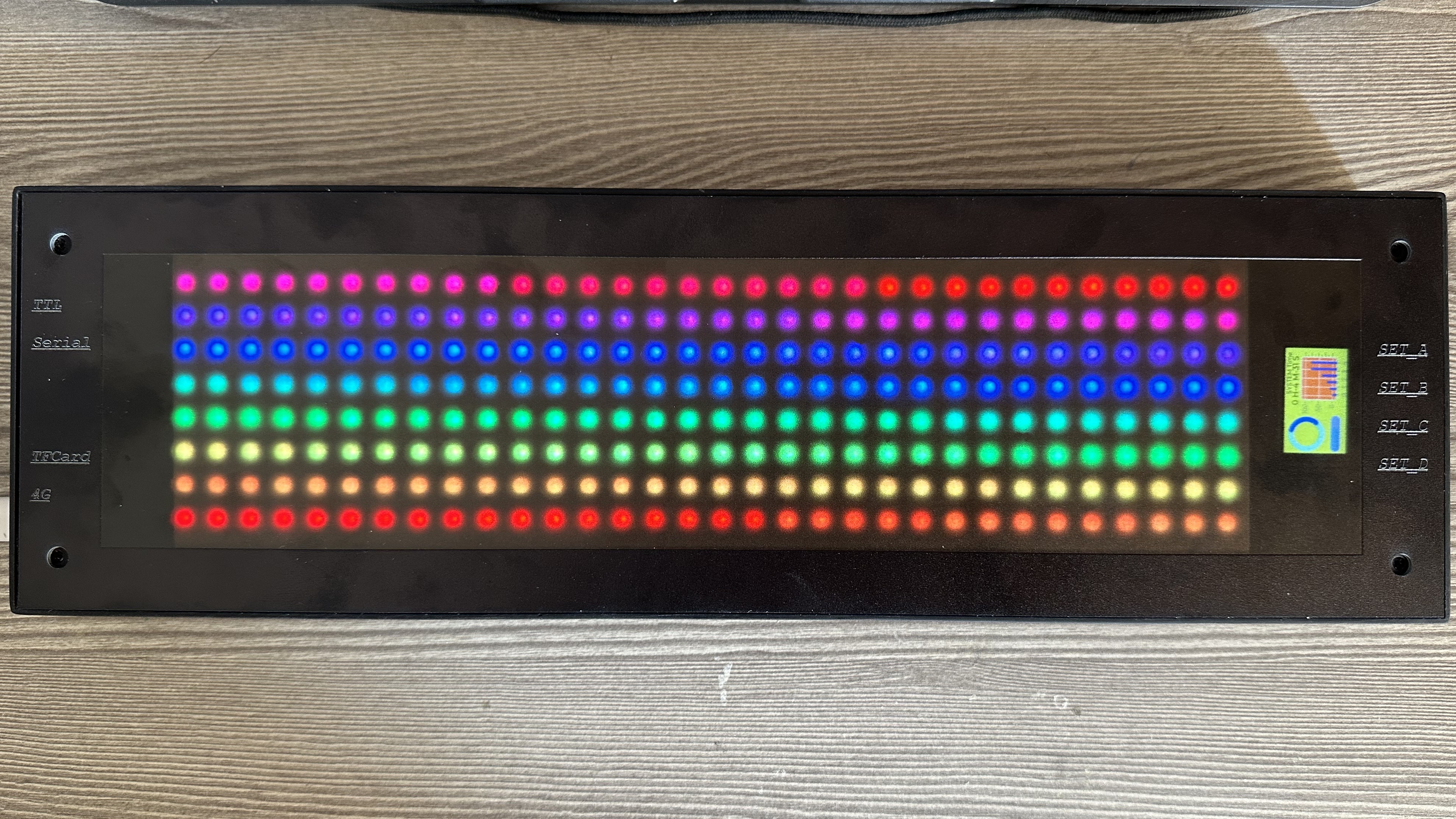

Physical Display
3D rendering
Back plate (don’t ask me why the process side is not removed)
背板
Display board, the one on the right is the 1.14' small screen (too small
显示板
RGB disorder verification
RGB_Test
RGB + LVGL
RGB & LVGL_Test
The effect after integration is completed:
Boot page
All lamp beads light up
Gradient tone display
Rainbow transition hue display
Random lamp bead gradient display
Temperature display
Left icon + clock display
Right icon + clock display
clock display
night clock display
Secondary screen bar graph display
Secondary screen system status display
Secondary screen calendar display
Weather status display on secondary screen
