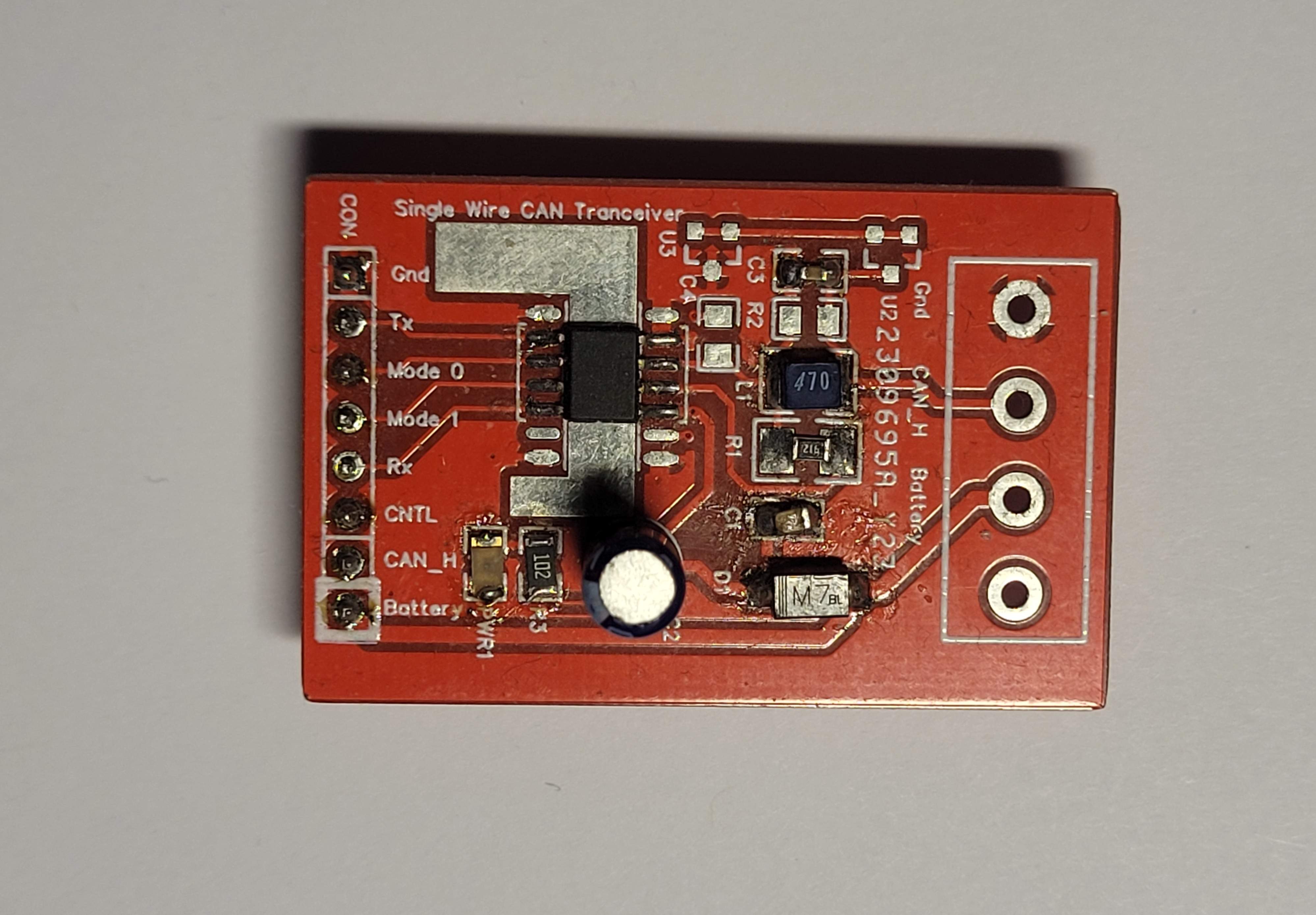

Interface board for Single Wire CAN bus in many car manufactureres most communly used in GM cars and in a lot of Japanese namely Hondas.
It runs at a very low rate of anywhere from 33k to 50k
ID | Name | Designator | Footprint | Quantity |
1 | 100nF | C_1 | C0805 | 1 |
2 | 10uF | C_2 | CAP-TH_BD5.0-P2.00-D0.8-FD | 1 |
3 | 100pF | C_3,C_4 | C0805 | 2 |
4 | 1N4007M7 | D_1 | SMA(DO-214AC) | 1 |
5 | 47uH | L1 | L1210 | 1 |
6 | 6.5k | R_1 | 0805 | 1 |
7 | 1k | R_2 | 0805 | 1 |
8 | NCV7356D2R2G | U1 | SOIC-14_L8.7-W3.9-P1.27-LS6.0-BL | 1 |
9 | MMBZ27VCLT1G | U2 | SOT23-3 | 1 |
10 | NUP1105LT3G | U3 | SOT23-3 | 1 |
