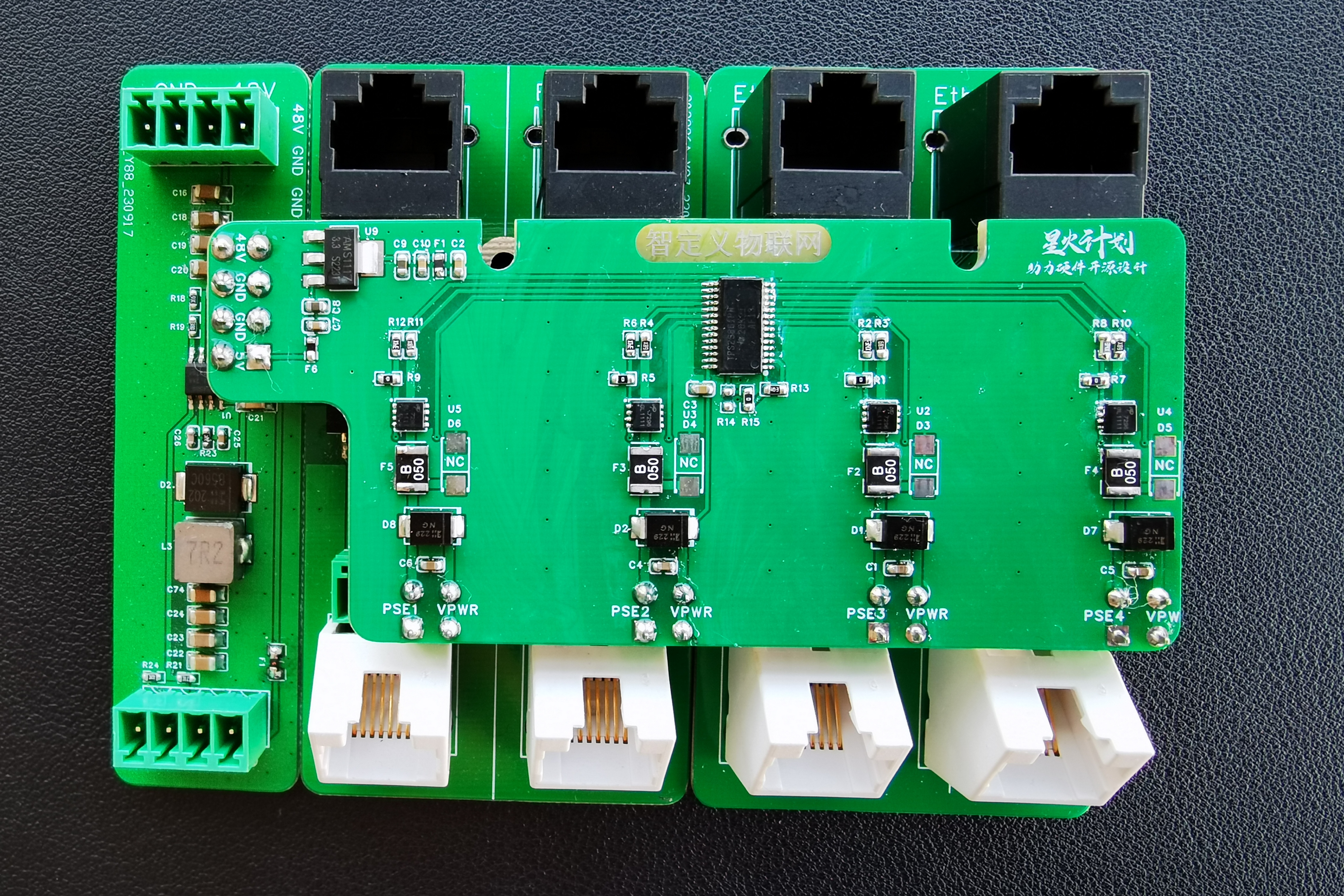

Module ④: TPS23861 PSE control module

(1) PSE power supply module
①POE power supply detection circuit
TPS23861 determines whether to power the device by detecting the current condition of the power supply port. Among them, the three pins GATE, DRAIN, and SEN are used to control the on-off status of the circuit. The SEN pin is used to detect the current status. GATE is used to control the on-off characteristics of the external high-power MOS tube. DRAIN is used to provide the basic drain. Voltage. When the PD device is not connected, GATE realizes the on-off power supply of external devices by turning on and off MOS tubes. When the load does not meet the requirements, the basic current detected by SEN is very small, and GATE will not be in the normally open state at this time. , and when there is a load, the current flowing back into SEN will be very large. At this time, the chip detects the current that meets the requirements and keeps the GATE gate in a long-open state, thus realizing the detection circuit for power supply of POE equipment.
②PoE power supply negotiation process
After the PSE device is powered on and the PD device is connected to the PSE device through the network, the PSE and PD begin power supply negotiation:
Detecting PD: PSE periodically outputs a small voltage with limited current at the port to detect the presence of PD equipment. If a resistor with a specific resistance value is detected, it means that the cable terminal is connected to a powered end device that supports the IEEE 802.3af standard or the IEEE 802.3at standard (a specific resistor with a resistance value between 19kΩ and 26.5kΩ, and the usual small voltage is 2.7V~ 10.1V, detection period is 2 seconds).
Power supply capability negotiation (PD device classification process): PSE classifies PDs and negotiates power supply power. The power supply capability negotiation can not only be realized by analyzing the resistance sent by the PSE and PD, but also through the link layer discovery protocol LLDP (Link Layer Discovery Protocol) protocol to discover and notify the power supply capability for negotiation.
Start power supply: During the startup period (generally less than 15μs), the PSE device starts to supply power to the PD device from low voltage until it provides 48V DC voltage.
Normal power supply: After the voltage reaches 48V, the PSE provides a stable and reliable 48V DC power to the PD device, and the power consumption of the PD device does not exceed the maximum output power of the PSE.
Power outage: During the power supply process, the PSE will continuously monitor the PD current input. When the PD current consumption drops below the minimum value, or the current surges, such as unplugging the device or encountering a PD device power consumption overload, short circuit, or exceeding the power supply load of the PSE, etc. , the PSE will disconnect power and repeat the detection process.
