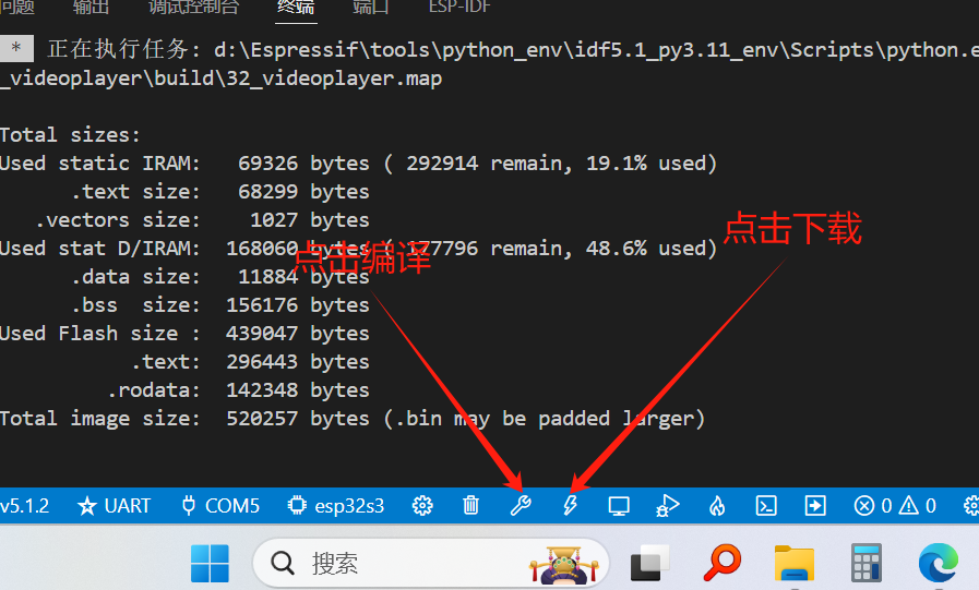

Program download: In this project, the ESP32 board is directly connected to the USB, without any burner, and there is no need for the onboard serial port, and the USB can be directly used to burn.
USB download circuit
USB download process:
After confirming that there is no problem with the soldering, open the downloader on the computer where ESP-IDF is installed, I am using VSCode in this case.
Select a device:
After compilation, click to download directly:
Programming completed:

Compile and burn the program, copy the SD card root directory file to the SD card (directly to the root directory), insert the SD card, and boot the computer.
When executed for the first time, the program will automatically download the font, the font is located in SD:/SYSTEM/FONT, and the program will start to execute after the font is successfully updated.
