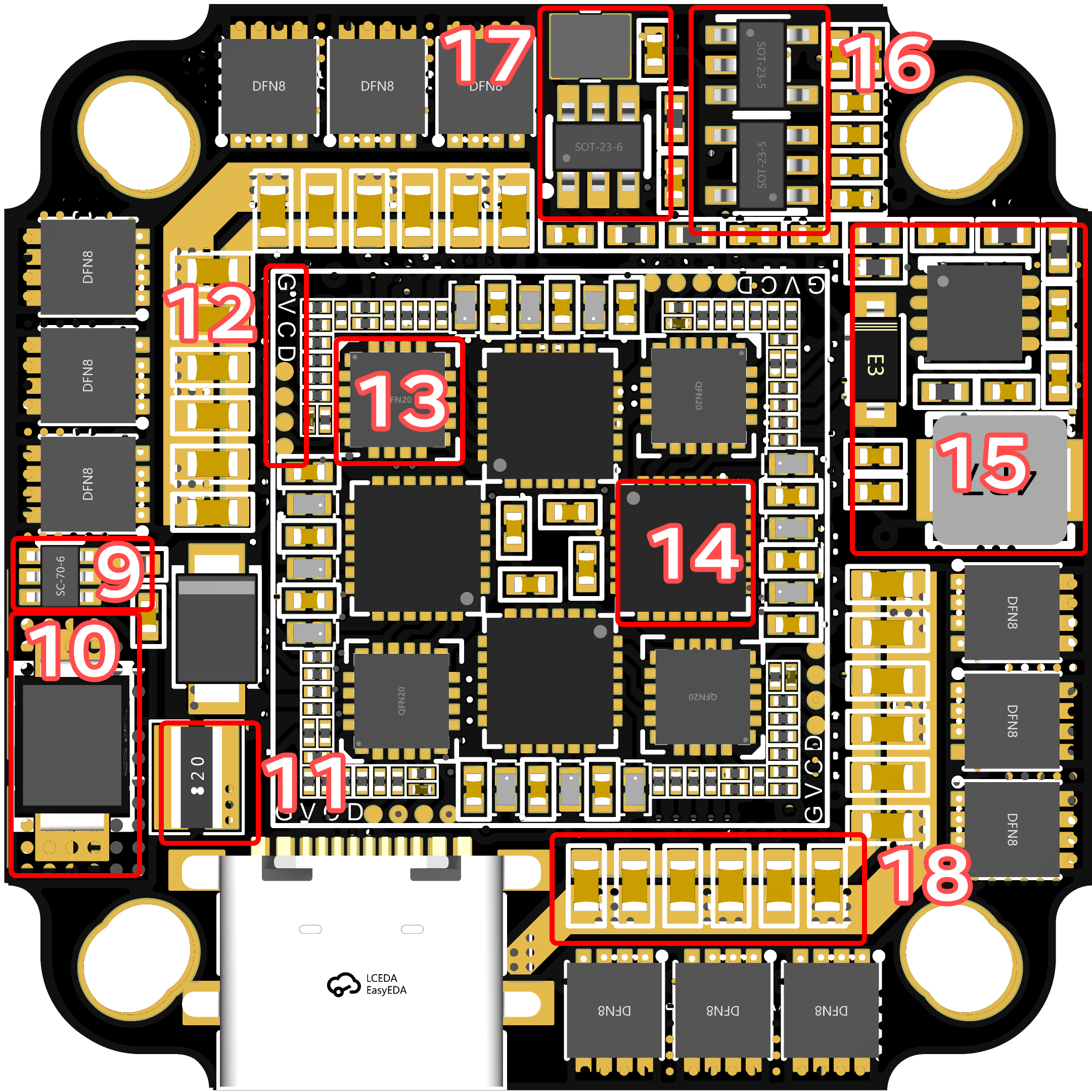

The following picture is an old board. Don't change it to a new one...
N-channel MOS tube (DFN-8 3*3 or DFN-8 3.3*3.3)
STM32F411 main controller
BMP280 barometer
HMC5883L magnetometer
BOOT button
ICM-42688 gyroscope
W25Q18JVPIQ flash memory chip
AT7456E character overlay chip
INA199A current meter
KSMBJ30CA TVS transient diode
0612 alloy sampling resistor
4P*0.8mm spacing solder joints for firmware burning, recommended burning probe
EFM8BB21F16G electric motor controller
FD6288Q gate driver 5V DCDC
3.3V LDO 8V DCDC
Notes:
This project has 0201 chip resistor, which is difficult to weld by hand. In addition, the ESC burn-in point is very small, so it is recommended to use a burn-in probe for more convenience. It is easy to tear off the pad by soldering the wire yourself. After the welding is completed, the 3 pads of the 4 groups of motors are tested with a multimeter. It is normal for the resistance value between the two to be around 21K.

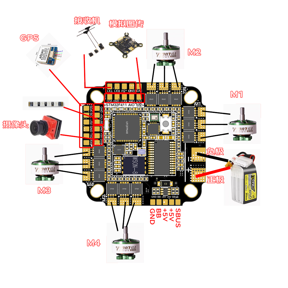

Wiring instructions
Designed by ZERO_Zhang (from OSHWHub)
