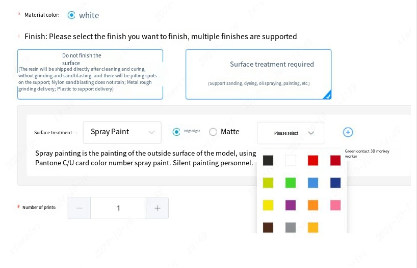

I used the spray painting service of 3D Monkey and the effect was great. I strongly recommend bright colors and varnish on the surface. It feels good to the touch. Let’s take a look at some pictures of the assembly.

For the panel printing part, a frame has been provided. It is recommended to use frosted acrylic, 1mm, with adhesive backing. Change it to your favorite picture for printing.
3D Printing
It is recommended to use black printing for the pressure plate .stl file in the 3D printing .zip in the attachment. The other files can be printed according to your own preferences.
Among them, 3D Monkey LEDO 6060 resin supports spray painting service, and it is recommended to use glossy surface.
