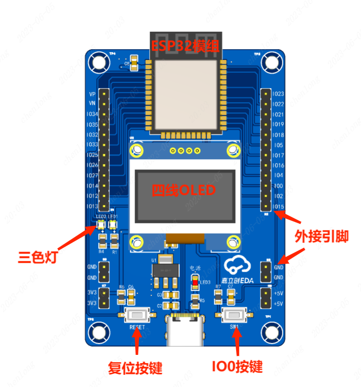

ESP32-WROOM-32E-N8 is a module designed by Espressif Systems in China, according to which the smallest system board is designed, all IO pins are drawn, OLED displays, buttons and three-color lamp peripherals are added, and C/C++/MicoPython can be used for development, which is convenient for quick development and learning, compact and exquisite, and has complete functions.
Fig.1-1 3D model of ESP32 minimum system board
1.1. Pin distribution
Fig.1-2 Pinout diagram of the ESP32 minimum system board
1.2. Onboard resources
Fig.1-3 ESP32 minimum system onboard resources
  • Main control chip: ESP32-WROOM-32E-N8 module
  • Power interface: TYPE-C
  • Function buttons: reset button and BooT button
  • Display function: power indicator display, two three-color light display, four-wire OLED screen display
  • Debugging interface: CH340 serial port debugging
  • External pins: full-featured pins are led out to facilitate the expansion of connections;
