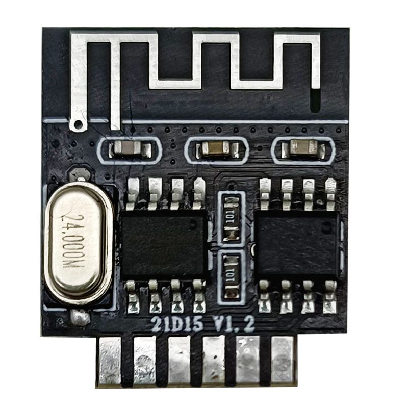

Product overview
NY-6801-001 Bluetooth module is based on Bluetooth 5.1 version. It is small in size, equipped with display and voice driver. It is simple and convenient to develop. It is suitable for customers with R&D capabilities to add scan code payment functions to traditional devices.
After the user scans the code to pay, the D3 pin of the NY-6801-001 Bluetooth module outputs a high level. After the timer ends, the D3 pin outputs a low level. The MCU can determine whether the device needs to work through the level status of the D3 pin. It can also be made separately into a scan code payment controller to control the power on and off of the device.

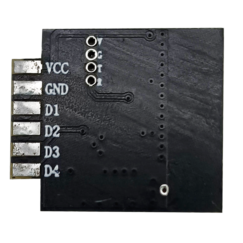

Hardware parameters
微信图片_20220428175528微信图片_20220428175537
2.1 Pin description
 Pin
Pin name
Pin description
VCC
Positive power supply, input voltage 2.7~3.4V, 3.3V power supply recommended.
2
GND
Power ground.
3
D1
TM_SCL drives the TM1650 chip and is used to display the countdown time.
4
D2
TM_SDA drives the TM1650 chip and is used to display the countdown time.
5
D3
After payment, a high level (3.3V level) is output, and after the timer expires, a low level is output.
6
D4
Voice chip output is suitable for the control of Jiaren CHD40 single-line voice chip.
Voice playback timing: power on, successful payment, 1-minute reminder, end of timer.
Voice storage order:
1 Timing end voice
2 Voice of successful payment
3 1 minute countdown reminder voice
4 5-minute countdown reminder voice
5 Power-on voice
2.2 Performance parameters
Project
 Parameter
Remark
Bluetooth version
Bluetooth version 5.1
Communication distance
Within 15 meters
Working voltage
Voltage 2.7~3.4V, 3.3V power supply recommended.
Working current
Standby 40uA, broadcast 4mA
Timing length
Within 12 hours
Working temperature
-35℃~75℃
Module size
18x20MM

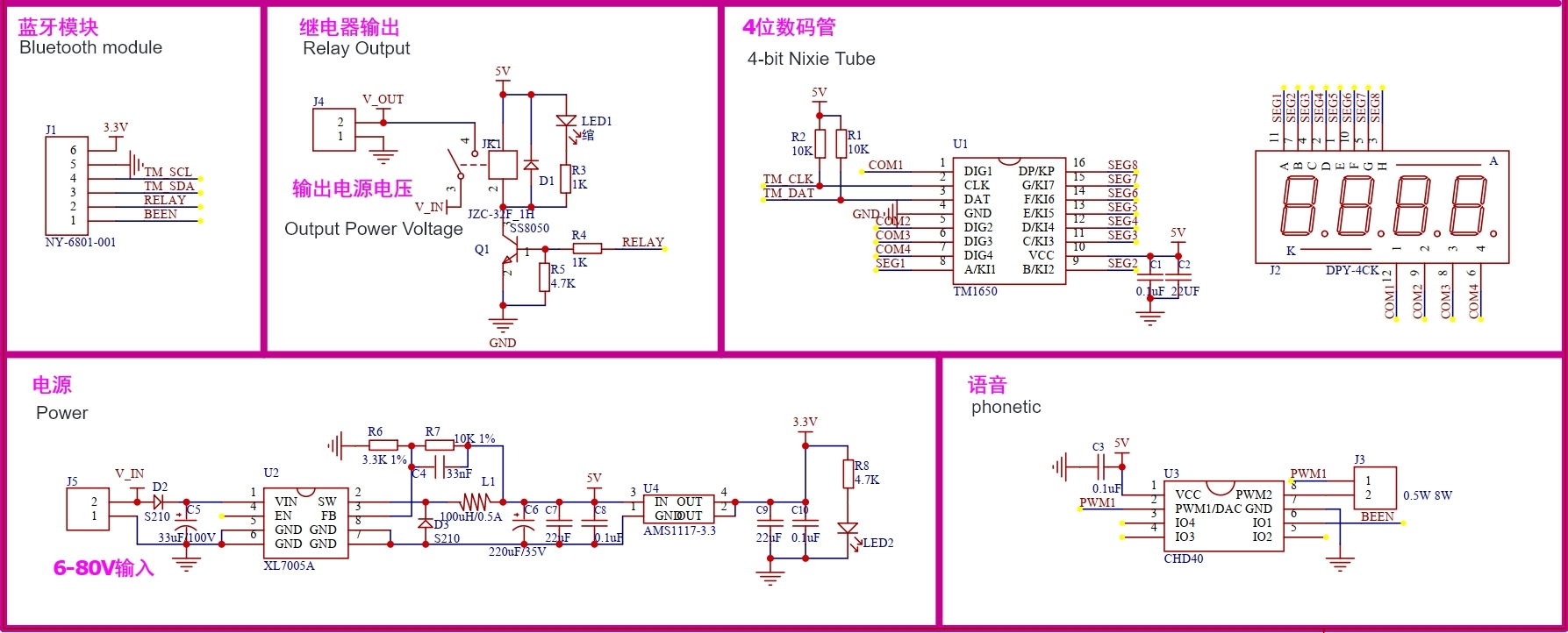

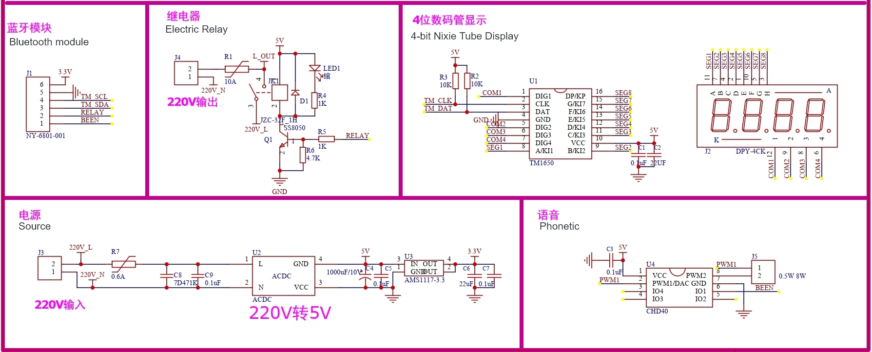

Reference Application Plan
3.1 Scan code to pay socket (applicable to devices that control 220V electricity)
3.2 Scan the QR code to pay for children’s cars (applicable to equipment that controls DC power)
