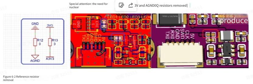

On the basis of the official, I added a power supply interface, the reason is that when I use the official oscilloscope extension version, the power supply interface and the waveform acquisition channel and the waveform output channel interfere with each other, and cannot be used normally, after being modified to the waveform acquisition channel in this project, it will directly cause a channel to be unusable, so a power supply interface is added in this project to ensure the stable use of dual channels.
At the same time, it should be noted that the oscilloscope uses an ADC reference of +2.5V, but the reference of the Liangshan Pi is 3.3V, and the A3.3V and AGND 0Ω resistors in the Liangshan Pi need to be removed.

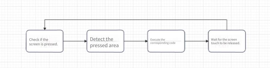

The coordinate collection of touch is shown in the figure below, and two state machines are added at the same time to support a single touch, and placing a touch screen once will cause the corresponding function to be triggered multiple times.
To briefly introduce the touch logic in this project, first of all, cycle to detect whether the screen is pressed, when pressed, detect the screen area that is pressed, if there is a corresponding touch function in the area, execute the corresponding code, after the execution, wait for the touch to be released, when the touch is released, it will return to the beginning to achieve loop detection, the logic block diagram is shown in the following figure.
The touch response function in the unpaused state is shown in the following figure.
The touch response function in the paused state is shown in the following figure.

1. In the power part of the schematic design description, it is mentioned that the reference source of ADC is +2.5V, but the reference source used in Liangshan Pi is 3.3V, so the A3.3V and AGND 0Ω resistors in Liangshan Pi need to be removed, otherwise it is equivalent to 2.5V and 3.3V short circuit, but I actually did not notice this at the beginning. Did not remove the 0Ω resistance of LiangshanPi, but in this case, the oscilloscope is able to work normally. The reason for the normal work is that the 0Ω resistance is not a lot of real short connection, there is still a part of the resistance, 3.3-2.5=0.8V voltage drop through the 0Ω resistance can not burn the circuit, through the actual power test, The data I got is shown below.
Remove the 0Ω resistor case Not demolished dismantle
Oscilloscope current 254.6mA 125.4mA
Test equipment: Hezhou CC table.
However, it is still not recommended to insert an oscilloscope extension without removing the 0Ω resistor. If you have to try it, do it when it is safe to do so.
