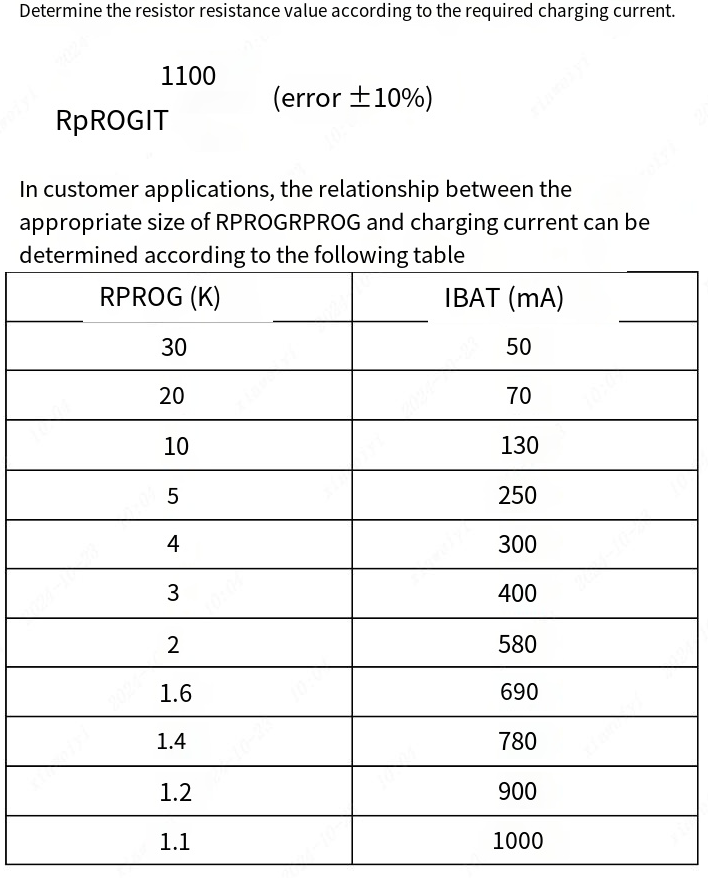

Charging: TP4056X-42-ESOP8, 1000mA 523450 lithium battery, charging resistance 2kΩ, current 580mA.

1. The power monitoring part does not use a fuel meter chip, so the power estimation will be biased.
2. The charging current can be adjusted according to the RPROG resistance.
