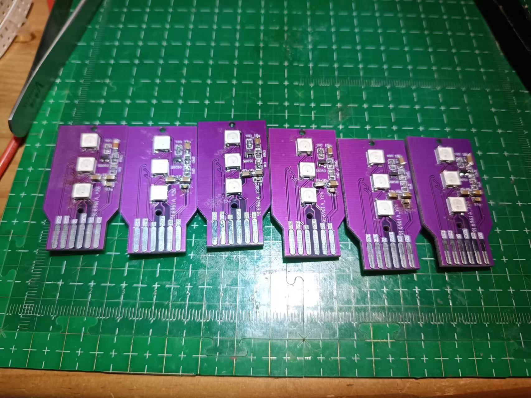

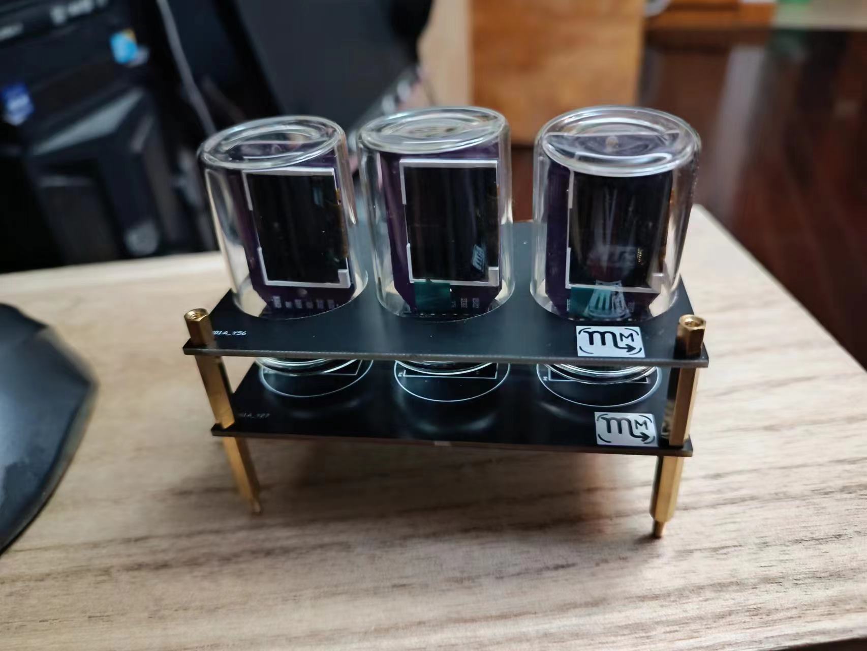

The structure of this project is modified from an imitation glow tube clock, but the original project cannot be found.
The program functions with reference to several weather clock works.

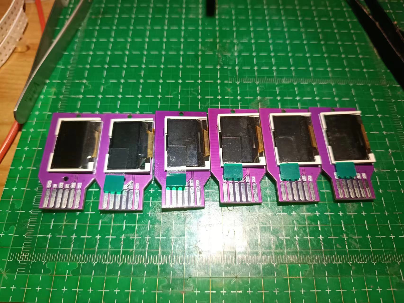

The screen of this project is 1 piece of stock screen, and this production is also regarded as the consumption of the screen, of course, it can also be replaced with other screens.
Most of the open source works cannot be proofed due to the relationship between the number of display digits, so they are modified to 2 segments, and the host and part of the display are separated.
Since I couldn't find a suitable test tube type glass cover, I used some "Internet celebrity succulent glass bottles" as an alternative. However, the size of these bottles is not consistent, and it has always been thought that it is a problem with the accuracy of PCB slotting that leads to multiple proofing. Finally, out of the 20 bottles purchased, 5 large ones were selected and could be fixed on the bracket.
After that, there is a small fixed frame slot, if the bottle can not be installed, you need to polish it yourself, or change the slotted to a larger one, and find a way to fix the bottle by yourself.

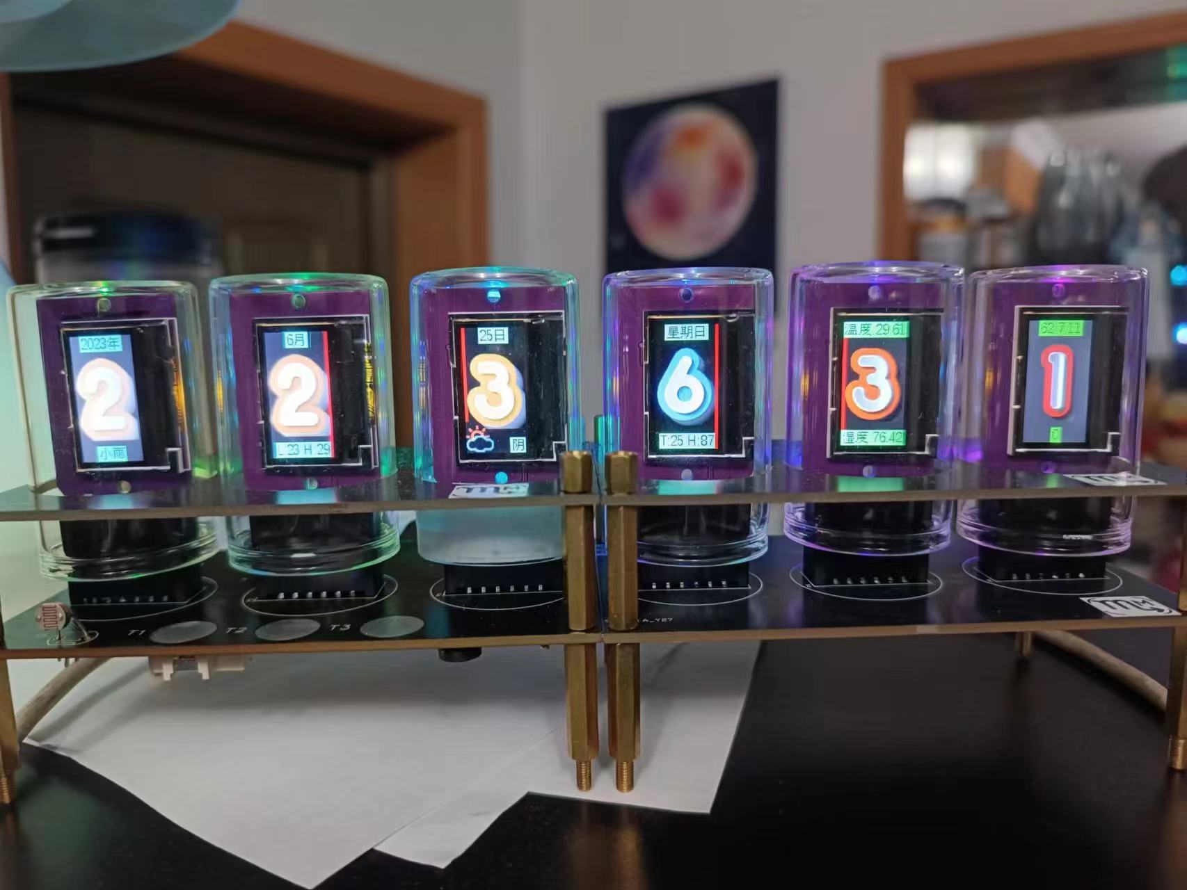

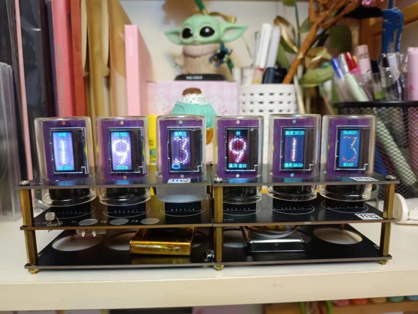

Key features:
1. Display time.
2. Display the weather forecast.
3. Display the ambient temperature and humidity.
4. Automatically adjust the display brightness and RGB brightness according to the ambient light.
