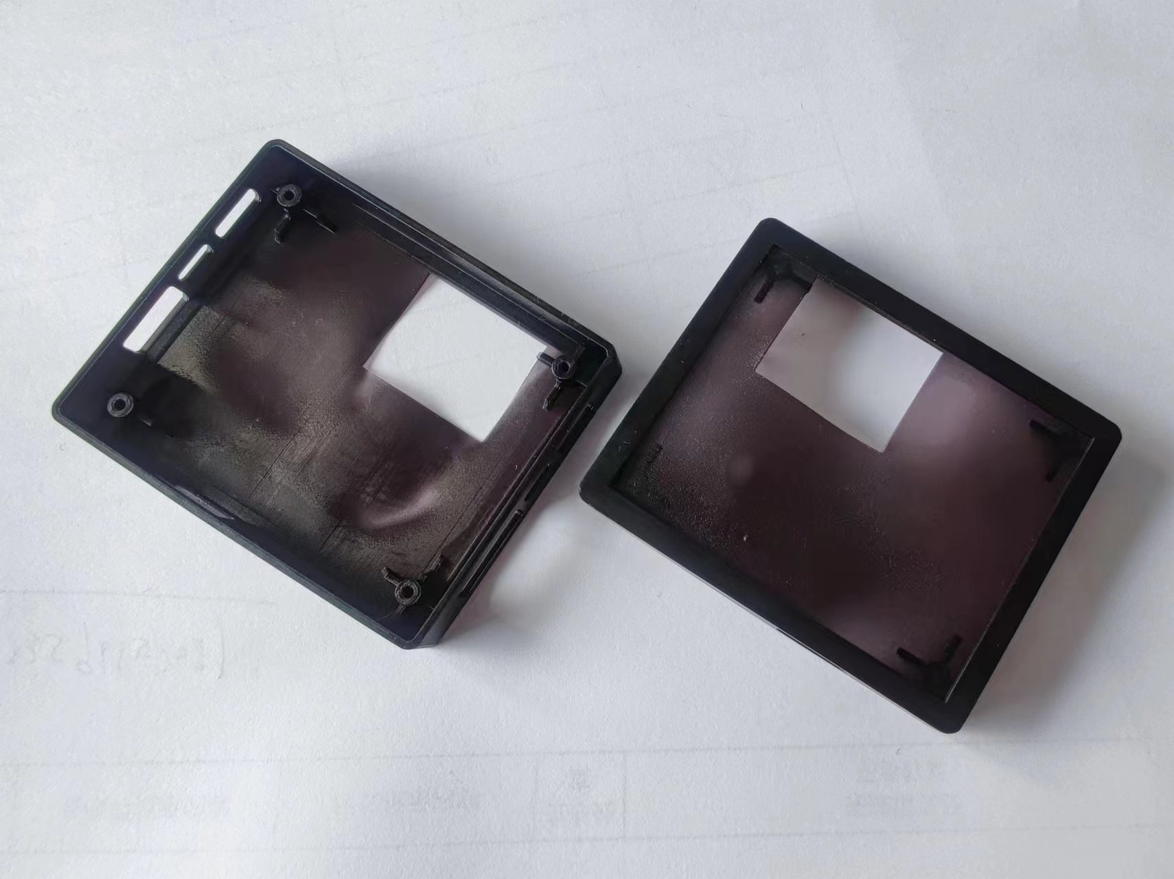

(1) The interfaces for connecting the drone and debugging equipment are designed on the left and right sides respectively to facilitate connection and debugging;
(2) There are 4 screw holes around the board for connecting the PSDK bracket and fixing it on the drone.
Of course, you also need to set the shell for it, the same in JLC proofing.
The front part here is made of Imagine Black material, while the bottom part is made of ordinary nylon spray paint, which has a better effect. However, it is a bit thin because the front is dug down, but fortunately there are panels to support it:
Here I made two types of acrylic panels, black and white. The functions of each interface and the definition of pin headers are identified above.
