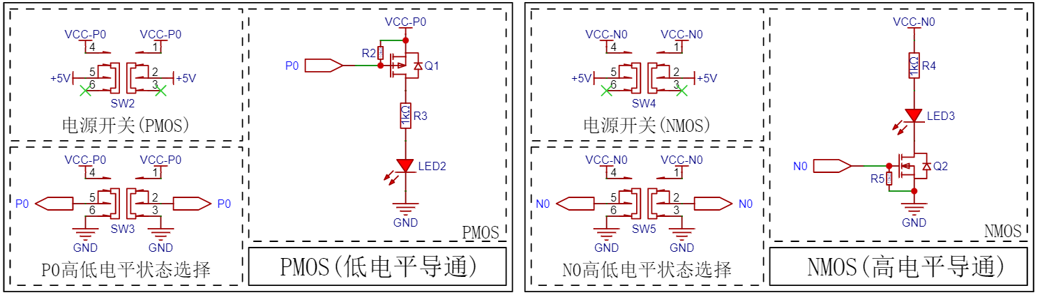

When using PMOS control, it is usually placed above the load as a top tube, and a pull-up resistor is often added to the PMOS to keep a stable high-level initial state to prevent the PMOS gate level from being disturbed by external interference and producing an uncertain stateto ensure that PMOS is turned off by default. When P0 is low, PMOS turns on and the LED lights up; When P0 is high, the PMOS is off and the LED is off.
Fig.1-1-2 PMOS switch control circuit diagram
1.2 NMOS
NMOS refers to a MOS transistor that transports electric current on a P-type substrate (sub) and N-channel by the flow of electrons. Forming a conduction channel requires positive charge attraction, high level on, and low level cut-off.
Fig.1-2-1 Schematic diagram of NMOS symbol and structure
When using NMOS control, it is usually placed under the load as a downtube, and a pull-down resistor is often added to the NMOS to keep a stable low-level initial state to prevent the NMOS gate level from being disturbed by external interference and producing an uncertain stateto ensure that NMOS is disabled by default. When N0 is low, the NMOS is turned off and the LED is off; When N0 is high, the NMOS turns on and the LED lights up.
Fig.1-2-2 NMOS switching control circuit diagram

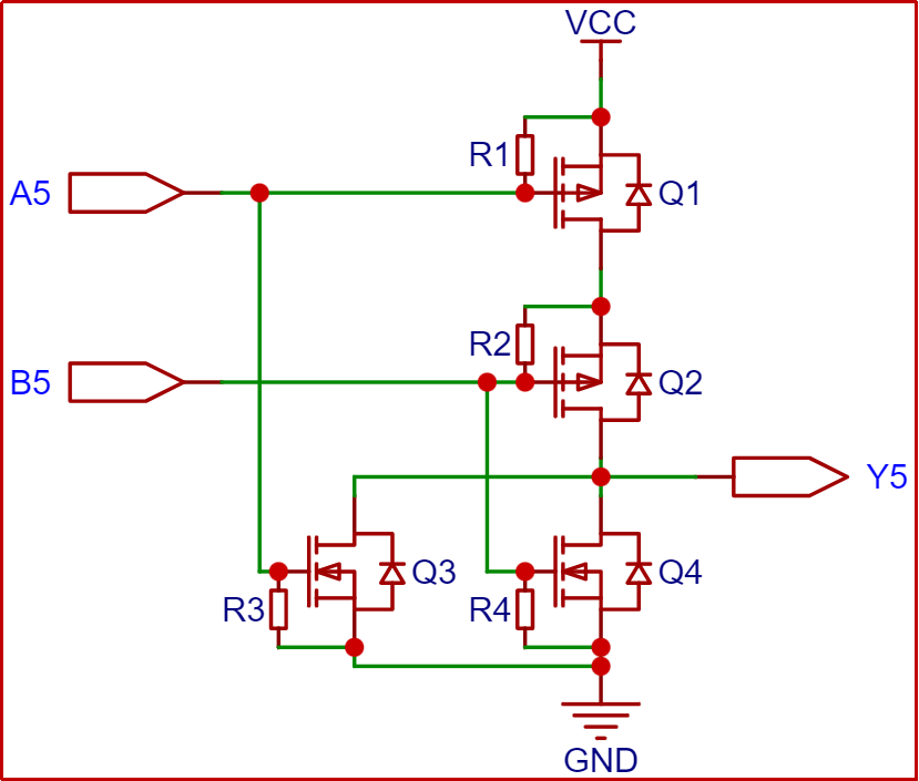

2.5 NOR Gate
NOR gate is a superimposed combination of NOR gate and NOR gate. The output is high (logic 1) only when the inputs are all low (logic 0), otherwise the output is low (logic 0).
Figure 2-5-1 NOR gate logic symbols (rectangular national standard symbols and shape feature symbols)
Table 1-5 or non-true value table
input
output
A5
B5
Y5
Logical expression: Y5=(A5+B5)'
Fig.2-5-2 CMOS or NAND gate circuit
Operating principle:
(1) When A5 input is low and B5 input is low, Q1 and Q2 are on, Q3 and Q4 are cut off, and Y5 is output high;
(2) When A5 input low level and B5 input high level, Q1 and Q4 are on, Q2 and Q3 are cut off, and Y5 output is low;
(3) When A5 input is high and B5 input is low, Q2 and Q3 are on, Q1 and Q4 are cut-off, and Y5 is output low;
(4) When A5 input high and B5 input high, Q3 and Q4 are on, Q1 and Q2 are cut off, and Y5 is output low;
Fig.2-5-3 Working principle of a CMOS or NAND gate circuit

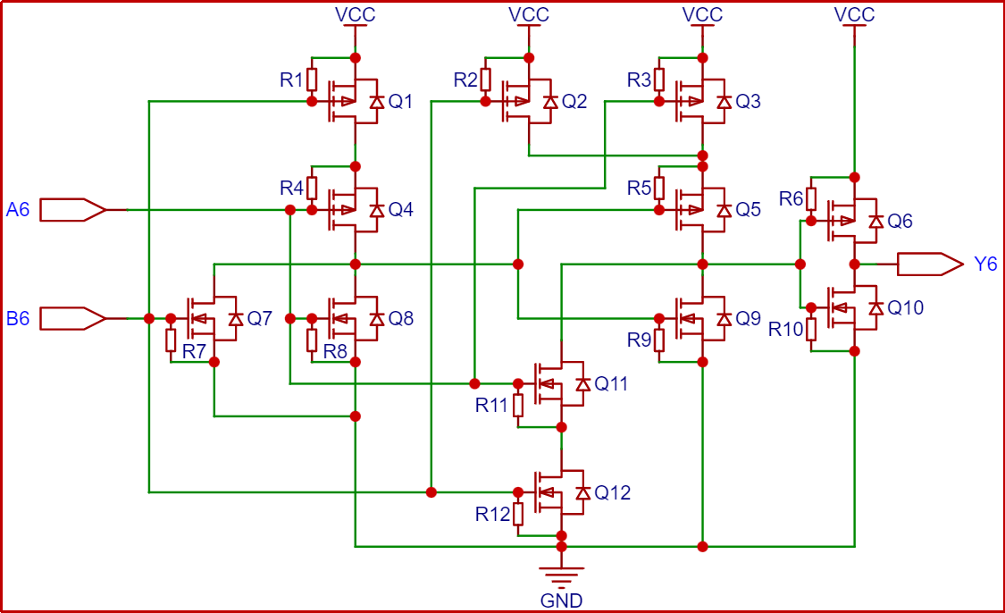

2.6 XNOR gate
XNOR gate can be composed of only NAND gate or NOR gate, with the same input and the output as high (logic 1) and different inputs and low output (logic 0).
Fig.2-6-1 Logical symbols of the same or gate (rectangular national standard symbol and shape feature symbol).
Fig. 2-6-2 Implementing the same or gate
Table 1-6 Table of true values of the same or the same
input
output
A6
B6
Y6
Logical expression: Y6=A6⊙B6=A6·B6 + A6’·B6’
Fig.2-6-3 CMOS or gate circuit
(1) When A6 input is low and B6 input is low, Q1, Q2, Q3, Q4, Q6, Q9 are on, Q5, Q7, Q8, Q10, Q11, Q12 are cut-off, and Y6 output is high;
(2) When A6 input low level and B6 input high level, Q3, Q4, Q5, Q7, Q10, Q12 are on, Q1, Q2, Q6, Q8, Q9, Q11Cut-off, Y6 output low;
(3) When A6 input high level and B6 input low level, Q1, Q2, Q5, Q8, Q10, Q11 are on, Q3, Q4, Q6, Q7, Q9, Q12 cut-off, Y6 output low;
(4) When A6 input high and B6 input high, Q5, Q6, Q7, Q8, Q11, Q12 on, Q1, Q2, Q3, Q4, Q9, Q10 cut-offY6 output high;
Fig.2-6-4 Working principle of CMOS OR gate circuit

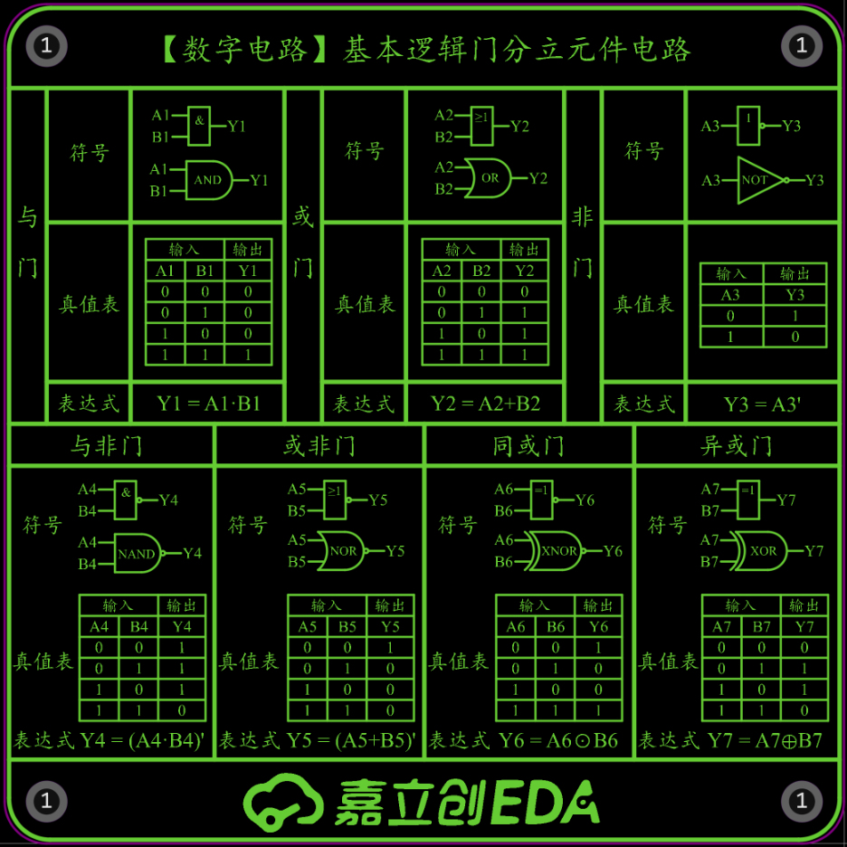

After the top surface is drawn, the symbols, truth tables and expressions of each logic gate are placed on the back to clarify the logical operation relationship of each logic gate and facilitate understanding and learning.
Fig.3-2-2 Silkscreen appreciation of basic logic operations

After plugging in the TYPE-C and powering on, toggle the switch to the top on, the power status indicator lights up, the power supply supplies power to the whole board, and each logic gate has an independent power switch for control, and it is recommended to control each logic gate separately when verifying.
Fig.4-2-1 Power switching circuit
2.2 PMOS circuits
Toggle on the PMOS power switch, and the PMOS circuit works normally.
  • When the input level control switch is set to low, that is, the PMOS input level is low, and the indicator light is on;
  • When the input level control switch is set high, that is, the PMOS input level is high, and the indicator light is off.
Fig.4-2-2 PMOS verification workchart
2.3 NMOS circuits
Toggle on the NMOS power switch, and the NMOS circuit works normally.
  • When the input level control switch is low, that is, the NMOS input is low, and the indicator light is off;
  • When the input level control switch is set high, that is, the NMOS input is high, and the indicator light is on.
Fig.4-2-3 NMOS verification workmap

2.7 NOR gate
Toggle on the AND NOT gate power switch, and the NOT gate circuit works normally.
  • When the input level control switch is set to 00, the output level is high, and the indicator light is on;
  • When the input level control switch is set to 01, the output level is high, and the indicator light is on;
  • When the input level control switch is set to 10, the output level is high, and the indicator light is on;
  • When the input level control switch is dialed to 11, the output level is low and the indicator light is off;
Figure 4-2-7 NOR gate verification workmap

2.9 XNOR gate
Toggle the power switch to open the OR gate, and the OR gate circuit works normally.
  • When the input level control switch is set to 01, the output level is low, and the indicator light is off;
  • When the input level control switch is set to 10, the output level is low, and the indicator light is off;
  • When the input level control switch is set to 11, the output level is high, and the indicator light is on;
Fig. 4-2-9 Verification diagram of the XNOR gate
2.10 XOR Gate
Toggle the power switch to turn on the XOR gate, and the XOR gate circuit works normally.
  • When the input level control switch is set to 00, the output level is low, and the indicator light is off;
Figure 4-2-10 XOR gate verification diagram
