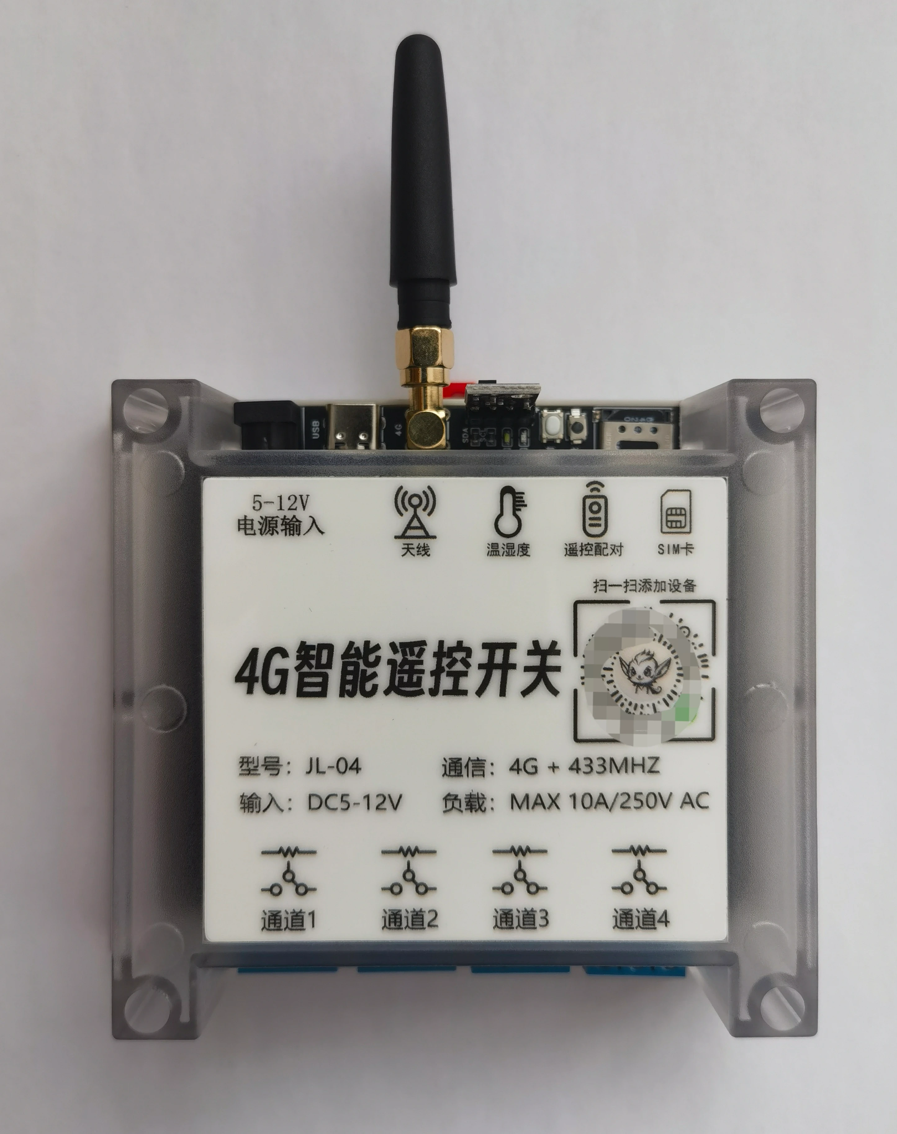

Based on Air780E, the 4-way switch can collect environmental temperature and humidity through IIC. It supports mobile Mini Program control of 4 relays + device temperature and humidity reporting, supports local 433 remote control, 5-18V voltage input, supports secondary development, and is controlled through graffiti intelligent/private server. It can be used for access control, smart home, farm management, etc.

  • Product name: 4G intelligent remote switch
  • Main functions:
  • 1. Can control 4 relays, turn on/off the appliance through the relay in the Mini Program, and customize the temperature threshold to achieve automatic control;
  • 2. It can be connected to the device through the Mini Program of the mobile phone, and the temperature and humidity values, relay status, voltage, connection status, system restart, relay switch and other functions can be displayed after connection;
  • 3. Local control can be carried out through the 433 remote control module (model: Ling-R1A-M3_433 point), and the anti-interference ability is strong;
  • 4. Mini Program platform can define interface functions by itself, add status display, customize exclusive interface, and share devices;

Hardware part
  1. Main control MCU
Air780E is a 4G full network communication module launched by Hezhou Communication. It uses the core-shifting EC618 platform, supports LTE 3GPP Rel.13 technology, and the module is packaged in LGA.
2. DC-DC
JW5359M is a single-chip buck switching regulator based on the I2 architecture, which can achieve fast transient response. JW5359 operates in the input range of 4.5V~ 18V and provides 2A continuous output current through two integrated N-channel MOSFETs.
  1. Temperature and humidity sensor
Humidity measurement range: 0~ 100% RH
Temperature measurement range: -40~ 125 ℃
Working voltage: 2.4~ 5.5VDC (wide voltage)
4. Relay
Maximum support for controlling 250V & 15A devices.
