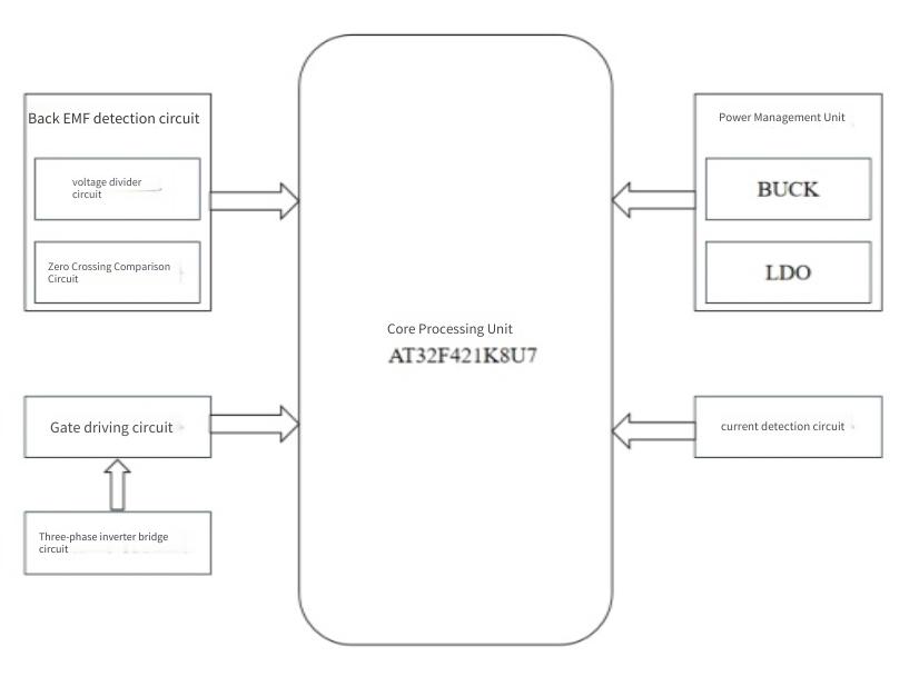

Hardware Block Diagram
Four-in-One Electronic Speed Controller (4-IN-1 ESC). The hardware part is mainly composed of a core processing unit, a power management unit, a back electromotive force detection circuit, a gate drive circuit, a three-phase inverter bridge circuit, a current detection circuit, etc.

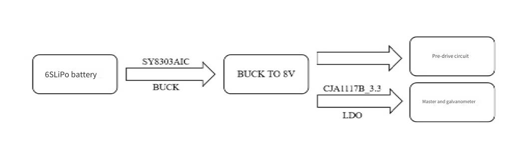

Power Management Unit
The ESC power management unit consists of a BUCK circuit and an LDO circuit, and the BUCK circuit outputs a voltage drop of about 24V from the power battery 8V, which supplies power to the gate drive circuit, and then the 8V voltage output by the BUCK circuit passes through the roadThe LDO step-down is 3.3V, which supplies power to the ESC master and ammeter. Power tree diagram as shown in the image.
Low-dropout linear regulators are partially selectedThe CJA1117B-3.3 has a fixed output voltage of 3.3V, a current output capability of 1A and extremely low noise characteristics, which is suitable for power supply for the four masters of the ESC.
In the selection of buck-type DC-DC converters for buck circuits, the synchronous high-efficiency step-down type with SY8303AIC models is selected Compared with the traditional asynchronous rectification,the synchronous rectification technology uses a MOSFET with very low on-state resistance to replace the rectifier diode, thereby greatly reducing the loss of the rectifier circuit and improving the efficiency of the DC/DC converter. In terms of its output voltage,the design controls the BUCK circuit by determining the ratio of the voltage divider resistor at the FB terminal of the SY8303AICThe size of the output voltage. According to the SY8303AIC chip manual, the ratio of the obtained output voltage to the voltage divider resistor at the FB terminal is as follows:
Among them, R1 is the upper voltage divider resistor, and R2 is the lower voltage divider resistor. According to the above formula, when the output voltage of the BUCK circuit is required to be 8V, R1 chooses 110KΩ, R2 uses 9.1KΩ. Schematic diagram of the BUCK circuit, as shown in the figure.
