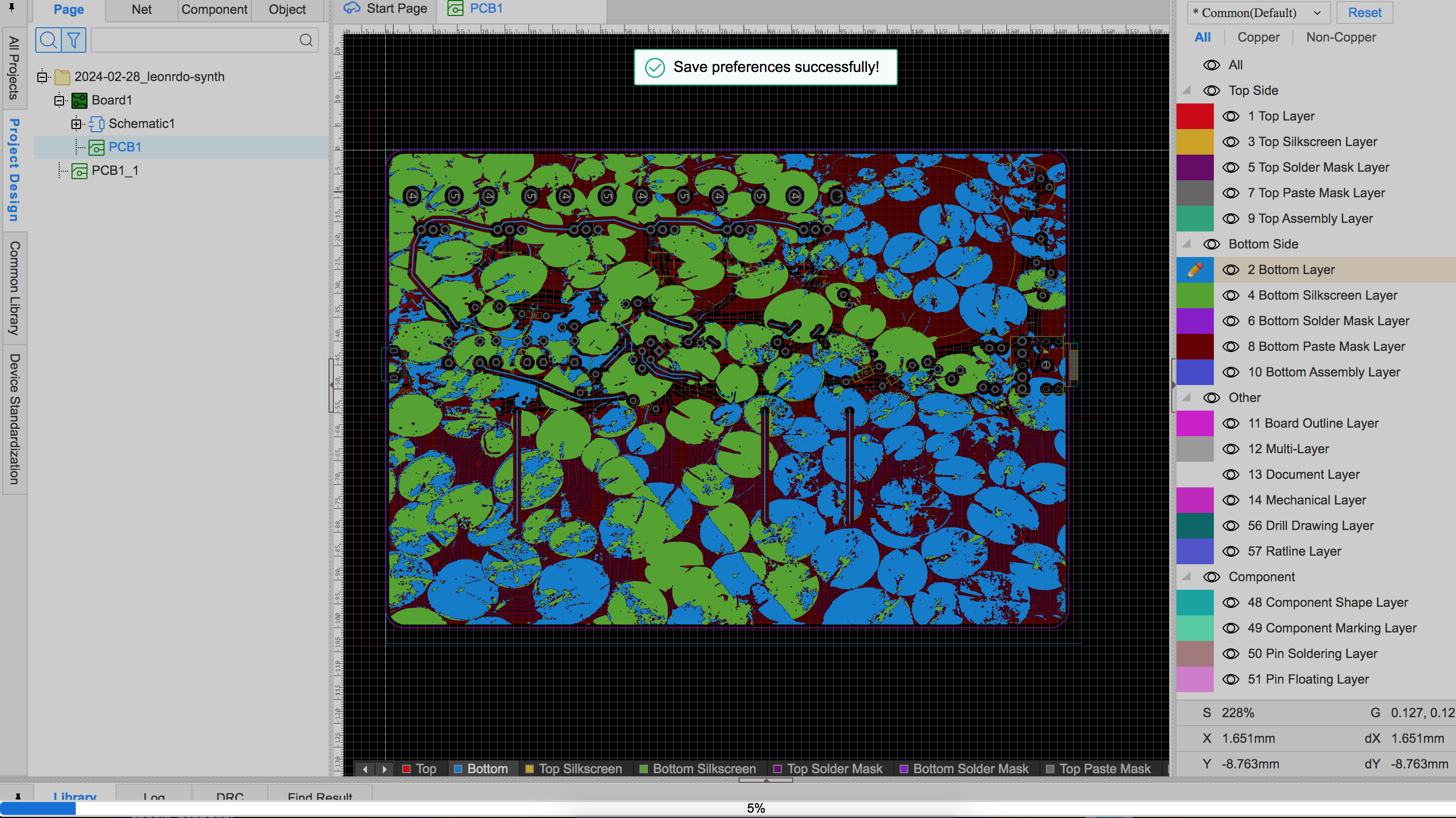

I've used EasyEDA Pro Desktop (Half-offline) on mac extensively to design many pcbs.
Currently, I have a complex pcb that I am trying to export to gerbers. Two layers of this project (back copper and back silkscreen) are derived from imported images. Every time I've tried to export the pcbs, it hangs at 5% of export. I've ended up closing the file after 20 minutes or more. The backup zip file size is 3.3mb, the .eprj file is 17.4mb.
I also uploaded a backup zip of this project (I think saving as a local zip file is broken or non-existant in this version at least) to EasyEDA professional online but the file also hangs at 5% with the online version.
I've also tried custom exporting gerbers one layer at a time from this project, but still hanging at 5%.
If I delete the two complex layers, the project will export.
Any way to solve this?
