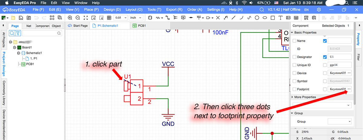

Step 1: Click on a component in schematic (that I previously made).
Step 2: In the property window, click the three dots next to the footprint attribute.

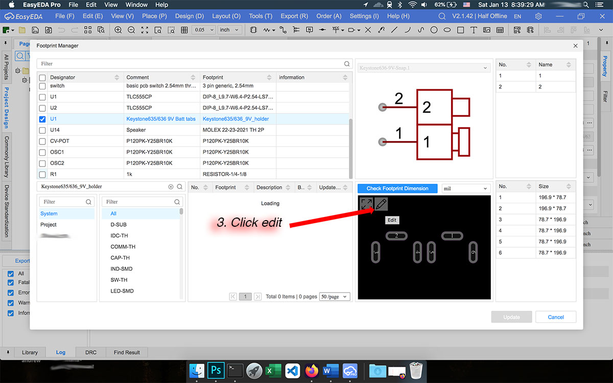

Step 3: Click edit in the footprint viewer for that part
step 3

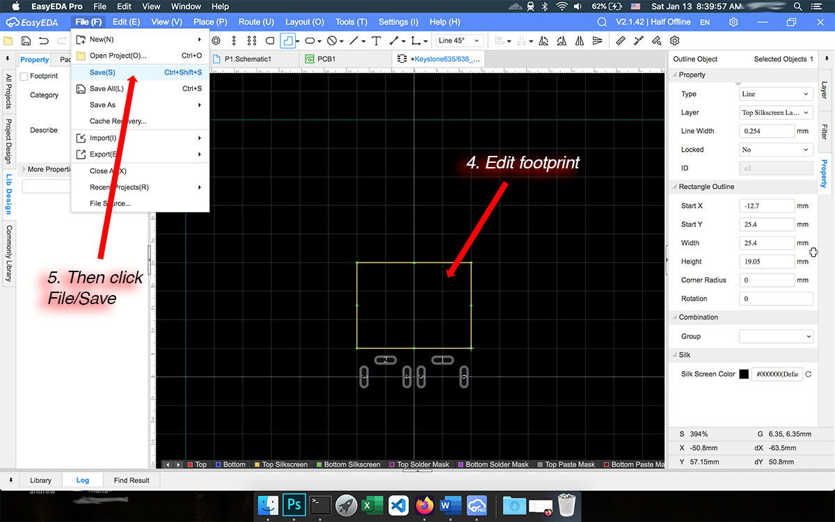

Step 4: Edit the footprint (add silkscreen, for example).

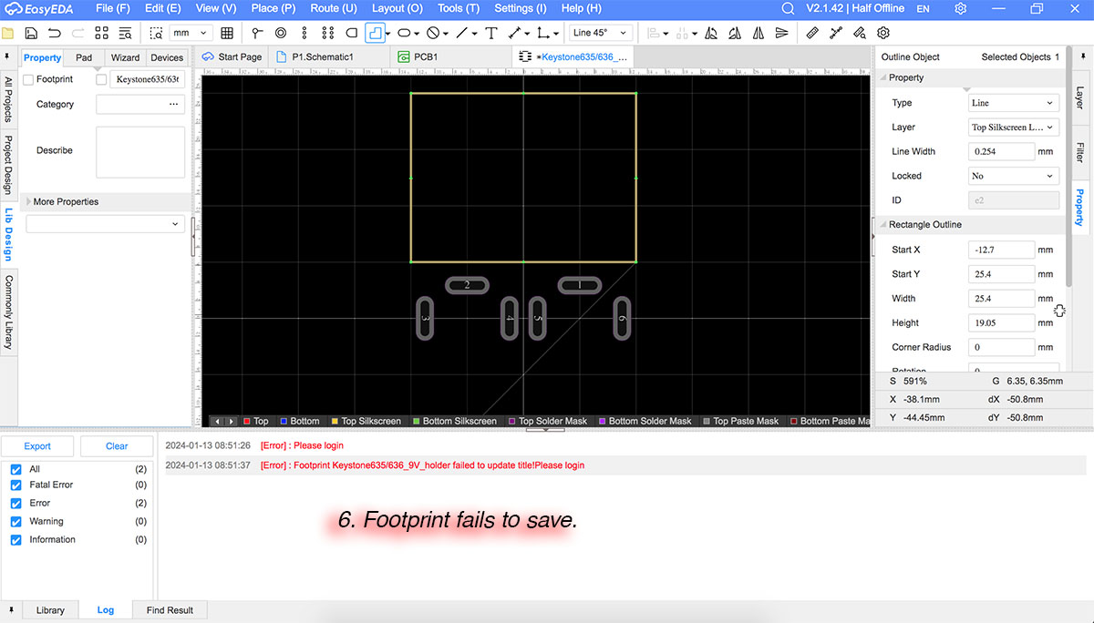

Step 5: Click File/Save to save the footprint changes. This does not work.
step 4 and 5
Step 6: An error ("[Error]: Please login") is generated when trying to save, asking me to login. If I try to click "save all" an additional different error is generated ("[Error]: Footprint <title> failed to update title/Please login")
step 6

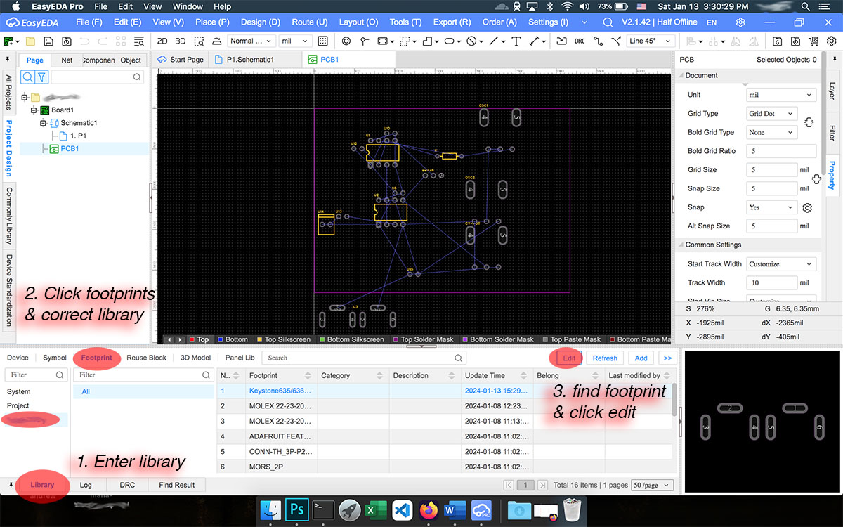

Edit: I've figured it out after two days.
1. Click the bottom "Library" tab at the bottom of the editor.
2. Click the "Footprint" tab at the top of the library and then select your user-created footprint library.
3. Find your footprint and click edit.
solution1-3
4. Then edit your footprint.
5. Click File/Save.

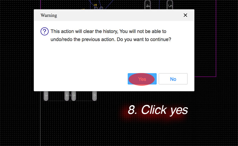

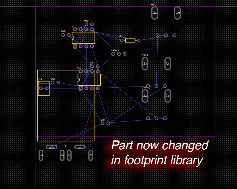

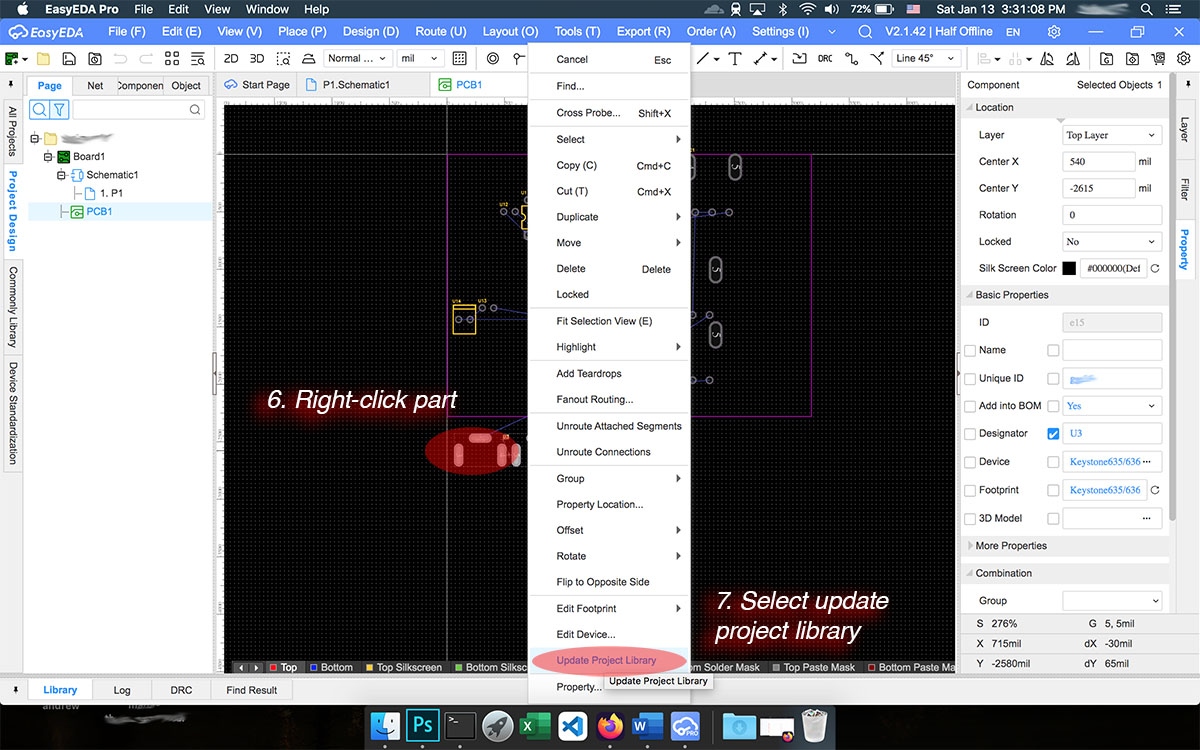

6. Back in your PCB editor, right-click the old footprint.
7. Then select "Update Project Library"
8. Click yes.
9. Click okay.
Footprint has now been changed in the library.
