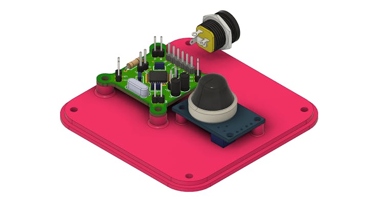

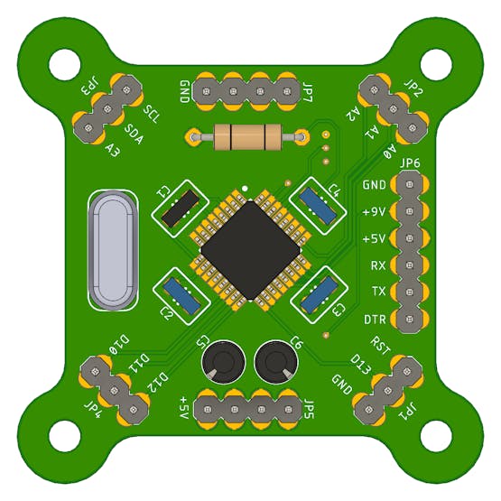

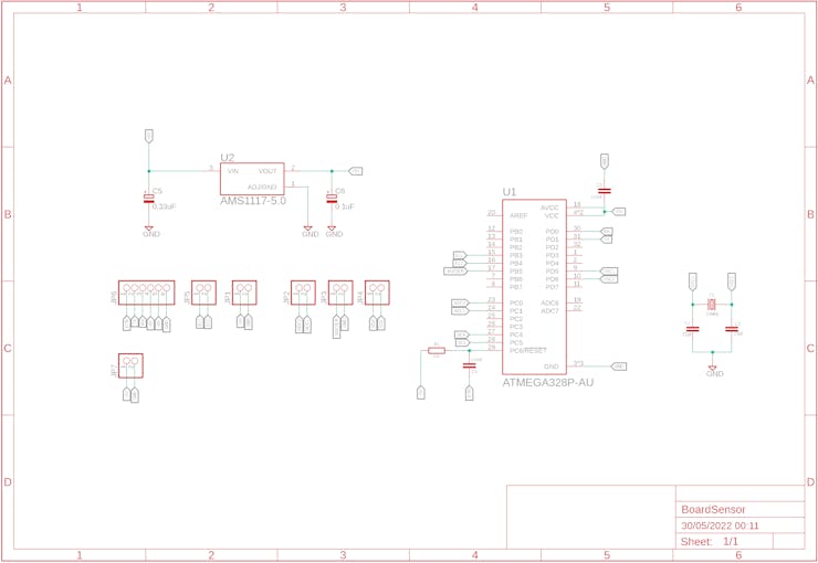

We developed an electronic board with an ATMEGA328P-AU CHIP. This circuit was developed to facilitate development and testing for several prototypes that use few digital inputs and outputs and occupy a small space. Below we have the structure of the electronic board.
The electronic board has pins for in-circuit recording (+5V, GND, TX, RX and DTR). In addition to them, we put access to other digital and I2C pins. The latter allow, for example, the use of an LCD with I2C.
Below we have the complete schematic of the electronic circuit.
The electronic design of this board is available for download. You can download and win 5 free JLCPCB units. To do this, just follow the steps below.
The board with the ATMEGA328P is designed to receive the connection of the MQ-2 sensor and the buzzer.

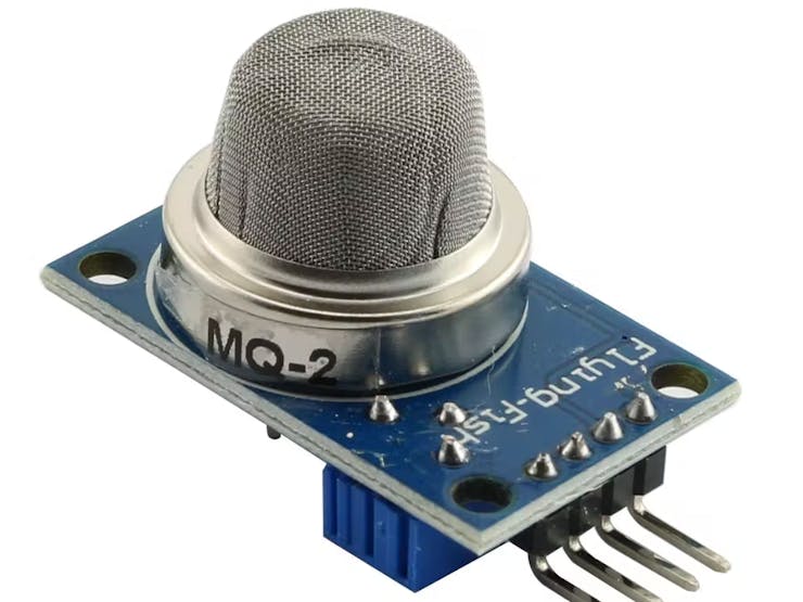

The MQ-2 sensor is responsible for reading the environment and detecting possible particles of butane gas. This sensor is powered with 5V and has two forms of signals: one analog and one digital.
See its structure in the figure below.

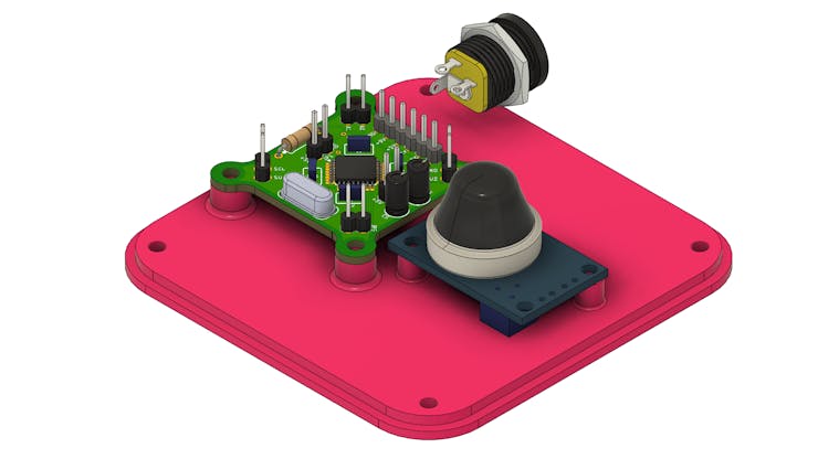

The sensor is installed in the internal structure of the enclosure.
In addition to the sensor and the electronic board, we have a Jack connector to facilitate powering the internal circuit.

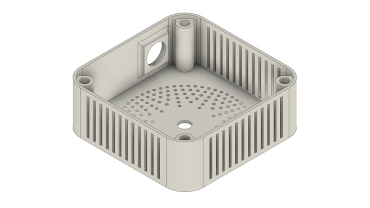

3D Development of the Project Enclosure

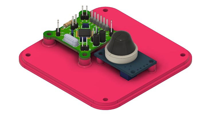

Enclosure was developed to facilitate the installation of the electronic circuit and to better present the quality of the prototype.
The prototype structure was developed with several holes in the upper region and cuts in the lateral regions. This facilitates the entry of gas into the sensor region.
The enclosure structure is divided into two parts: top cover and base.

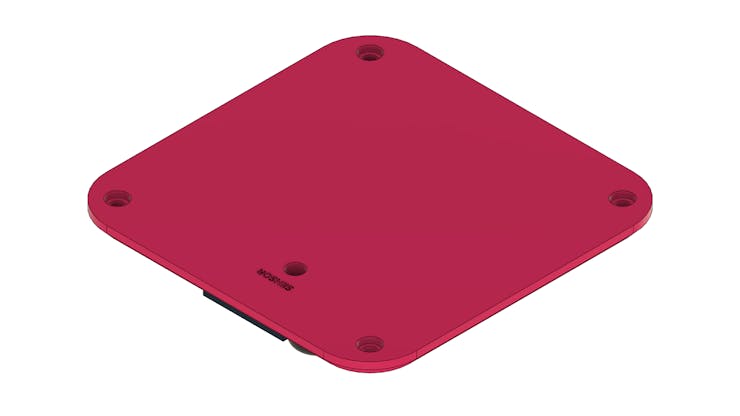

Below is the base figure.
It has all the holes for fixing the electronic control board and the sensor. In addition to the fixing holes for the plates, we have 4 holes at the ends fixing the base with the cover. See the figure below.
The base frame has a fifth hole to allow the user to adjust the sensitivity of the sensor.

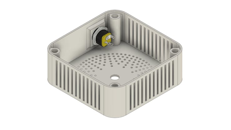

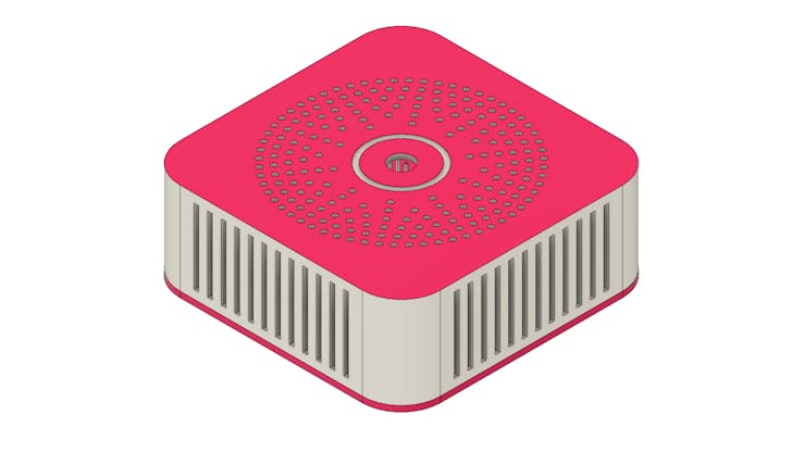

Finally, we have the enclosure lid. As already mentioned, its structure has several cuts to facilitate the entry of gas into the internal region of the circuit. See the figure below.

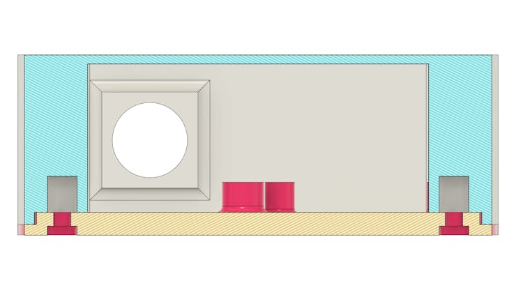

The internal structure of the lid has 4 holes. Insert nuts will be installed in each hole to allow the fixing of the base screws. The figure below shows the side view of the internal structure of each hole.
The front hole shown in the figure above was created for fixing the Jack connector. This connector is used for external power with a 9V supply. See the figure below.

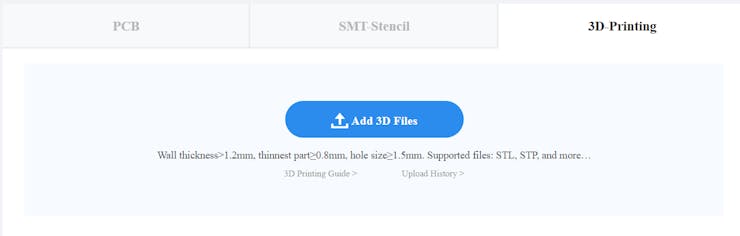

How to produce 3D Enclosure with JLC3D

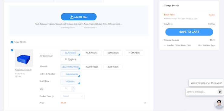

Firstly, you need access the JLC3D Website through this link and click in Add 3D files button to upload each file of your project.
After, all files will be presented and you need to select 3D Techonology, Material and other parameters to produce your 3D print project.
This project, for example, was selected to be produced with SLA Technology, LEDO 6060 Resin, Natural White color and will be produced in 48 hours.
The total to produce two pieces will be an amount of $6.26. It's very cheap!
Enjoy and access JLC3D to create any prototype!
