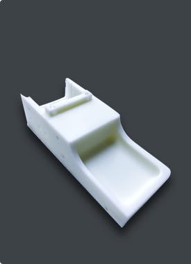

You can print your part with 5 different technologies on JLC3D. See some pictures of parts printed in each techonology used by JLC3D.
Selective Laser Sintering (SLS)
The following project was developed with FDM Technology (Fused Deposition Modelin). Now let's learn how to assemble the electronic fish feeder.
