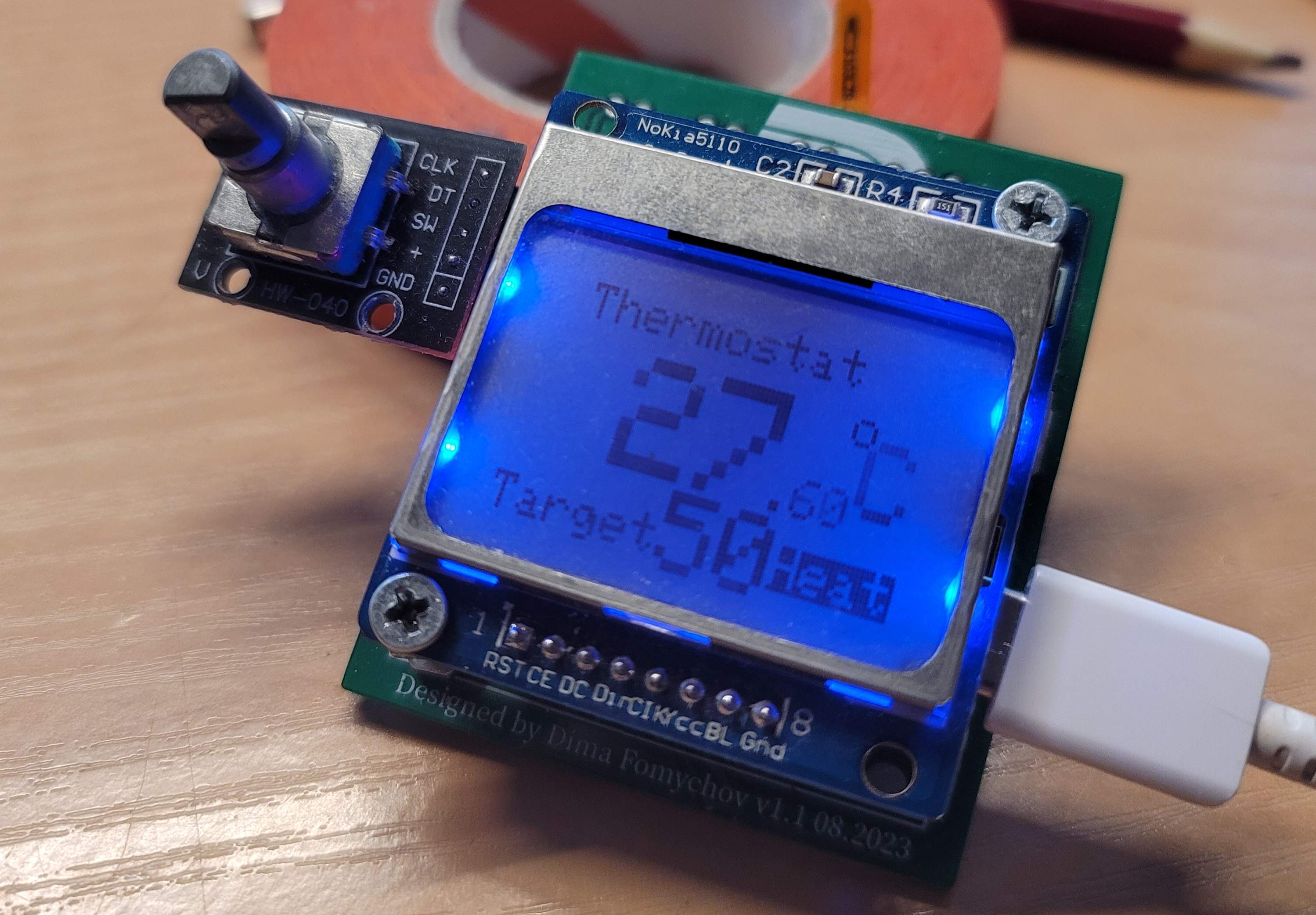

Presenting to you My variant of Universal Termocontrol.
All you need is
  • arduino nano
  • Nokia 5110 display
  • 100kOm thermoprobe (thermoresistor)
  • x2 TLP627 OPTOCOUPLER (or similar)
  • x2, x3, x4 pin header connector (optional)
https://github.com/antimyx/ArduinoAdvancedThermostat-AAT-
