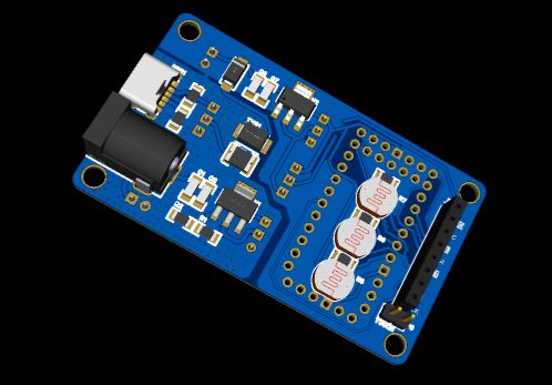

Arduino Interactive Gifts是一款小巧互動禮品,配有Arduino Pro Mini微控制器板、TFT彩色液晶螢幕(支援18位元色深)和多個光敏電阻(LDR)。
1.Arduino Pro迷你版(5V/16M)
2.TFT液晶顯示模組(Icstation 1.8吋TFT液晶螢幕128x160 ST7735)
3.CDS(5mm)
4.跳線
PCB Prepare Electronic Materials (PCB準備電子材料)
SMD MLCC
C1、C4、C8:100nF-1206
C2、C3、C7、C9:10uF-1206
C5:47uf-50v or 100uf-25v or N/A
SMD Resistors
R1:130Ω-1206
R2:390Ω-1206
R3、R4:5.1KΩ-1206
R5、R6、R7:GL7537 or 5mm_CDS
R8、R9、R10:1KΩ-1206
F1:TLC-MSMD160/6 or 0Ω-1812
DIP Connectors
P1、P2、P4:N/A
P3:2.54mm Plugin Straight Headers Connector 2x7P、1x10P、1x10P
P5:2.54mm Plugin 8P Straight 1x8P Headers Connector
P6、P7:2.54mm Plugin 3P Straight 1x3P Pin Headers or 3P slide switch
P8:2.54mm Plugin 2P Straight 1x2P Pin Headers
SMD Active component
D1:SS34 (SMA) or 1N4007_SMD (M7 or SMA)
U1:AMS1117-ADJ
U2:AMS1117-3.3
TVS:SMBJ5.0CA or N/A
Power Connector
USB:KH-TYPE-C-6P-T or SMD TYPE C 6P
DC:XDJK-0051-025 or DIP DC Power Connectors (2.1mm 6.3mm)
您可以從以下連結下載程式碼:https://github.com/BoomerChiao/ArduinoBirthday-Gift-DIY
