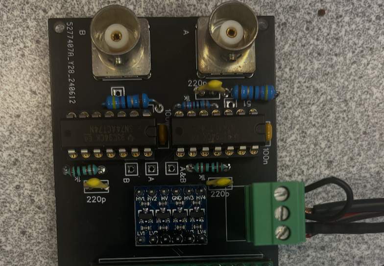

2 channel Coincidence counter for single photon experiments, with Teensy 4.0 counting MCP. 4 layer pcb
Input 5V TTL pulses. Input has 50 ohm impedance. Counting is done via de digital in ports of Teensy
