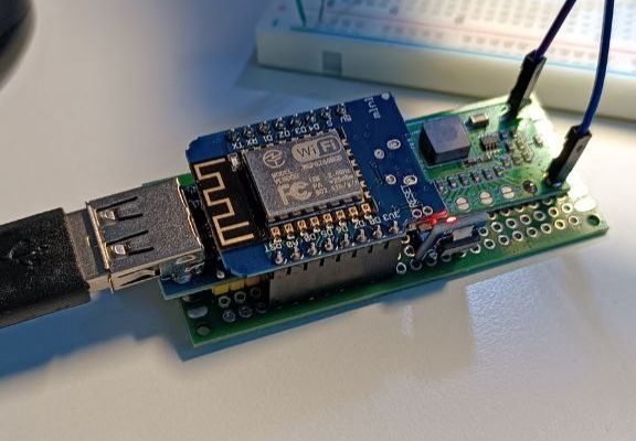

The idea behind the project is to use perhaps the cheapest Matsutec AR-10 AIS receiver on the market to transmit NMEA messages to Navionics. Navionics perfectly supports receiving messages via a Wifi network. The device is a bridge between the Matsutec AR-10 (or any other USB device running on the CH240 chip) and WiFi. In addition, NMEA messages received from USB are duplicated into the USB port of the microcontroller board; the device can be connected to a computer to transmit messages to, for example, OpenCPN. Also, messages coming to the USB of the microcontroller are sent to WiFI.
Code for the project will be placed here: https://github.com/Aleck-K/NMEA0183USB-Wifi-bridge
