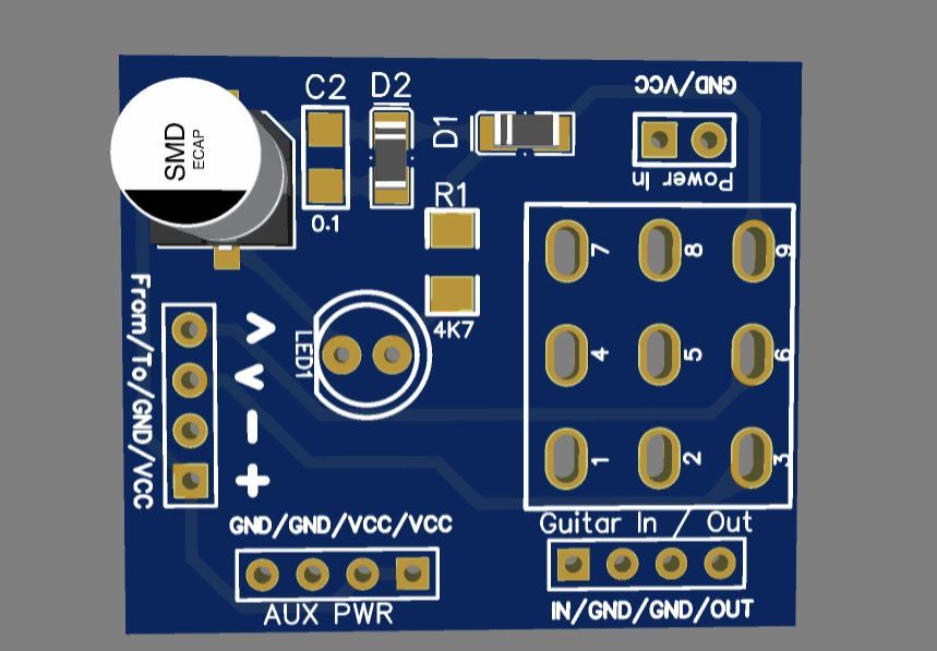

This is a Tru-Bypass Footswitch module I developed to make building Stompboxes easier!
Its not only the 3P3T Standard foot switch with an LED power indicator, it also includes the Power Supply, reverse-diode protection, clamping diode, Filtering Capacitors and additional outputs for multiple circuit boards.
Building Stompboxes has never been easier!
Run your Input/Ouput Jacks and Power Input to this board, then run four wires to the Effects Circuit. Easy Peasy.
