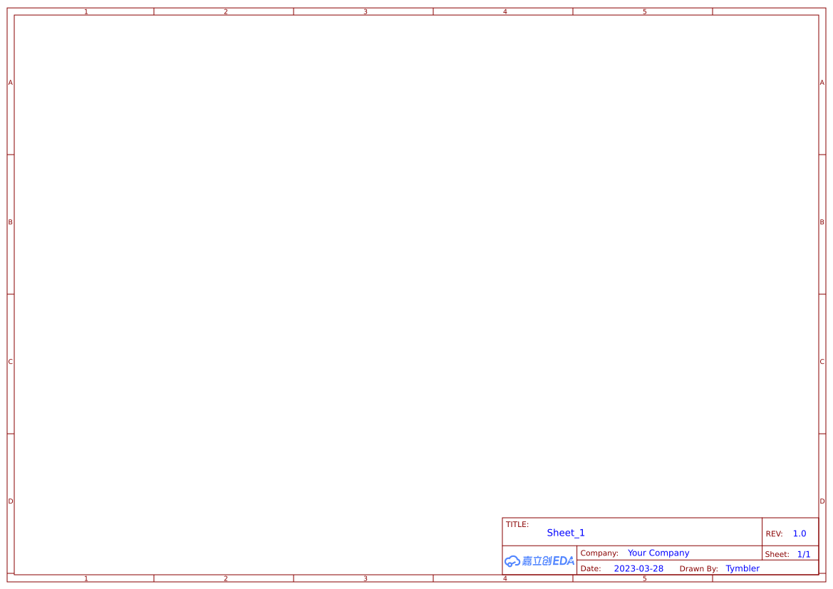

I need to replace the old camshaft position sensor with a transformer inside with a sensor with a hall-sensor. this wiring diagram is based on Siemens Simtec 56.1. oq9811tt chip is a reference frequency generator and a return signal phase shift meter. as a replacement I used a sensor from Chevrolet Lacetti, Captiva 1.8/2.0/2.2 and others with article number 96418393. When changing the circuit, be sure to swap contacts #2 and #3 in the camshaft sensor connector. And do not forget to immediately install the new sensor on the engine. If you accidentally connect the old sensor after changing the control unit circuit, there will be a short circuit.
