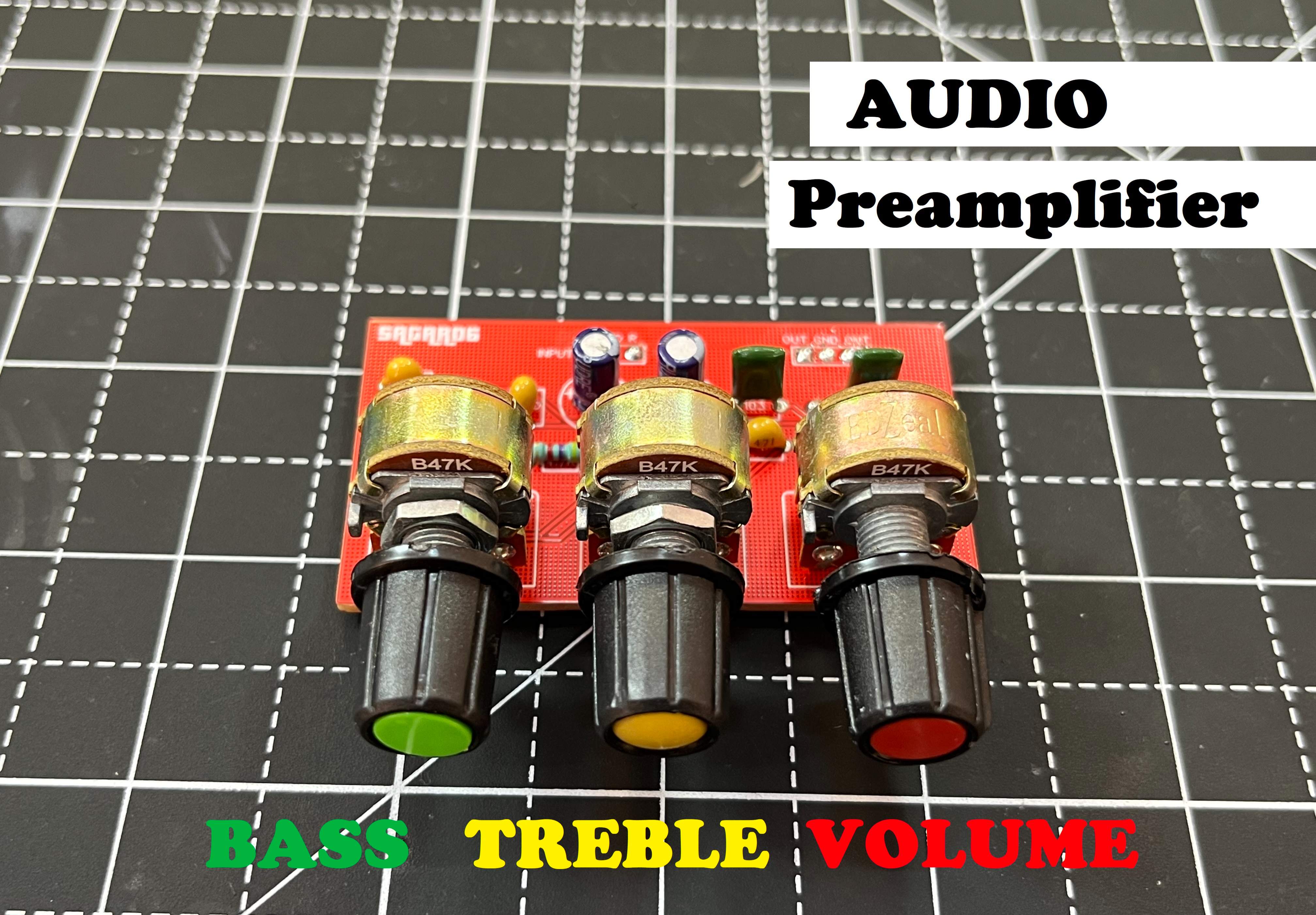

Circuit diagram:
I made the circuit according to the above discussed theory. The signal goes first to the bass and treble circuitry and then to the volume control knob. The circuit behavior is determined by the low pass and high pass filters.
PCB design and layouts:
I designed the simple layout and place the Bass, treble and volume potentiometer in front of the PCB. You can mount this PCB in any home theater system also. This preamplifier circuit is the best bandpass without power supply. Download the Gerber files from here to repeat the project.

All the tracks are already done through the PCB now we just have to solder the components. I always go first with resistors and diodes. Because they are hard to mount if big components like capacitors are placed first. Then I soldered all the potentiometer and headers on the place. PCB is well labeled so that you can repeat the same project just by downloading these Gerber files from above.
Preamp Working with amplifier:
I paired the preamplifier with previous made TDA2030 stereo amplifier. both the circuits are like made for each other. You can experience the highs and lows separately in the YouTube video given below.
This preamplifier is working very fine and stable without any external noise/ hum. I have some other preamplifier circuit also which comes with more accurate audio enhancement features. Consisting of transistor, operational amplifier, and external power supplies too.
