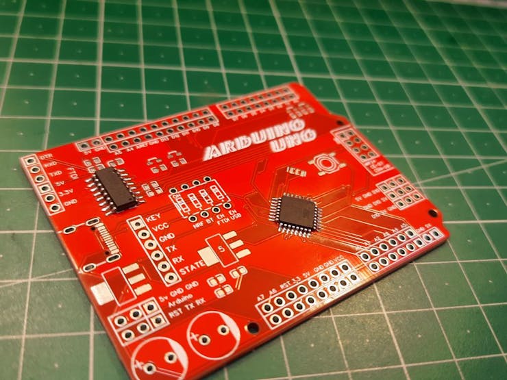

To eliminate these problems and to modify the overall layout I choose to make my own microcontroller development board which is fully compatible with UNO. Cost can be reduced using SMD components, using a low power USB to serial. And finally adding different ports/ headers for the widely used 12C modules, screens, Bluetooth, Radio modules and sensors.
Because I want to test my projects first on this Arduino so by decreasing the number of jumpers wires circuit become less complicated. And all of these things can be possible by using JLCPCB prototyping service. JLCPCB offers 5PCS of 2layer PCB in just $2. Register now to JLCPCB to get free coupons of worth $54. As for now you can get the required Gerber, BOM and CPL files only by messaging me on Instagram: Sagar_Saini_7294.

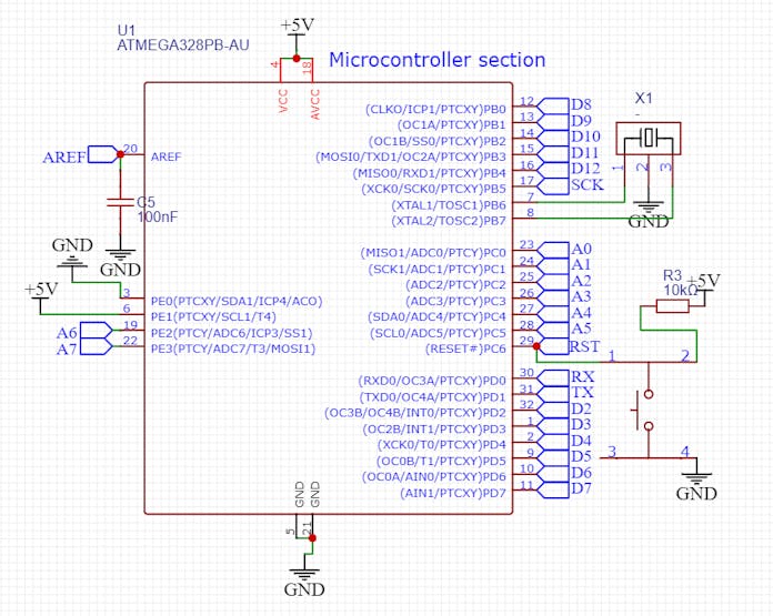

Circuit diagram:
The circuit of this microcontroller is quite simple, just follow the basics of data structure and datasheet. I am using CH340C as the USB to serial programmer. This chip has many variants and I am using “c” which has internal oscillator of 12MHz. Blue LEDs are used for Tx and Rx pins and Orange and yellow for the power and D13 pin.
1K resistors are used with these LEDs for current limiting. AMS1117 5volt regulator provide +5volt to the whole board. 100nF and 100uf capacitors for noise reduction and power filtering purpose. Tactile button with 10k resistor completes the reset circuit. A new generation USB type C for better looks and strong connection. I used Different pin headers for the I/O pins, Bluetooth connection and 12C.

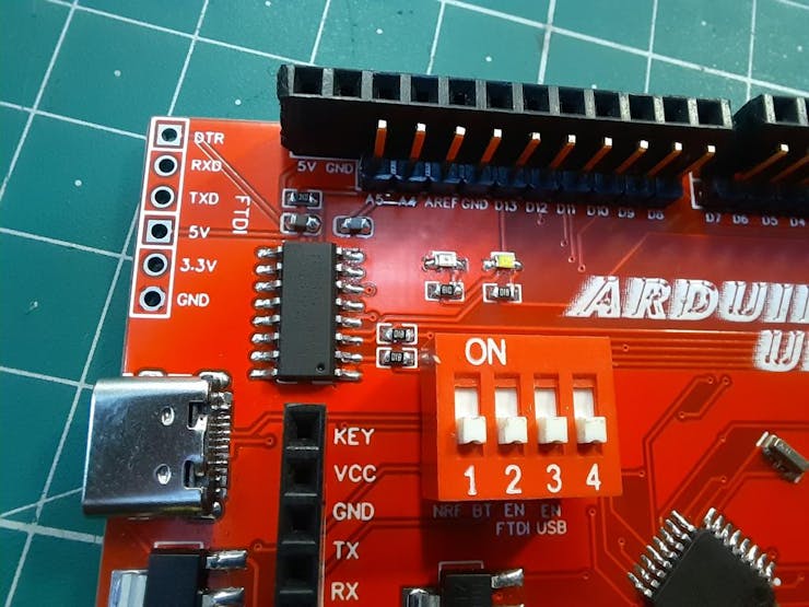

The FTDI, Bluetooth, radio and USB can be enabled using DIP switch mounted in between of the PCB. Actually, this is the main component which control the action of whole circuit.

I used EasyEDA to design the schematics of this board, there are many more features are added which are listed below in working section. If you want to modify the layout with the availability of components in your area then you can use EasyEDA and take reference as my design. The connections are okay and tested with proper net markings.
As for the PCB, I turned my schematics into PCB fabrication file. Then do some designing and place all the components at their place. Then I do manual routing of this board and download the project in the form of Gerber file.
You can upload this file to the PCB manufacturer to make a physical prototype. As for now you can get the required Gerber, BOM and CPL files only by messaging me on Instagram: Sagar_Saini_7294.

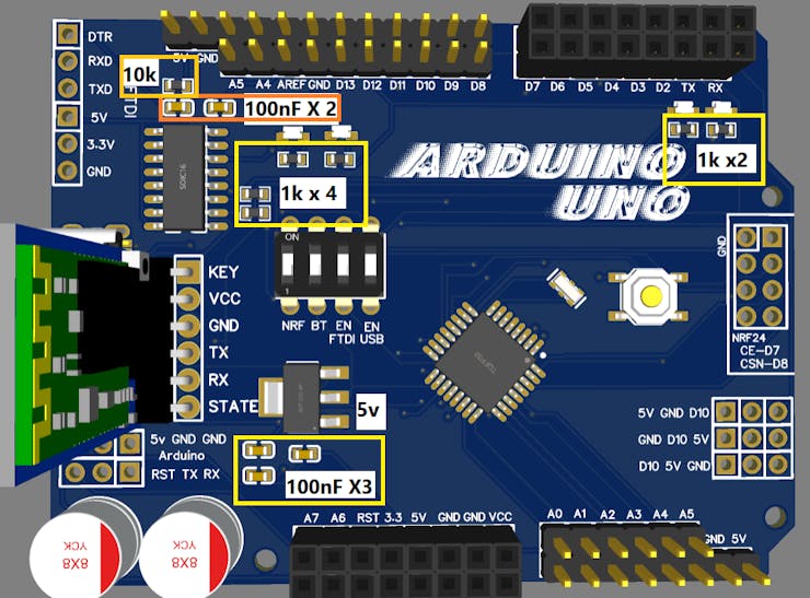

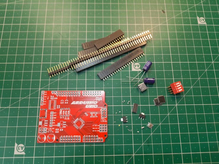

PCB specs and components mounting:
The assembly of component value is given in the picture, you can add resistor and capacitors according to that. Get me on Instagram to get the full schematics and all files.
Here all the smd components like resistor, capacitors and LEDs are 0603 package. So, try to manage the same size as preferred or you can assembly service from JLCPCB that offer SMD assembly just in $8.
Assembling the PCB board:
It is very difficult to solder the SMD package of Arduino chip using simple solder, until you don’t know right method to solder.
Just solder one pin first and the add access solder paste get some solder wire on heated solder and make a layer through out the chip. Any short in the chip pins can be removed using solder wick.
It is always recommended to use excess solder paste with SMD, but clean the residue immediately after soldering.

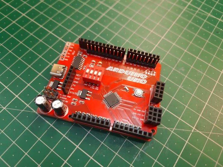

Working and features:

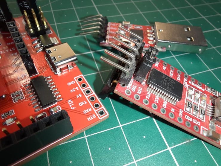

1) FTDI mode:
I added a FTDI features in this module, means if you want to program the any Arduino board like mini, Nano this can be directly connected to headers. No need of external programmer for that. Now you can switch between two modes of FTDI through DIP switch. 1St to program the onboard Arduino chip and 2nd to program any extremal MCU board.
2) Bluetooth:
I also added headers for the Bluetooth module. Offers to program the board wireless over Bluetooth. But we will cover that feature in another article. This module uses Serial protocol for the interfacing. And same DIP switch is used to ON/OFF the module.

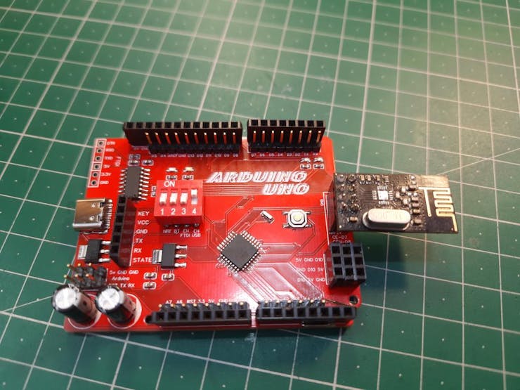

3) NRF24L01 Radio:
Nrf24L01 is mostly used with Arduino as remote-control purpose. I added headers of NRF to one side of my Arduino board so that the module can be directly plugged in to the headers. All the connections of wires are labelled on the Arduino board PCB sink screen layer,
4) 3X3 I/O header:
These are headers which is used to connect any digital sensor with 3 pins. Like DHT, microphone. No need to worry about the pin arrangement now. Because 3x3 headers form a total of 36 different probabilities to plug a module.

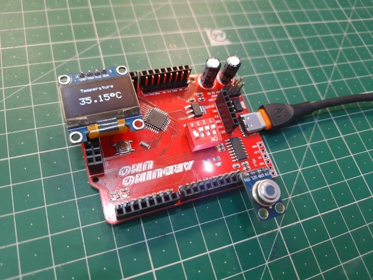

5) Direct 12C features:
Some of the display module and sensor use I2C communication with Arduino. Now you can plug the 12c screen directly into the board with any sensor to get the value displayed on screen. Download all the different programs used from here.
