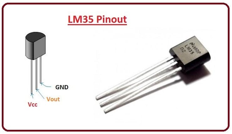

Temperature sensor (Lm35):
The LM35 series are precision integrated-circuit temperature devices with an output voltage linearly proportional to the Centigrade temperature. The LM35 device has an advantage over linear temperature sensors calibrated in Kelvin, as the user is not required to subtract a large constant voltage from the output to obtain convenient Centigrade scaling.
As the LM35 device draws only 60 μA from the supply, it has very low self-heating of less than 0.1°C in still air. The LM35 device is rated to operate over a −55°C to 150°C temperature range
More Features:
Calibrated Directly in Celsius (Centigrade)
Linear + 10-mV/°C Scale Factor
0.5°C Ensured Accuracy (at 25°C)
Operates From 4 V to 30 V

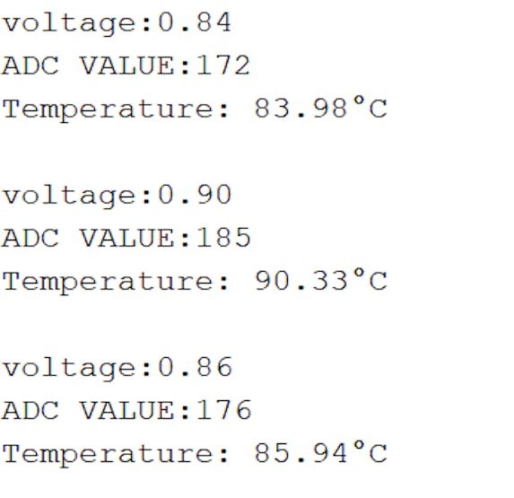

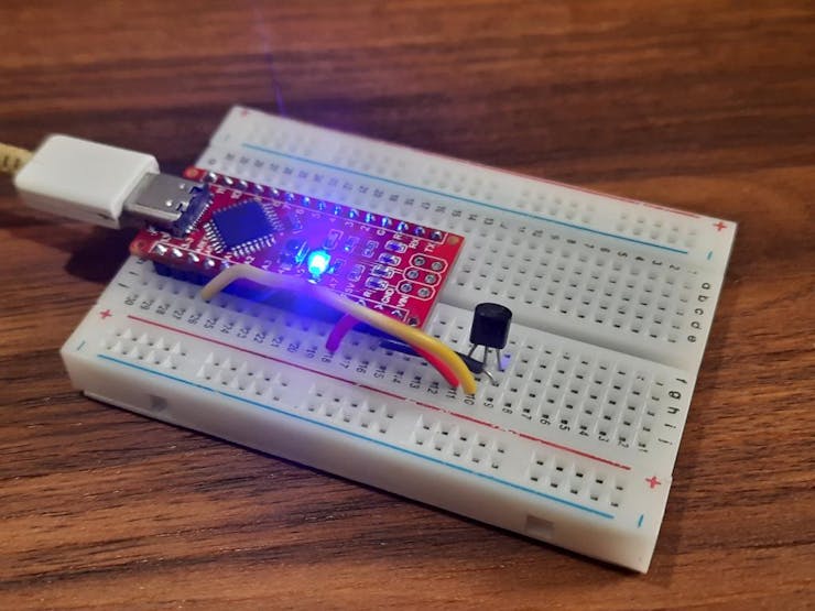

Made all the connections according to the given schematics. To check the temperature constant and voltage output, heat and cold test can be performed. After making the connections with Arduino, upload the code given below. Then open the serial monitor and start performing some test by heating/ cooling.
// Define the analog pin, the LM35's Vout pin is connected to #define sensorPin A0 void setup() { // Begin serial communication at 9600 baud rate Serial.begin(9600); } void loop() { // Get the voltage reading from the LM35 int reading = analogRead(sensorPin); // Convert that reading into voltage float voltage = reading * (5.0 / 1024.0); Serial.print("voltage:"); Serial.println(voltage); Serial.print("ADC VALUE:"); Serial.println(reading); // Convert the voltage into the temperature in Celsius float temperatureC = voltage * 100; // Print the temperature in Celsius Serial.print("Temperature: "); Serial.print(temperatureC); Serial.print("\xC2\xB0"); // shows degree symbol Serial.println("C"); Serial.println(" "); delay(1000); // wait a second between readings }

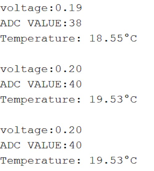

These are some observations I got, at room temperature:
On heating:
On cooling:

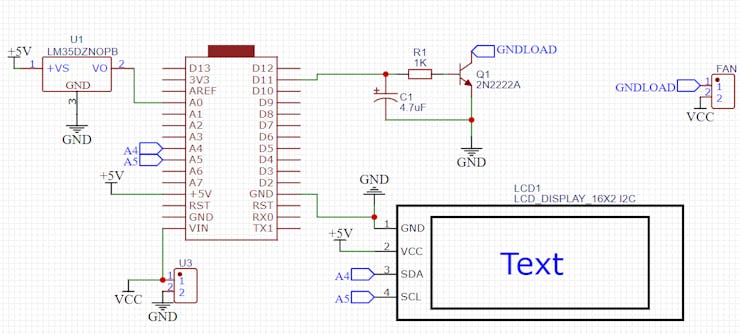

Circuit diagram:
You can find 2 circuit diagrams here, because most of the students don’t want to use 12c protocol with this. So in the first circuit you can find direct connection of screen with Arduino. The program can be downloaded from here.
The second one is the modified schematics, which use 4 wire 12C protocol to display values on the screen. This will reduce the overall connection and a better method to make a communication between microcontroller and screen.

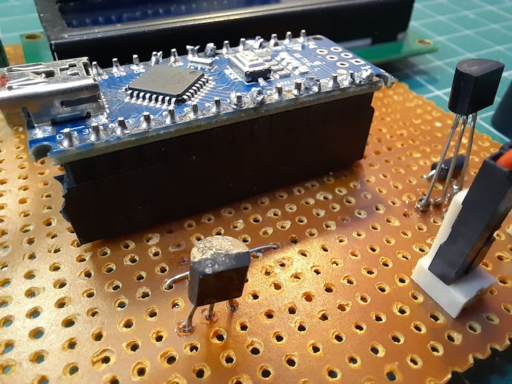

Here in the circuit, fan speed is controlled using 2n2222 transistor. You can also use dedicated motor controllers but this project is designed according to the consuming current of a CPU fan. From the D11 pin of the Arduino a PWM signal through a 1k resistor is given to base of the switching transistor.

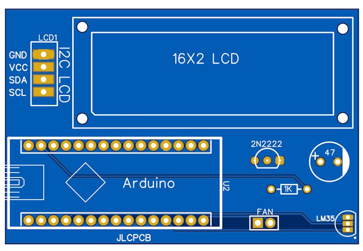

PCB designs:
According to the modified circuit I made this schematic and fi you wan to use the same designs then get them from here.
