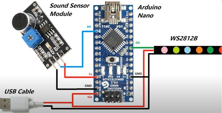

Circuit diagram:
The analog value of sound detected by the sensor goes to ADC of the Arduino. Then according to the volume the brightness and the effect of neopixel is controlled. On every up and down in bass, treble change the effect of RGB. But we have to tune the sound sensor very precisely and I am using a 100k external potentiometer here. But I recommend to use a multiturn version. A 9volt battery is enough to power up whole the system.

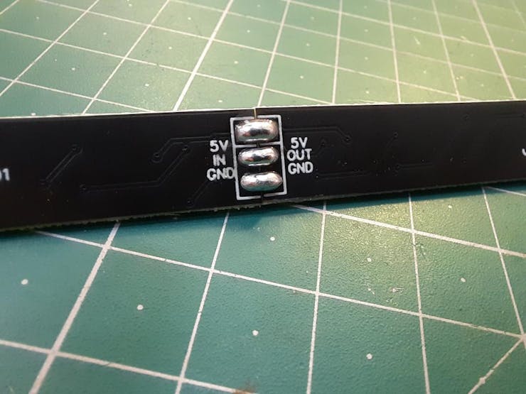

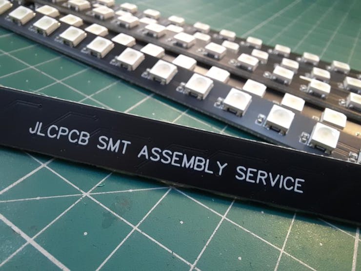

I made this WS2812 LED stripe using JLCPCB SMT assembly service and you can download all the required files directly from here. All the power connections are done in parallel and a small 100ohms resistor is placed as current limiter. All the data connection are done in series.
You can join multiple RGB stripes together to make a bigger one. There are 15 LEDs in one stripe, you have to modify the code line according to the number of neopixels used.
