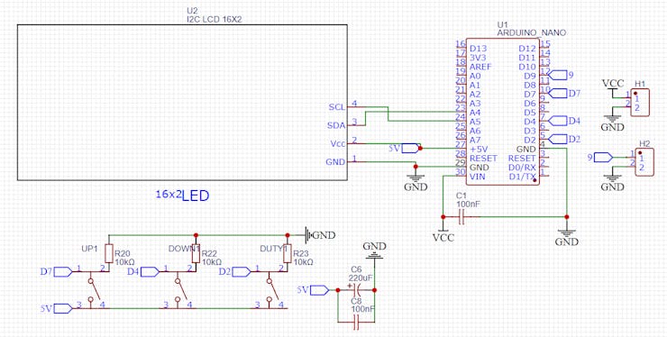

Circuit diagram:
You can find two different codes below, one for the OLED display and other one for the 16x2. The circuit diagram and connection details of both circuits are shared below. Both the screens work on a I2C address which is controlled by Arduino and a 4-wire interface is set between Arduino and screen. So the circuit remains the same just change the screen and code respected to it.
Arduino – Screen interface
A4 - SDA
A5 – SCL
5V – VCC
GND - GND
The push buttons are used to change the frequency Up-down and the duty cycle of the square wave. These resistors are pulled down using 10k resistor and activated when got 5v signal.
D7 – frequency up
D4 – frequency down
D2 – duty cycle
A 220uf capacitor is required between the power pins to reduce the power supply irregularities. Digital pin 9 is used for PWM square wave output.

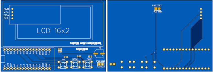

Gerber files:
I designed the Gerber files for 16x2 LCD because it is widely available and has a pretty good viewing angles. Just plug the Arduino and Screen in the PCB shield after soldering the SMD resistors and tactile buttons.
You can download the Gerber files from here. Upload the Gerber files on JLCPCB and get your 5 piece of 2–8-layer PCB in just $2. JLCPCB is the leading PCB manufacturer from China and dealing in PCB prototyping, SMT assembly, Stencil making, 3D printing, Full PCBA and high precision PCB making.

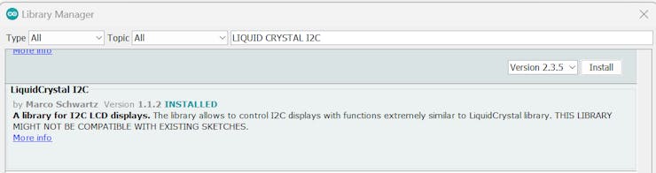

This code works with 16x2 LCD and Arduino UNO. You can download the required libraries directly from Arduino IDE library manager section under tools menu. Code for OLED display is given below or you can download all the required materials from here.

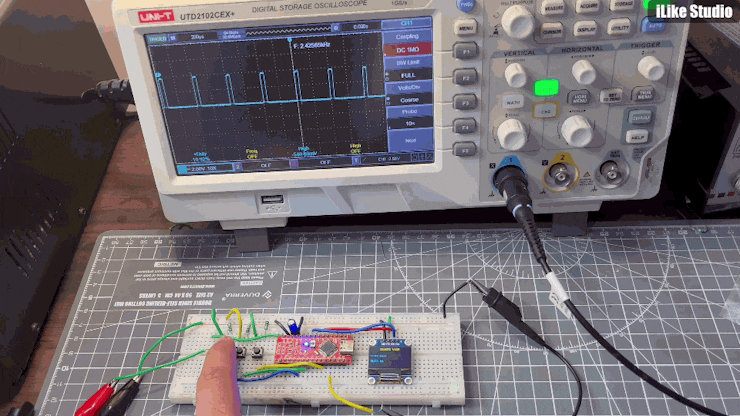

Working and testing:
During first test the Arduino is shutting down again and again, but an electrolytic capacitor between the power lines can do the job. The hardware and software is now stable and you can use this type of PCB project as a lab bench square wave PWM generator. You can find a battery connector at the bottom layer of PCB and a 9v battery can be connected directly there.
Frequency Increase:
Frequency Decrease:
Duty cycle change:
Because the output only switches between 1 and 0 so can be named as pulse generator instead of square wave generator. The output is programmable and you can modify the given code as per requirements.
