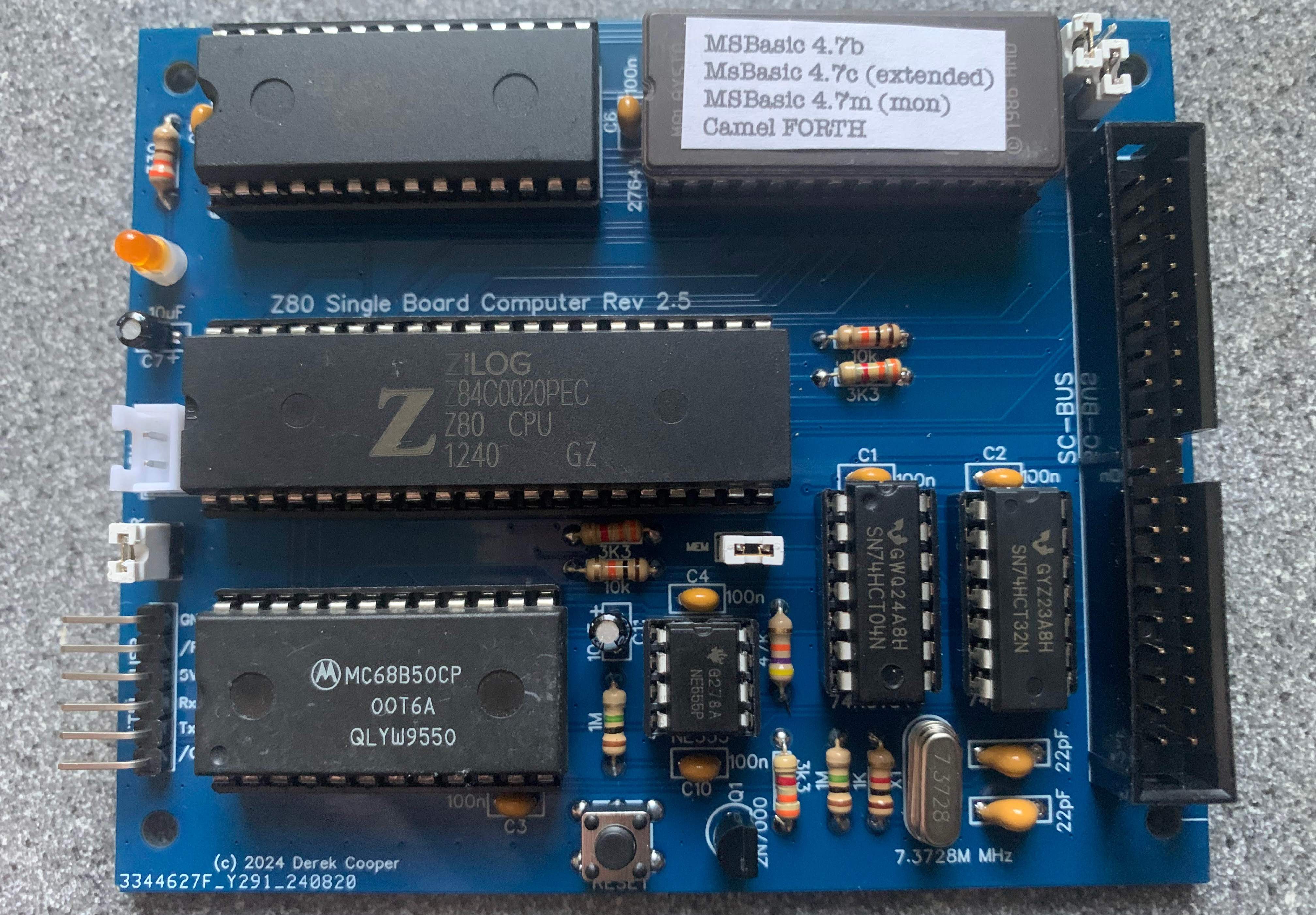

This design is based on a circuit from Grant Searle all credit to him for the initial circuit,  The PCB layout was by me and I I have changed the design to include;
Rom page selection to provide 4x8k blocks. Currently providing 3x MS basic versions and a version of FORTH
Reset on powerup circuit. This holds the CPU in reset for around 1 second on powerup. It also provides an open drain reset for the expansion socket.
The expansion port is now 40pin Scothern Cross compatible
A new jumper to disable onboard memory has been added, for when the expansion provides RAM/ROM
The RTS line is now connected for hardware flow control
An extra power socket.
A ground plane added to reduce cross talk etc.
