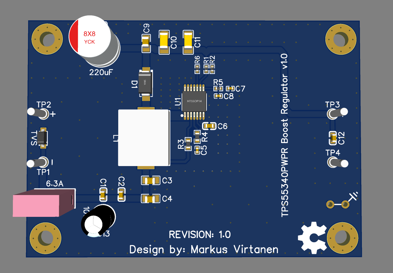

Single-Cell Li-Ion Battery Boost Converter to 5 V
This project implements a DC-DC boost converter that raises the voltage of a single-cell Li-ion battery to a regulated 5 V output. The design is based on the TPS55340 boost regulator, which is well suited for stepping up low input voltages to a higher, stable output with good efficiency.
Operating Principle
  • Input Voltage (VIN):
    A single Li-ion cell with a typical operating voltage range of approximately 3.0 V to 4.2 V.
    The circuit is designed to operate reliably even when the battery voltage approaches its lower discharge limit.
  • Voltage Boosting:
    The TPS55340 controls an internal switching MOSFET and an external inductor, storing energy in the inductor during the on-time and transferring it to the output at a higher voltage level during the off-time.
  • Output Voltage (VOUT):
    A regulated 5 V output, suitable for powering:
    • microcontrollers
    • sensors
    • USB-powered devices
    • other 5 V logic or peripheral circuits
