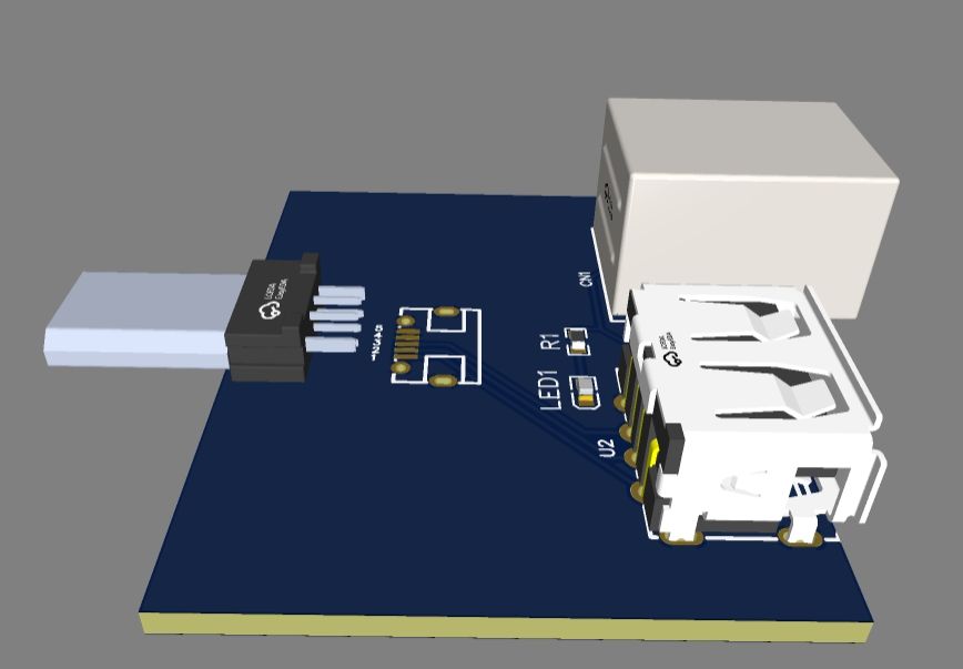

Overview
This module converts the micro-USB-B port of the ESP32-WROOM32 microcontroller to USB-B and USB-A. This adds conveniency to use the device with the USB-B cables (this one is generally shipped with Arduino microcontrollers) and USB-A cables.
Note
  • The microUSB-B male connector needs to be manually soldered according to the pin specifications.
  • DO NOT use both the USB-B and USB-A connectors at the same time because of the risk of cross-communication as there is no USB controllers used.
