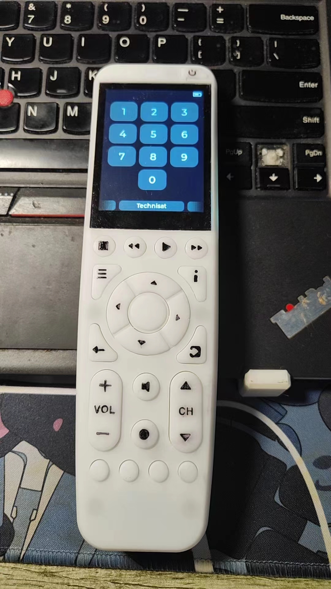

Project Description
The ultimate goal of this project is probably a universal remote control with a touch screen that can be customized, but unfortunately the current UI interface infrared code is written to death, if there is a big guy interested in joining the development.
Open-source protocol
Project-related features
  • LVGL draws a beautiful UI that can touch the screen.
  • Modifiable IR code (modify source code)

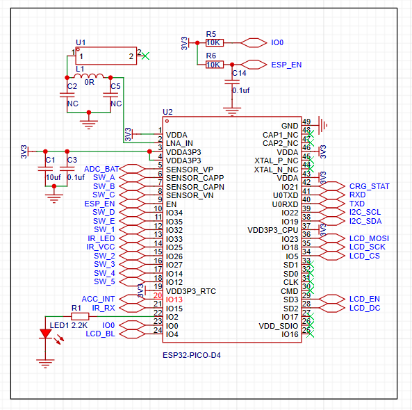

Design Principles
  • Master control.
With the ESP32-PICO-D4, the peripheral circuitry is very simple. The disadvantage is that it is difficult to weld.

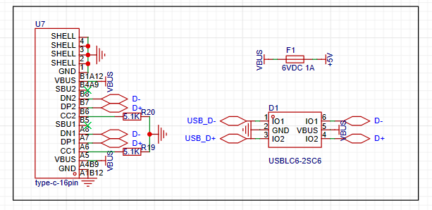

  • Interface.
It adopts a type-C interface and is equipped with a resettable safety and ESD protection device.

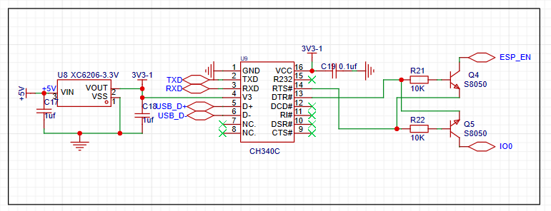

  • USB to TTL and auto-download circuit.
CH340C is used as the serial port to USB chip, and SC6206 supplies power to it separately to avoid leakage when using battery power.

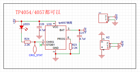

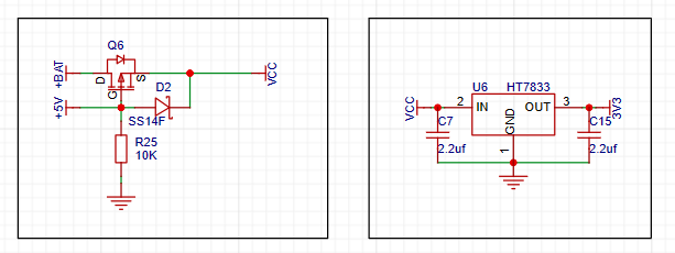

  • Power supply.
The TP4054/4057 is used to charge the lithium battery, and the CHRG pin is connected to an IO of the ESP32 to determine whether to plug in the power supply.
Later, the combination of the classic P-MOS+ diode is used as a switching circuit for USB direct power supply and battery power supply.
The LDO uses the HT7833 with a quiescent current as low as 1ua to power the subsequent power IC, and the capacitance here is recommended to increase the capacitance value and then merge a few.

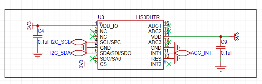

  • Three-axis gyroscope
STMicroelectronics' LIS3DHTR for the pick-and-wake function of the remote control.

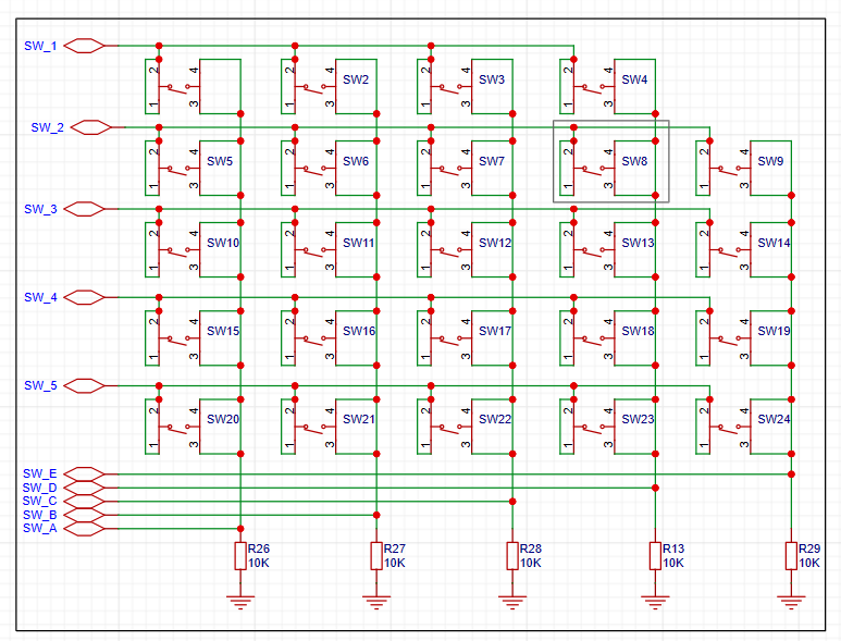

  • Button
The buttons are matrix scanned.

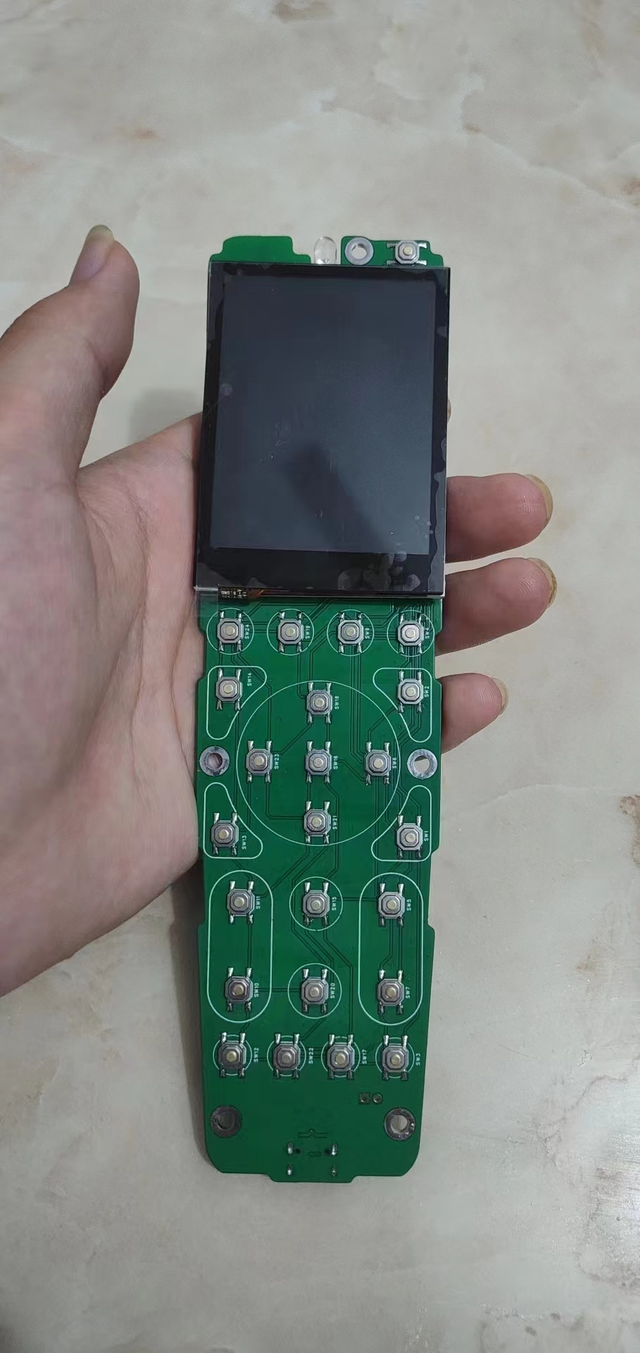

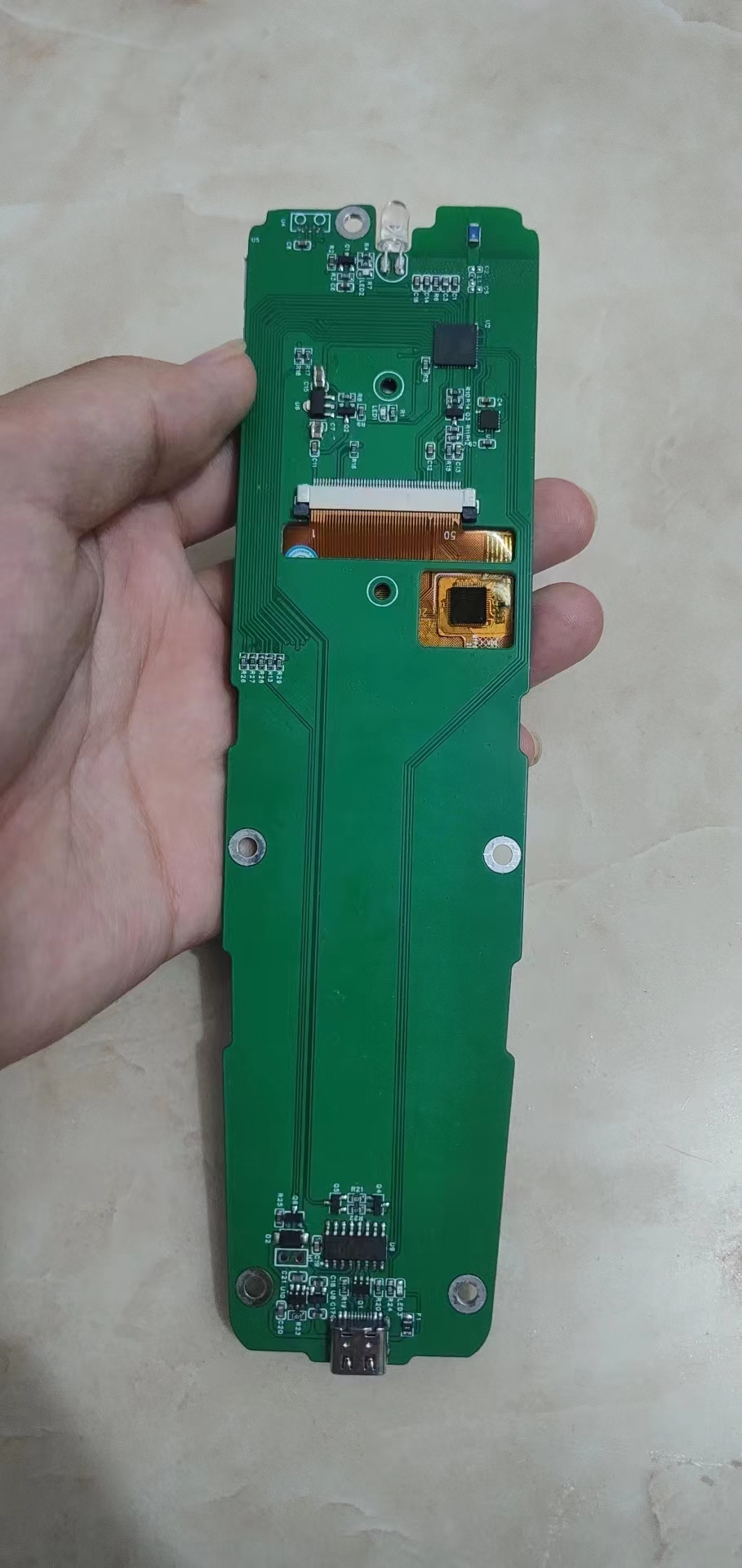

Physical display
Design considerations
ESP32-PICO-D4 is more difficult to weld, so it is recommended to use a heating plate to complete the welding (it is better to open a stencil). Here's how:
  1. Apply an excessive amount of solder paste on the pads around the perimeter, and the middle pads must be less pictures.
  2. Put on the chips and heat.
  3. Use a soldering iron to drag off any excess tin around.
There's nothing else to say, just normal welding.
