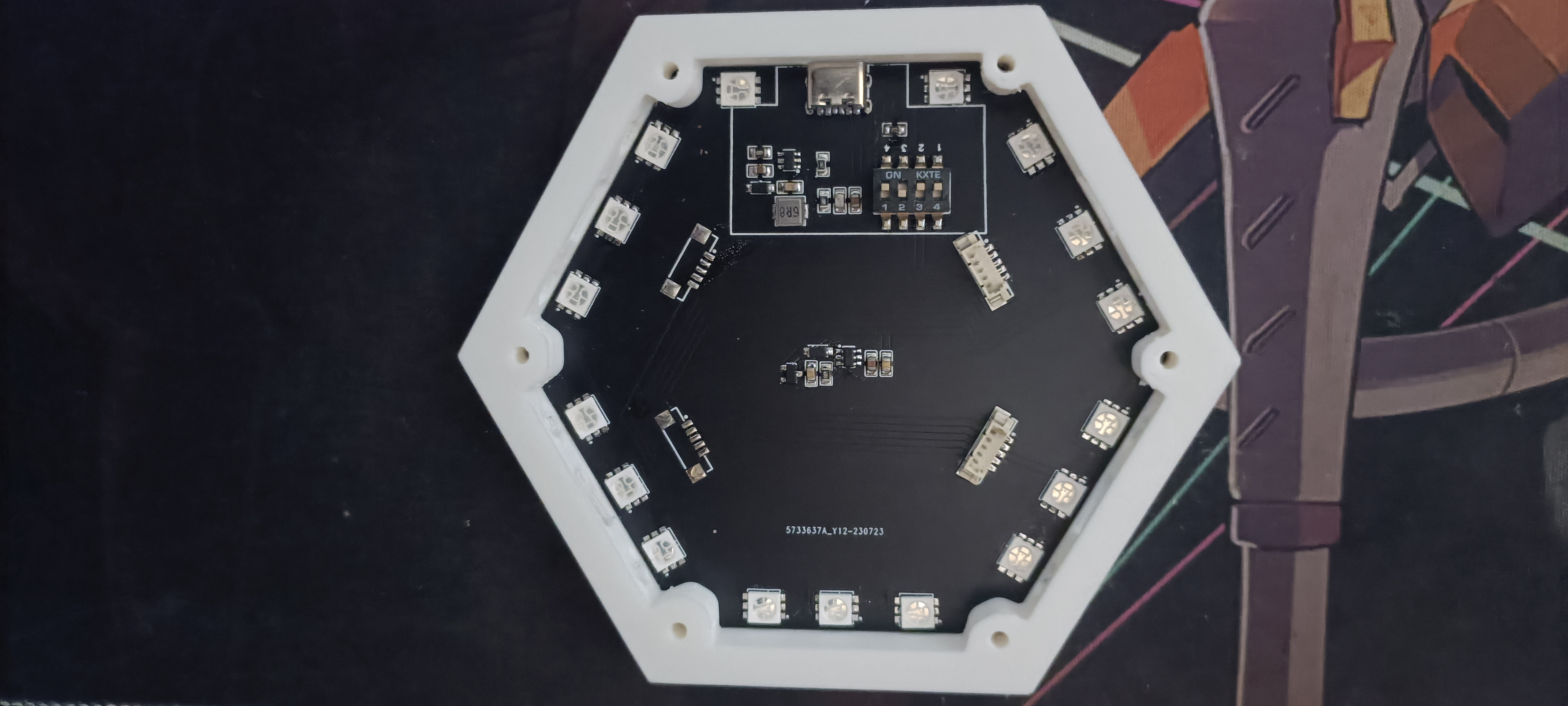

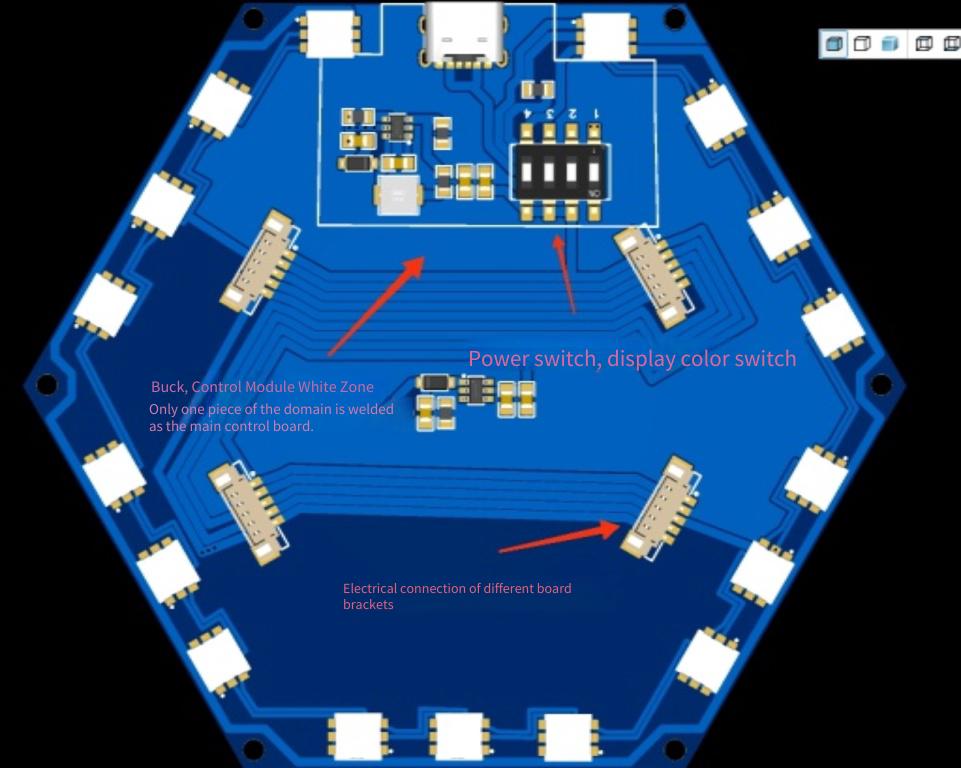

1. In the white area, only the first motherboard is soldered, and the others are not used.
2. Switch 1 is the power switch, switch 2 is the blue light switch, switch 3 is the red light switch, and switch 4 is the green light switch. The three colors can be used in combination.

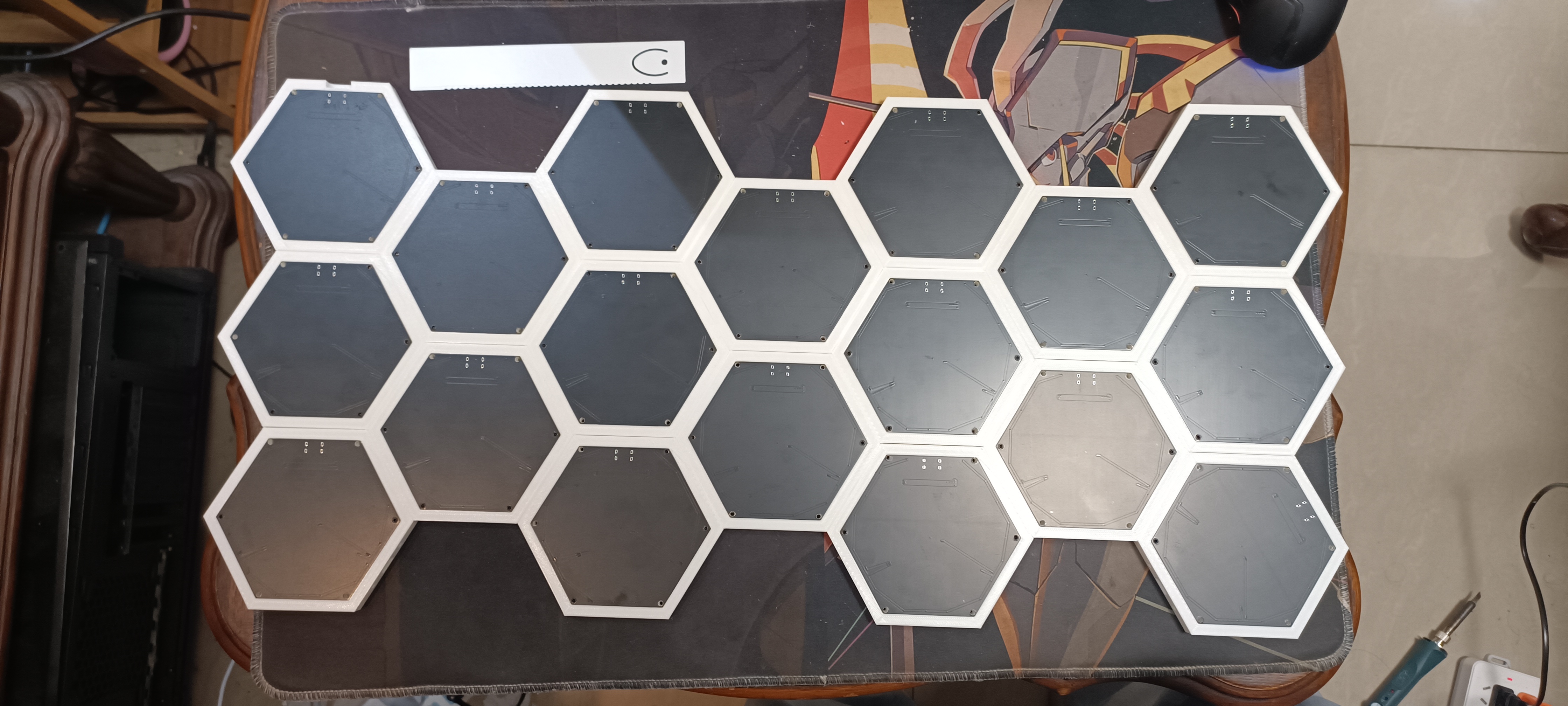

3. PCB needs to be tapped by yourself, M3 (3D printing is also required)
4. There are two 3D model files, one for the main control board and one for other light-emitting modules.
5. The pcb and the model are fixed with M3X5 hexagonal headless screws, and the modules are fixed with M3X10 studs and hexagonal nuts.

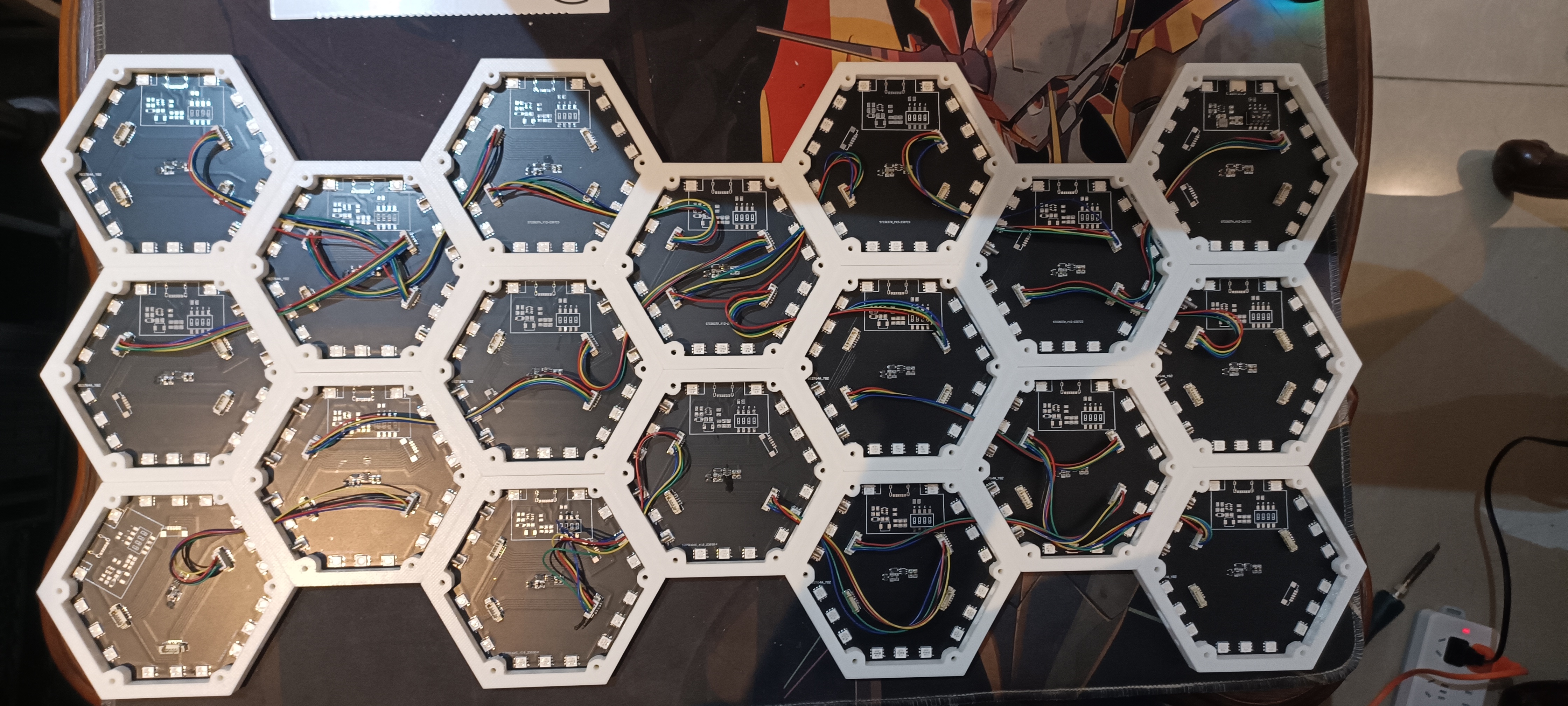

6. The electrical connection between different modules is through 1.25mm spacing and 15cm long 5p connecting wire.
7. The direction of the PCB and the model should be consistent, the charging port and the model notch should be aligned, and then when fixed, the module charging ports should all be placed in the same direction.

9. At present, functions such as delayed extinguishing and light adjustment have been completed, but there is still a problem to be solved. The output power of the buck module is only 2w, which means the more lights are touched.
The brightness of the lamp will be lower (there is no solution yet), and it will not be able to increase the voltage or current power.
