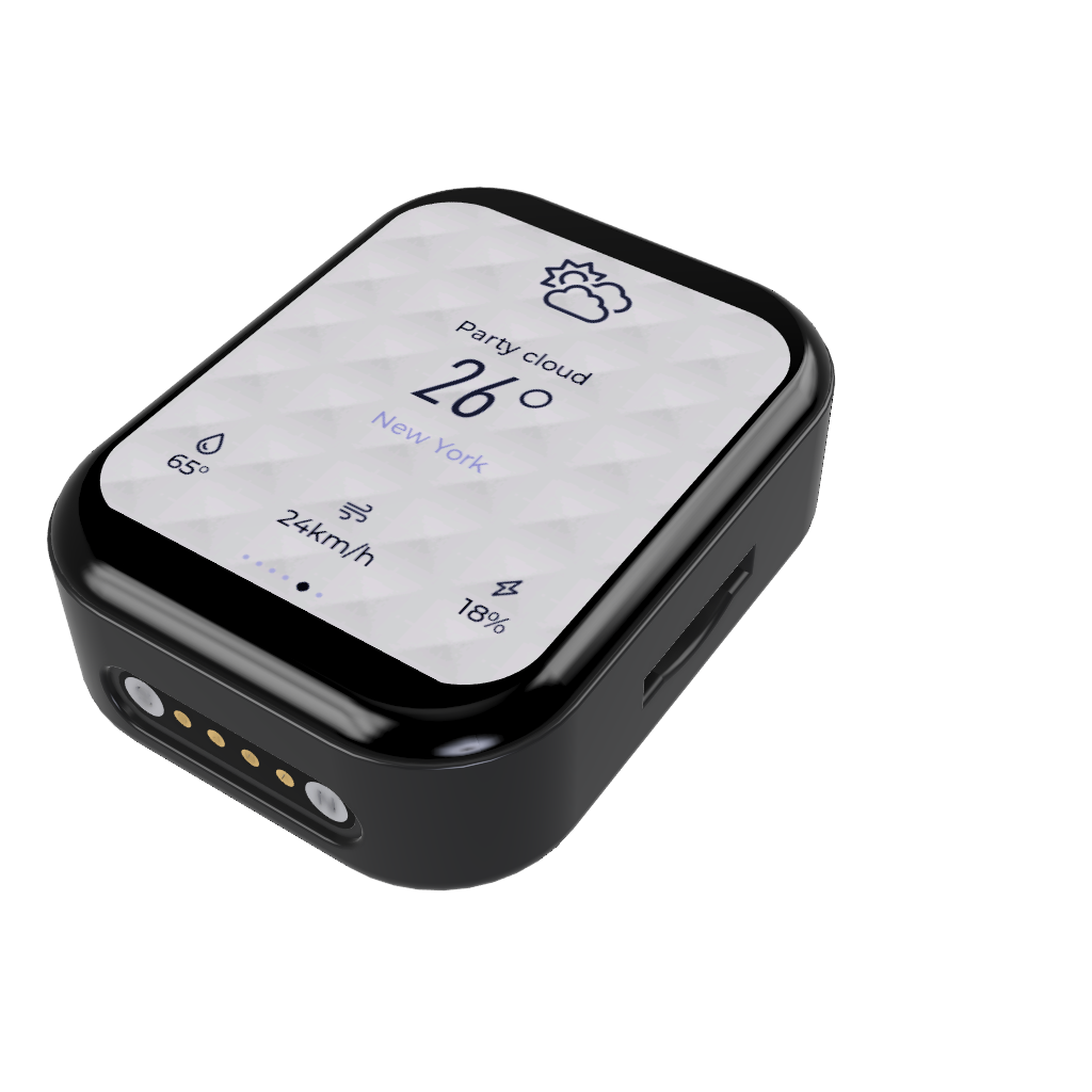

TD3-TouchDisplay3.0
A small charm based on ESP32-S3R8 and 1.89-inch QSPI screen, the experience is silky, and it also supports wireless charging and magnetic interface charging, onboard clock chip, six-axis gyroscope, pressure sensor, passive buzzer, etc., and supports SDMMC memory card file system.
Early Bilibili introductory video
The overall hardware thickness is less than 15mm, including a 300mah lithium battery, through the AXP173 as the power supply principle, through the path selection to switch the magnetic interface and wireless power supply.
The thickness of the board is 1.2mm.
Wireless power delivery
Using Volta's NU1680 solution, it supports unlimited charging of up to 5W, basically the charging current will not exceed 1A through the charging speed limit of AXP173, and the peripheral components of 1680 have requirements for the material, it is recommended to refer to the manual to select the resistance and capacitance of the corresponding material.
Power management
Using the old scheme AXP173 chip, many students who have copied it say that this piece of custom voltage is too much to buy, and it can be modified into my open source single-cell lithium battery charging and discharging scheme, and you only need to write one more ADC acquisition scheme.

Display screen
It is used in Huaxia Cai's 1.89-inch QSPI screen,The price is a little expensive, and there is no replacement for the current level,The most expensive hardware in the whole project is this screen,The IC of the screen is GC9B71Just this driver is in the IDF routine,Migration is very convenient,At the same time, it is also a routine with touch,The chip is also consistent,I don't want to use the code I provide to develop,You can try to migrate yourself.
Magnetically powered
The reason for choosing magnetic power supply is that it is very convenient to do the base design, and the model of the two components of magnetic power supply has been built, you can ask me if you need it.
Development configuration
1. Based on the 'ESP-IDF5.1.2' version, the IDF version may be replaced in the future.
2. 'lvgl' version is '8.3.11', may be upgraded to '9' in the future.
