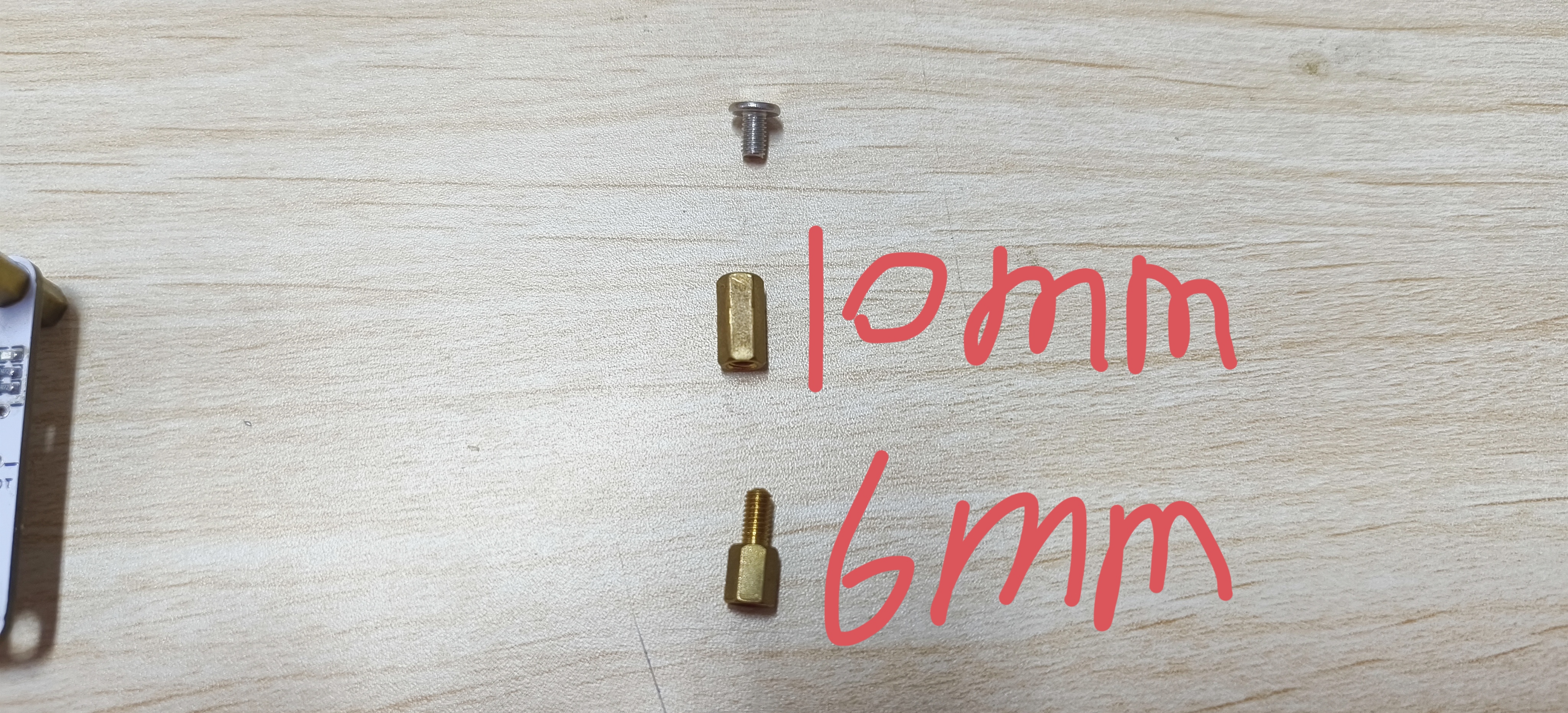

(1) Size of copper pillar

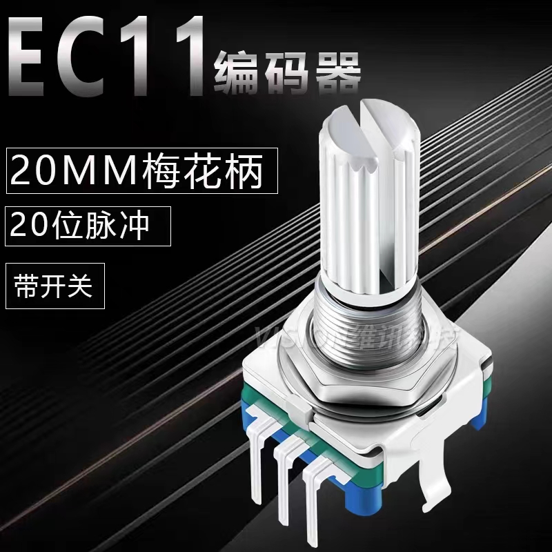

(3) For the EC11 encoder, buy a 20mm plum blossom handle and 20-bit pulse, such as the following.

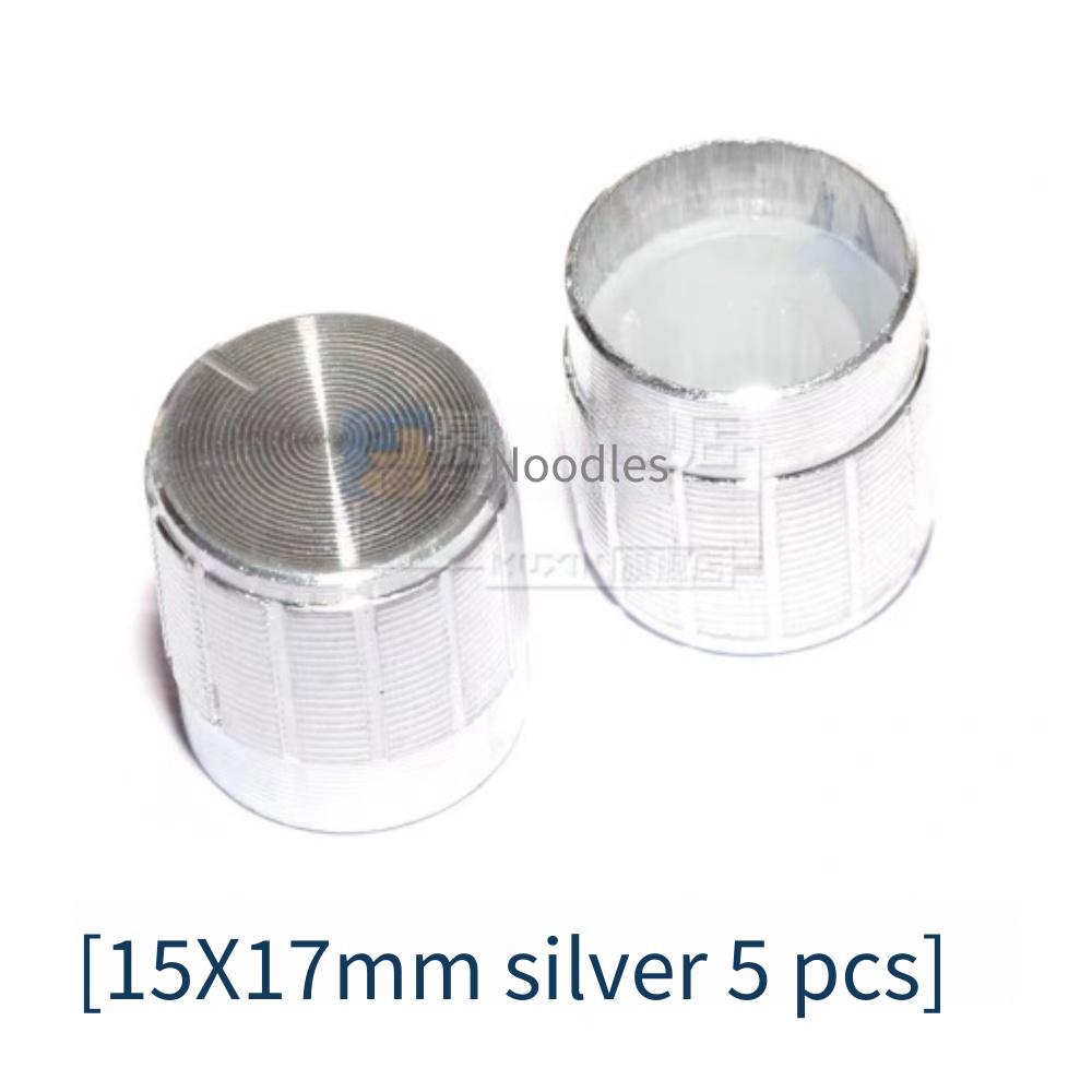

(4) Don't buy the wrong encoder hat. The one below is just right.
