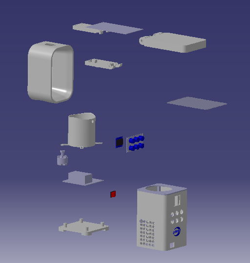

Chapter 2 3D Form Factor Design
The design of electronic products mainly includes three parts: 3D shape design, hardware design and software design, which reflect the relationship between mutual constraints and mutual support. When designing this bladeless fan table lamp product, I first carried out product positioning, and I positioned it as a desktop small bladeless fan with increased power desk lamp.
Good appearance was an important factor in attracting users, and the final choice was made for the rectangular folding shape concept, and then the Catia software was used to design the specific 3D shape. The 3D model and exploded view of this bladeless fan lamp are shown in Figs. 3(a) and 3(b), respectively.
The 3D structure printing parts mainly include the following parts: base, box shell, fan airway shell, fan turbine fan blade, air outlet shell, table lamp shell, etc.

(b) Exploded view of the bladeless fan table lamp
Fig.3 3D model
