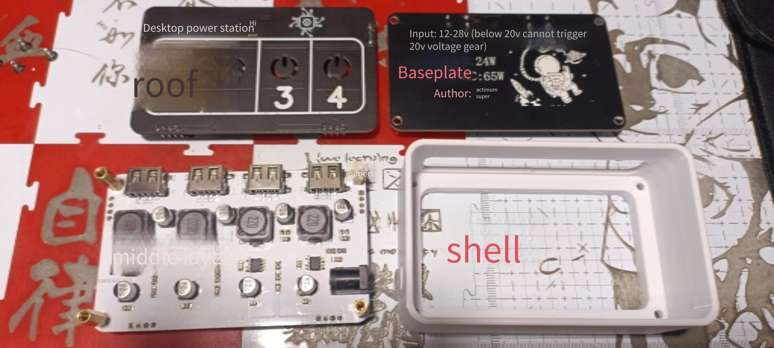

1. The top plate and the middle plate are connected by pin headers, and attention should be paid to the welding direction of one male and one female pin headers.
2. The middle layer and the bottom plate are connected by M3X15 double-way screws, note that the nut is not only responsible for fixing but also the power connection, the nut is electrified, and the upper and lower layers should not be installed or it will burn out.
3. 3 layers of PCB board, the middle layer should be white for touch light reflection, the best effect
4. The color of the lights on the top floor can be selected according to your liking.
5. Touch the top switch area, the light is on to indicate that the corresponding interface has output, and off means that the output is off.
6. The 4 USB-A ports are controlled by the touch switch, and the rear type-c port has an output all the time.
7. With 4 x 24w USB-A controllable ports + 2 x 65w Type-C.
8. You need to bring your own DC power supply power supply voltage of 12V-28V, and the power is selected according to your own needs.
9.3D print the shell file and place it in the attachment.
