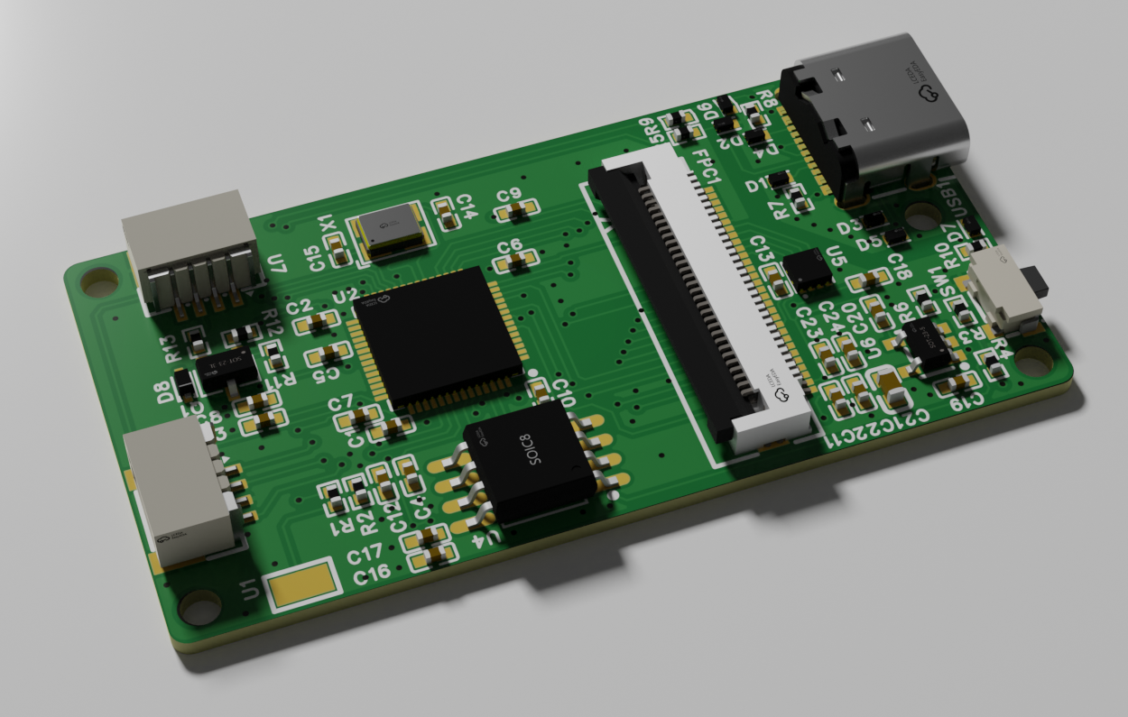

I will put the firmware, host computer program and shell model files in the attachment, and open source the code on github, and the front acrylic panel will be open source along with the project.
How to use the uf2 file of the host computer program: press and hold the only button on the PCB, and then insert the Type-C data cable into the computer, you will find that there is an extra U disk, and then drag the uf2 file into it. After saving, the burning is complete.
Open source address of the Windows host computer program:https://github.com/push-0x57df/computer_performance_monitor
Open source address of the hardware embedded end program:https://github.com/push-0x57df/computer_performance_monitor_rp_2040
