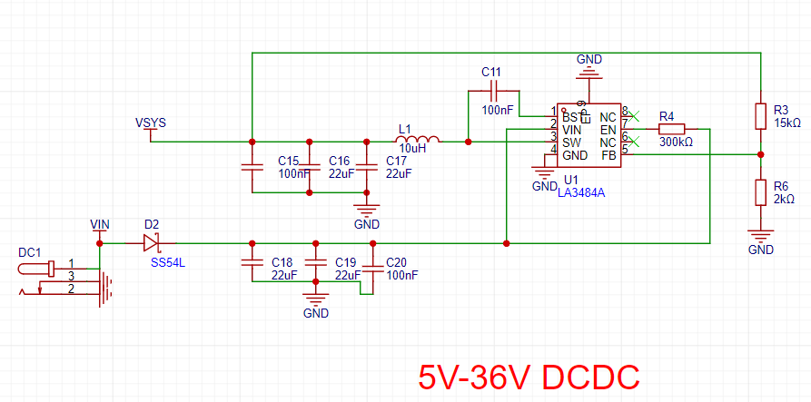

1. Introduction
Color silk screen development board small board made with PICO2040.
The board comes with four small halo lights from the game development department.
2. Schematic
The schematic diagram is the most basic system.
GPIO0, 10, 16, and 25 are drawn into the halo light.
The back beads are reversed patches.
Pink, emerald green, blue-white, orange.
DCDC uses domestic fine art LA3484.
LDO is a domestic Weimob 6211.
