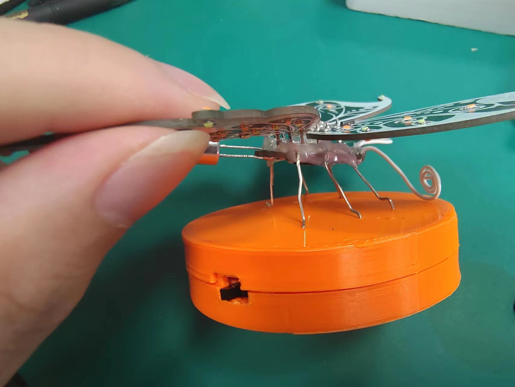

Assembly process:
1. After getting the board, you need to cut the wings and body with diagonal pliers!
2. Then solder all the components separately first, and then pay attention! Burn the program to the baseplate first! Because if you don't have a burning pen, it will be very troublesome to burn the flying line!
3. Then weld the wings on and lead out the power cable.
(1) If you use a willow frame to hang it, you need to draw out the power cords on both sides.
(2) To use the disc, you need to cut 6 LED pins, which are used as butterfly pins and power supply pins!

I am using a normal No. 7 battery, and then the power is boosted by SX1308! fixed with hot melt glue;
Precautions for installation
The pin header needs to be angled welded! Then before soldering to the motherboard, you need to cut off the header a little at an angle, so that the butterfly will be tilted and curled to look better!
If you need to use the scaffold I designed, you need to pay attention, there are some things to change, and the modeling technology is not very good, you need to change it manually.
Wicker frame bracket:
1. After the bracket is printed, use a hard wire to bend it! Then it is scalded into the bracket, fixed with hot melt glue, and then connected to the power cord inside! Introducing the baseplate!
The opening position is shown in the picture!
2. How to fix it with hot melt adhesive, leave a switch hole, you can use it or connect the wire directly!
Disc model (in attachment):
Burn the welded butterfly feet into the bottom plate, and then fix the welded power supply line with hot melt adhesive!
Then plug in the power cord and you're done:
